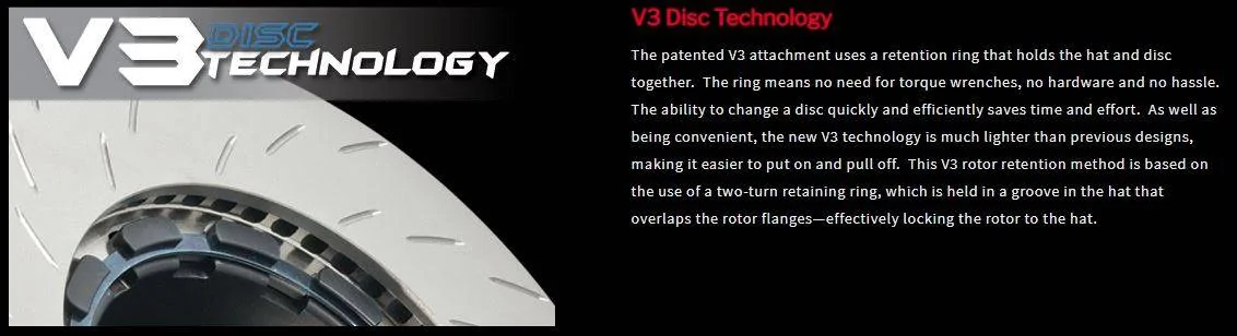

These will utilize PFC's Patented V3 ZeroFailures Floating Rotor System.
PFC utilizes the same race proven metallurgy and design from their Indy Car Motorsports Program. These 330MM Directional 48 Vane Slotted Rotors are built under strict requirements in PFC's own US Facility .
The patented V3 attachment uses a retention ring that holds the hat and disc together. The ring means no need for torque wrenches, no hardware and no hassle. The ability to change a disc quickly and efficiently saves time and effort. As well as being convenient, the new V3 technology is much lighter than previous designs, making it easier to put on and pull off. This V3 rotor retention method is based on the use of a two-turn retaining ring, which is held in a groove in the hat that overlaps the rotor flanges—effectively locking the rotor to the hat.
