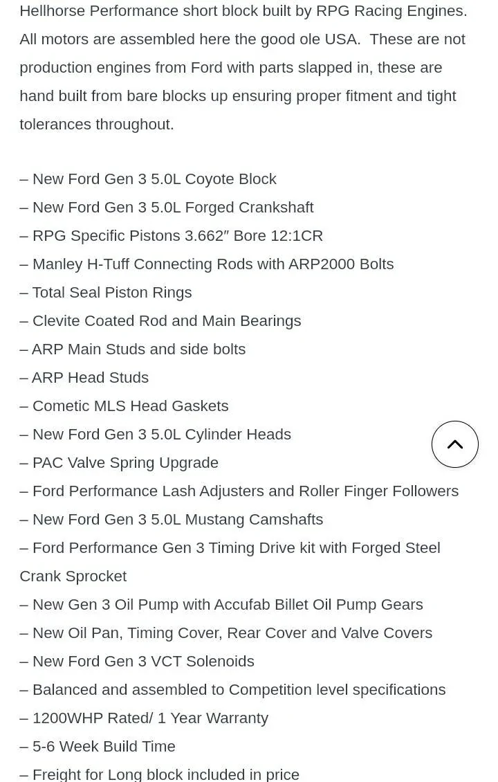

So I have a 2020 10 speed. I have in the garage already the following
gen 5 whipple 3L stage 2 , griptech 6 rib 3.00 pulley , MFP crank support
Id1050x
Fore return fuel system with dual 465 pumps and dual regulators
My goal is to be between 950-1050WHP
Will I be okay with this long block from RPG? And should I get the heads ported ?

That's just a stock GT engine like he has now.
Yea looking at the specs of the aluminator vs RPG long block. The RPG is a much better purchase.. all I wanted to know if I would be fine with the long block from RPG pushing 1k to the wheels and if porting the heads would be worth the extra $$

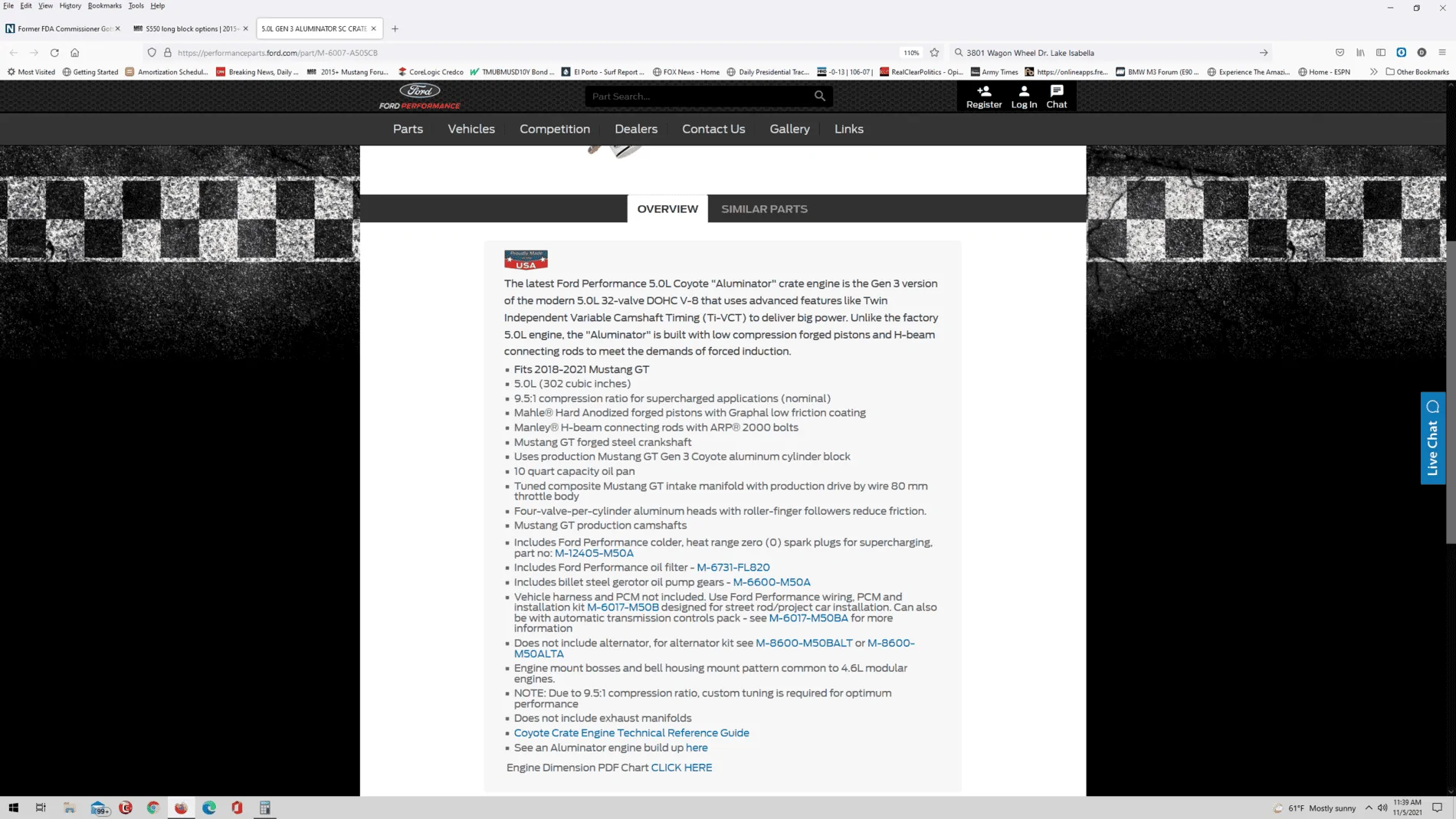

The link is fixed now. It pointed to a Regular GT crate engine before, now it goes to the Aluminator page.

Guys its not just a stock long block. Read the specs. 9.5:1 compression also. Mahle Forged coated pistons, Manley Rods. You guys didn't read the specs.
Comes with a 2yr. warranty
Im sure RPG makes great motors...
Still not up to par as the RPG... Has much more better internals than the aluminator

The link went to the regular gen3 5.0 & GT500 crate engine page before. It points correctly now.

Both only come with Manley H beams, but RPG level 3 gives you Oliver rods.

I saw the price for the blower shortblock is $10,500 not bad. The Ford Racing long block can be had for around $12,500.
The long block for RPG was almost $20k....not sure if its that much better.

The long block in the picture i posted is 14k which is their stage 2 ... 1200whp capable longblock and for another 1500 I can have the heads ported

Both engines would be comfortable at 1000whp. You can build your own aluminator with all new parts for under 4K
