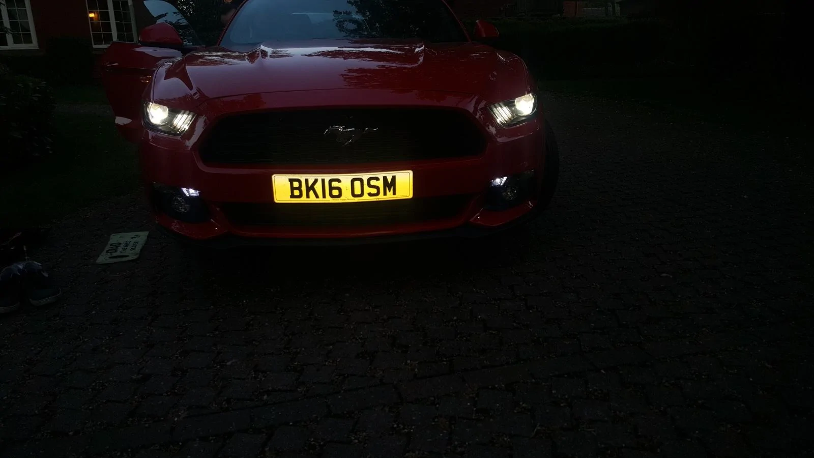

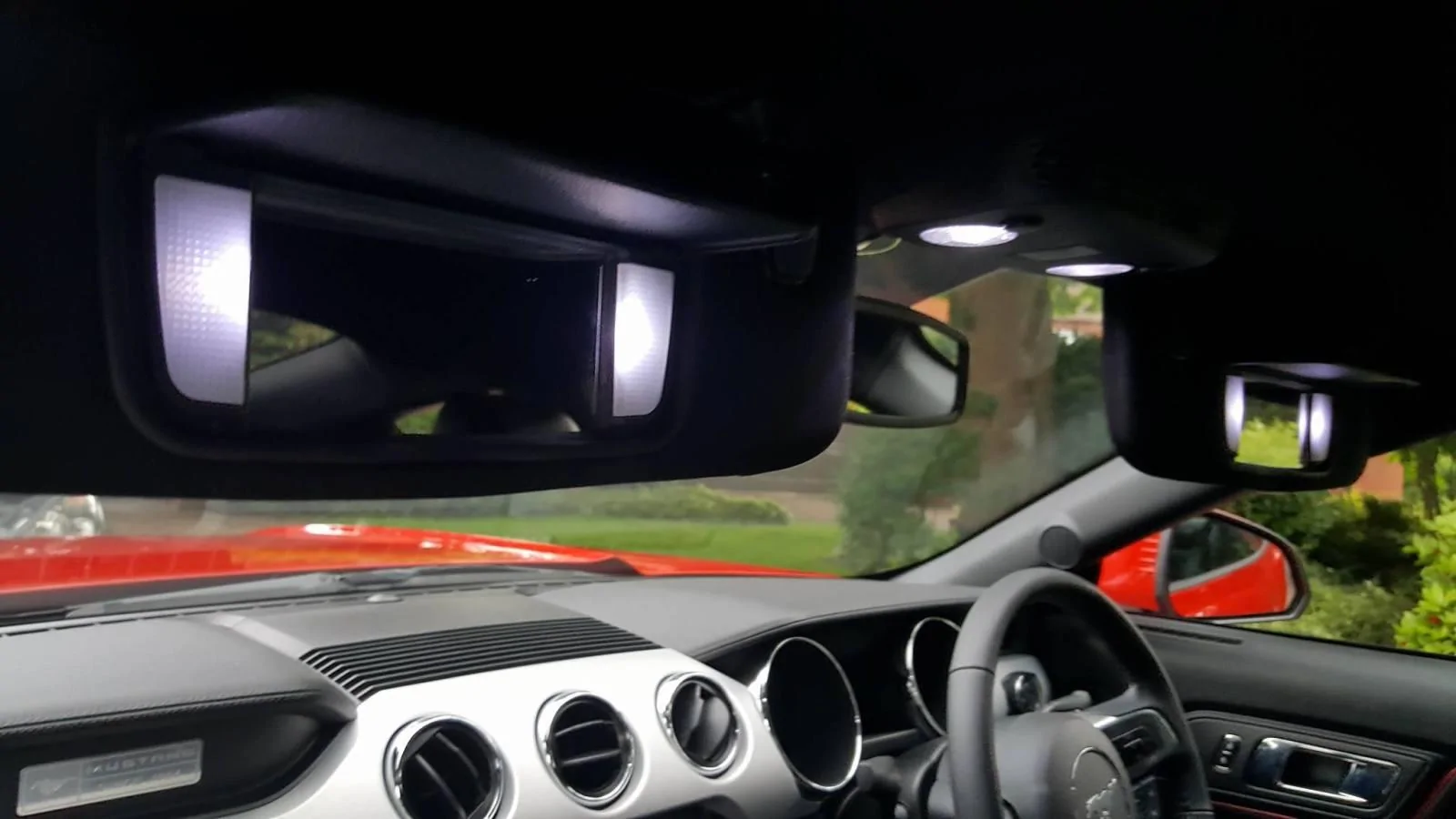

Hey All,
As there's been plenty of questions as to what Bulbs are required where within the car, and what fit etc, below i'll list my lights that i've used within my car and all fit.
What will be required is:
2x P13W (Only on the link provided, haven't found elsewhere other than Konik in the AUS) for DRL
6x T10 - 2x Maplights, 1x Boot Light, 1x Glovebox light, 2x Reversing light. These will all have to be 3 LED, however the reversing light can be 6 LED.
2x T10 Canbus free must be 6LED, 10 LED is too big - Sidelights
And to fit:
Tweezers for interior lights
Flathead screwdriver (Very small) for interior lights.
Screwdriver Cross head
Lube/Vaseline for the Sidelights/DRL
Possibly a file (sidelight/DRL can be a bit tough to fit back in)
List of the lights:
Exterior DRL (pack of 2) P13W Bulbs: -
https://proledlights.nl/p13w-25w-high-power.html
Interior Map lights, Trunk Light Glove Box (4 req't) T10 bulb-
http://www.ebay.co.uk/itm/501-T10-W...ash=item43dc2d7fb9:m:mKkHnJa_BgE-kWtNg0qIqEw-
For the Trunk Lights BEFORE removing the actual light bulb, remove the housing from the connector.
(Can buy a set of 10 to have spares, as will need 2 more for the reversing lights!) - NOTE THESE WONT FIT THE SIDELIGHTS.
Interior Vanity Mirror Lights (4 Req't) T5 Bulb-
http://www.ebay.co.uk/itm/320915404801?_trksid=p2057872.m2749.l2649&ssPageName=STRK:MEBIDX:IT (Set of 10 so have spares!!)
Sidelight LED (2 Req't) must be 6 LED, 10 LED is too big!! T10 CANBUS free bulb -
http://www.ebay.co.uk/itm/301907694...49&var=600715468894&ssPageName=STRK:MEBIDX:IT
Reverse Lights (2 Req't) Same as map/trunk/glove box lights -
If you do blow the fuse you will need a 10AMP micro Mini 2 red fuse. Which is here:
(ALT/MICRO2-10 10A FUSE)
http://www.altecautomotive.co.uk/micro2-fuse-by-littelfuse-4513-p.asp
Switchback (Europe) for full sidelight/indicator to be LED:
http://www.mustang6g.com/forums/showthread.php?t=58917
(Thanks @UNtamed67 )
Hope this helps you all when planning your LED mods!
