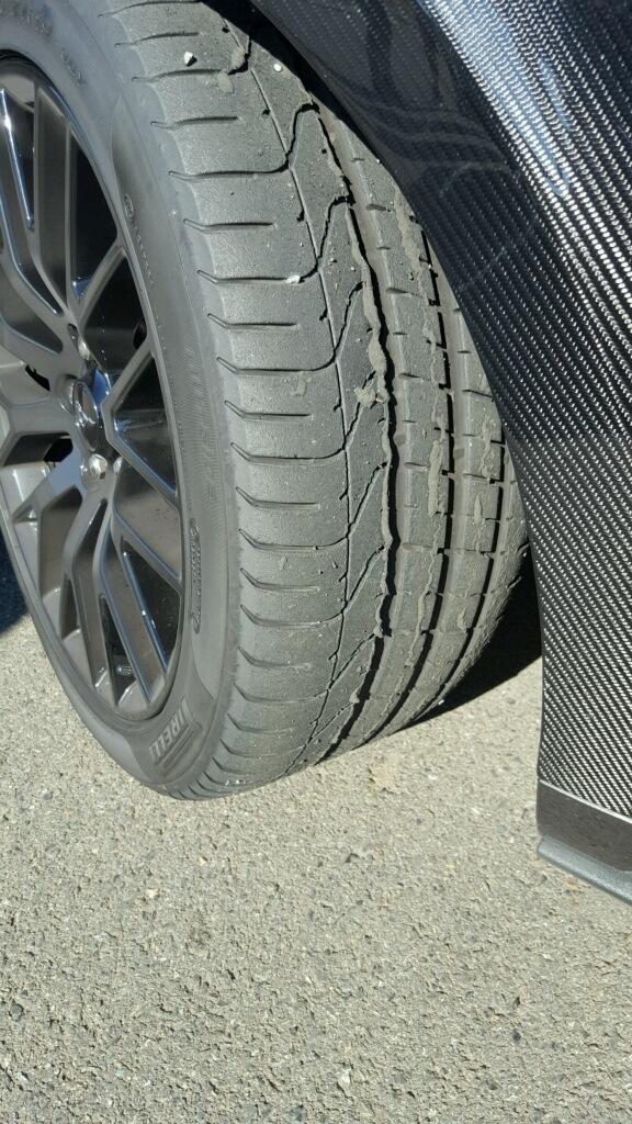

I've had the phase 2 Supercharger Kit from Roush since January.
I do not drag race the car. If you intend to the upgrades would include Ford Racing Half Shafts $1,400(you will likely snap the stock ones) and the Hop Not IRS package from Steeda with sticky tires. The PZeros are useless on the drag strip with that much power.
I DO use the car on the road course quite a bit. Make sure you opt for the GT performance Package to get among other things the Brembo front brakes, larger radiator, rear diff cooler and 3:73 rear gear. The Pirelli PZero summer tires are "ok" for the street but lack grip when you are on track... I'll post a photo of them. Steeda progressive springs helped a lot as well as the sway bar kit. You lose the strut tower brace when you install the supercharger so lowering the center of gravity and reducing body roll will help. I also found the Toe on the alignment was way off on my car so make sure the alignment is right shortly after you get the car. Make sure someone close to your weight sits in the driver seat when they dial in the camber, caster and toe so its correct when you are driving.
Hope this is a start for you. I converted from an SRT Challenger and this is WAY more car, especially for the money.
