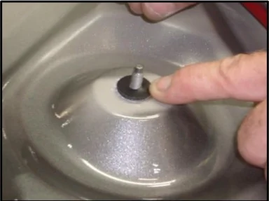

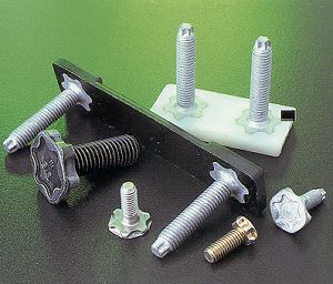

Sorry. I didn't make it really clear what broke. Just the plastic areas around the studs. The head of the stud is a Plastorx head that is molded into the plastic. The plastic around the head of the Plastorx broke off just slightly larger than the head.
I spoke with my local body shop today and they mentioned that it could be fixed by using longer studs that have a washer on the end, putting it in the hole, then filling the hole with epoxy. He said the epoxy would lock the washer in, so it wouldn't be able to pull out again.
The broken area is about the size of the black washer in this pic of the stud. If you remove the black washer, you'll see the Plastorx head molded into the plastic, like the light colored studs in the upper photo.
