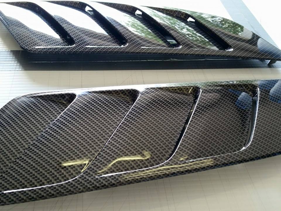

Just got a pic from my hydrographics guy of my vents. Can't wait to pick them up this evening.

Those look really nice. I change my mind every day between hydrodip, paint, or leaving them raw. Hope we get to see them when they're on.

Is hydrodip only pattern type? I'm looking for a solid color.
Hydrographics are pretty much any pattern or color. The most common is carbon fiber, but if you look at Lethal Performance's car you see skull patterns, in different colors, or other people that have gotten flames etc.
If you are looking for a single color you could just have a bodyshop paint them with auto paint and clear coat.

In the video it looked like they had a lot of texture to them. However it looks like the hydrodip is VERY smooth. I would want mine painted body color so I'm wondering how much prep it would take before painting them. What do you guys think?
They do have some texture to them. I brought mine to a local body shop recently, and the guy told me that the paint might not come out right on them because of it. He said that there was some sort of special glue they could put on it to make the paint stick, or they could try to sand the texture down. I'll wait until the car comes in and see how the raw plastic looks on it. If I don't like it, I'll bring them back to the shop and try my luck.
