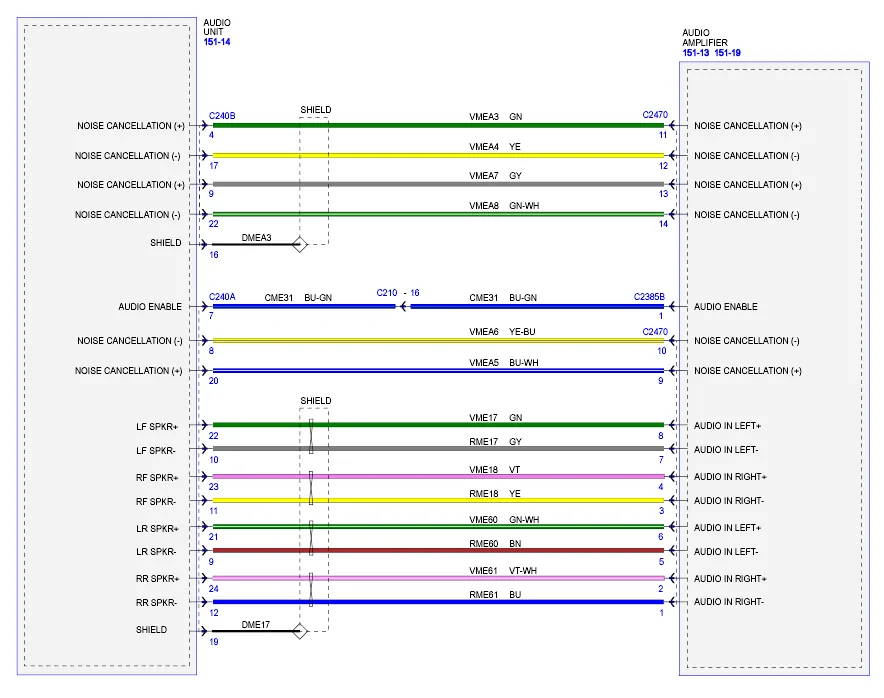

I read though the forums and see that people are using fuse 23 to hook up the remote wire for an amp. How in the hell do I attach a wire to fuse 23? Sorry for the dumb question.

just grab the blue/white wire thats in the same harness as the rear speakers. Thats what i did... its a ign 12+

So you are using the BLU/WHT (noise cancellation) wire as the remote connection?

Also, to those smarter than me at this sort of thing. I assume that I can unplug the male harness going into the amp, then solder the female C2470 pins 1-8 for the RCA out to my new amp. If pin 9 is what is working for the remote, then I can solder a remote wire to pin 9. Do I need to do anything iwth the Audio Enable wire (pin 1 of c240A going into the amp?

Will the blue/white wire near the right rear speaker allow the sub to turn on when you press the radio power button? I'm using fuse 23 right now, but the amp will only power on if I turn on ACC (push the start button).

It won't. When I turn my car off now the radio doesn't stay on like it used to, which is ok.
