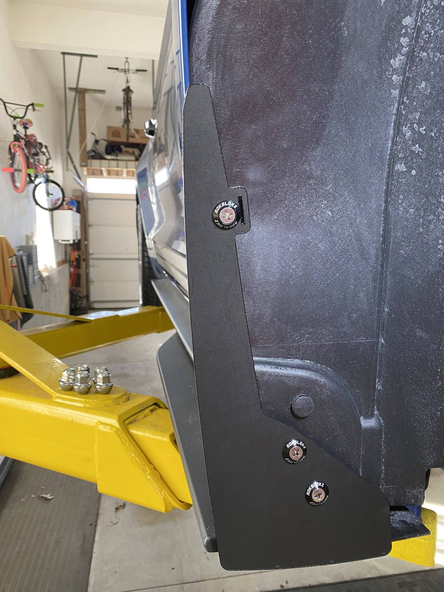

Packing up for vacation today, I put my car on the 4 post lift and though this picture showed just how well the upper mount I added forms the flap to the shape of the wheel well.
Hoping the "skin-ter-net" is sufficient in Aruba to check in every now and again :sun::beer:

Again, thanks for the photo, Jaime and obviously it's a good time to leave Boston for Aruba. <smile> Been there many times in my former life so I know you'll enjoy yourselves if this is your first time.
So, if you see this before departure, have a blast and don't worry about the SplInternet until you get back home.
PS. But when you get back, tell me more about the chingasso you fabricated for the upper attachment.
PS Edit: I have the BL-7000EXT coming along with Steeda rails and their heavier-duty trunk lid shocks. Picked up four Torin Big Red jack stands, an OBDLink MX, and the 350 RokBlokz. So I'm on schedule with my usual OCD routine. <grin>

Sure thing KB, check out the link to my build thread that I included so you can see exactly what I purchased and how I did it if you get bored. I will walk you through what I did over the phone, or email if you would like.
