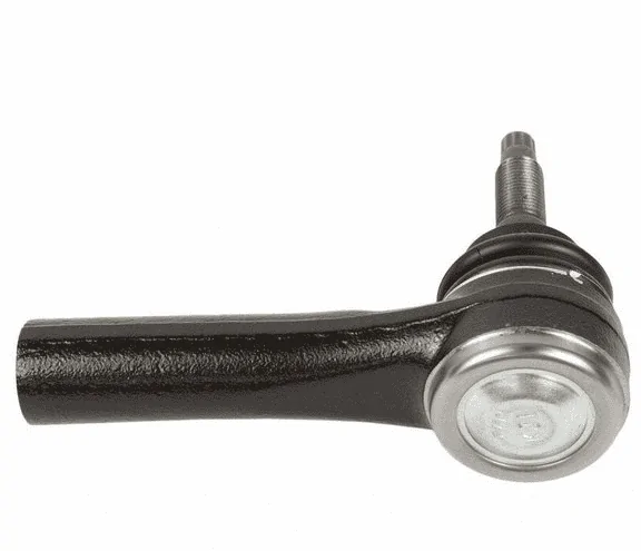

I've just changed it but jumping tyre is still going... I've changed:
Tie Rod End -
Control Arm -
and tyre still jumping... If i ride it is ok... Jumping tyre is the most horrible if i for example parking... or etc... slow drive with full turned left....
