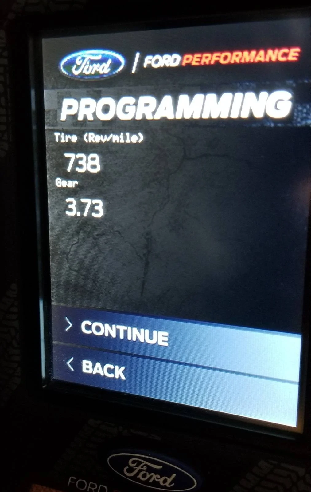

My guess is it's going to be close to 739.
Let me see if I can get my Procal hooked up tonight to get an OEM PP1 reading for you. I need to change my tire size too. I changed to 325/30R19 in the back.

Reading of OEM PP1 revs per mile. I was 1 rev off with my guesstimate.

This is when I noticed that despite the fact that the PP1 19'' setup has a lower theoritical diameter than the OEM 18'' , the revs per mile is lower. Maybe because the tire is less deformed in real life ?? I guess some folks at Ford did the test for real :-)
