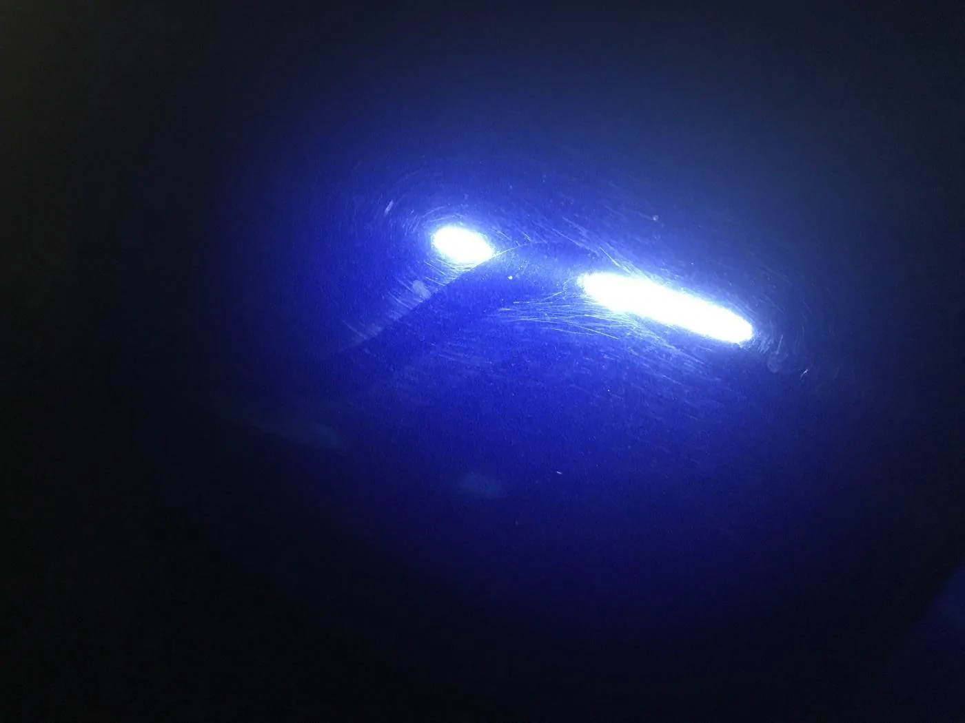

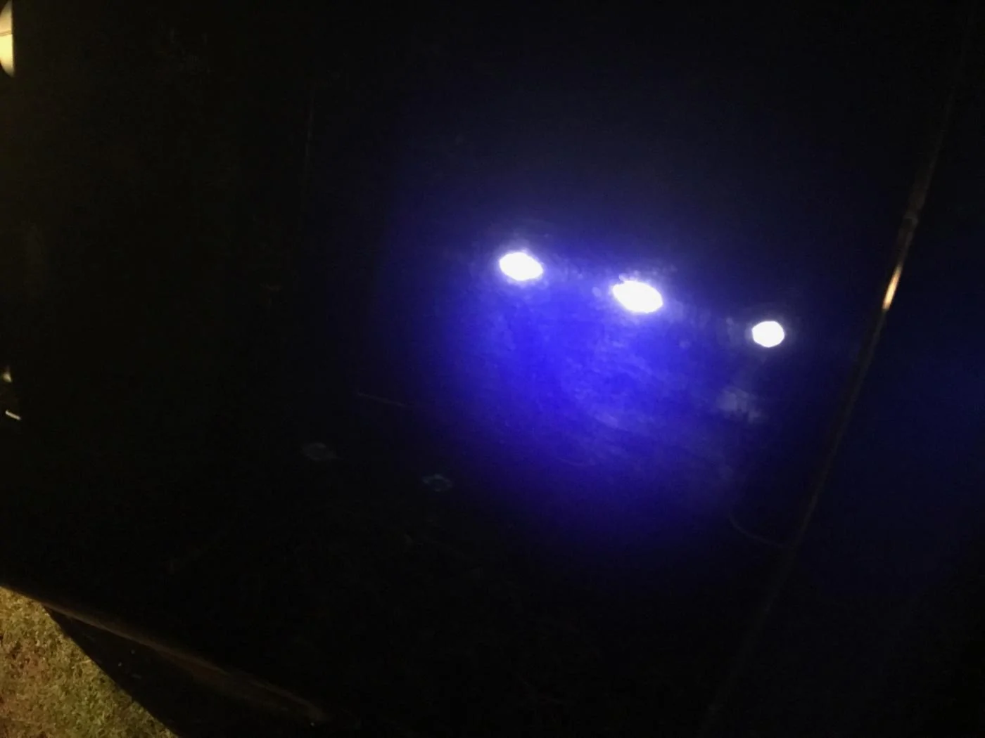

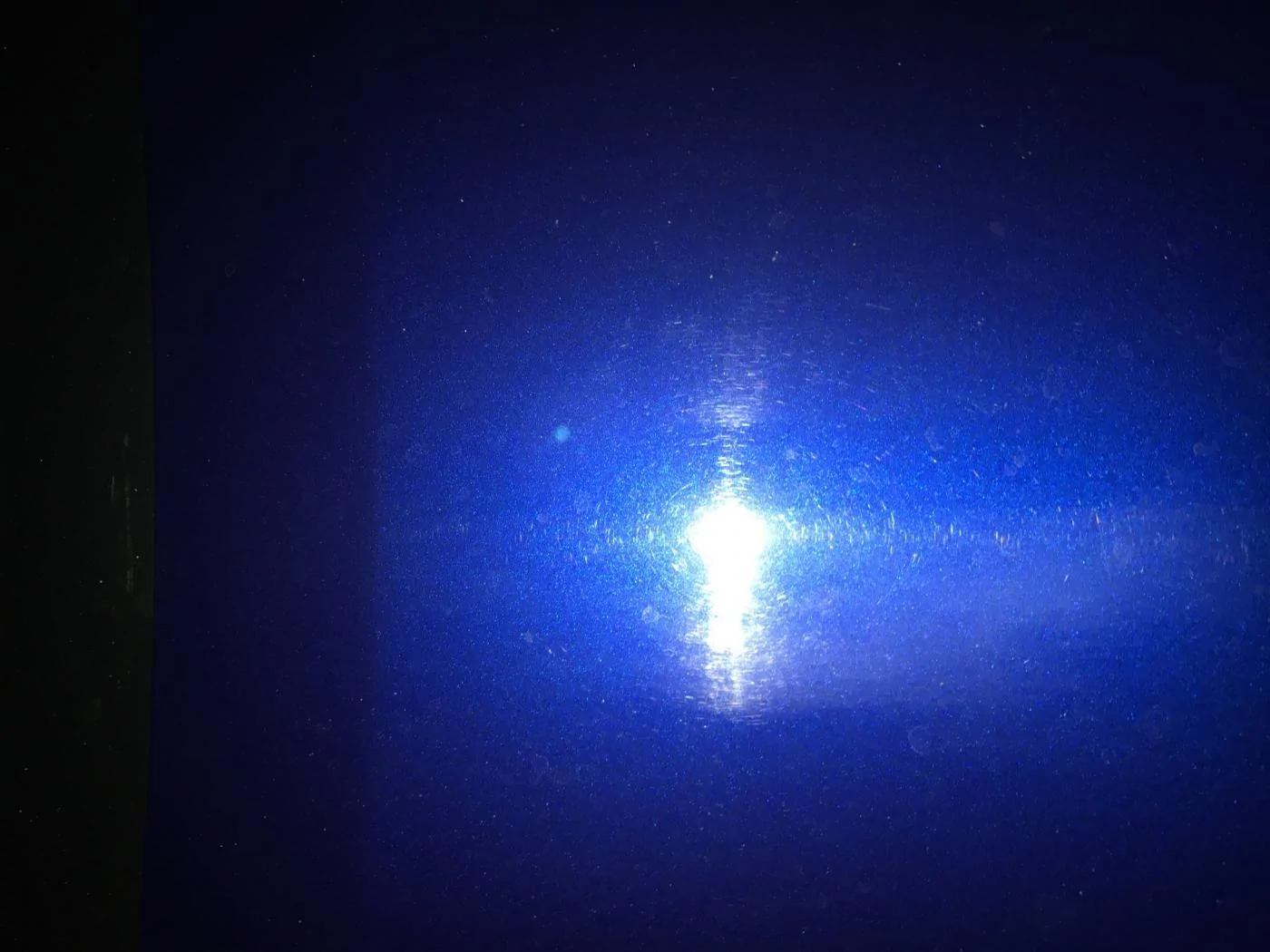

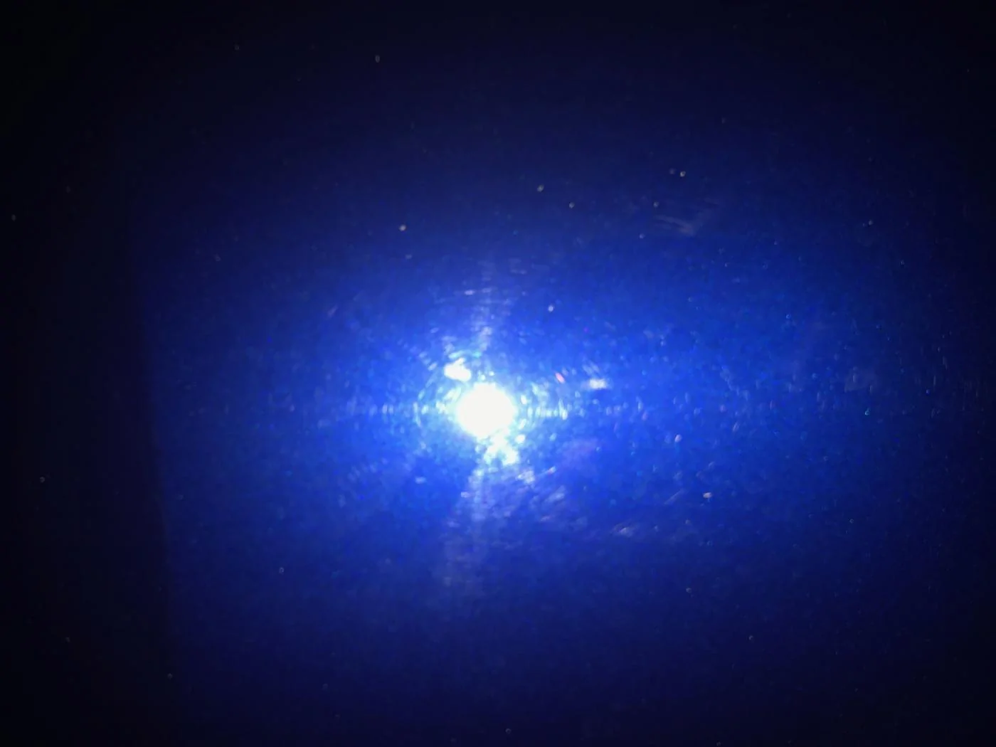

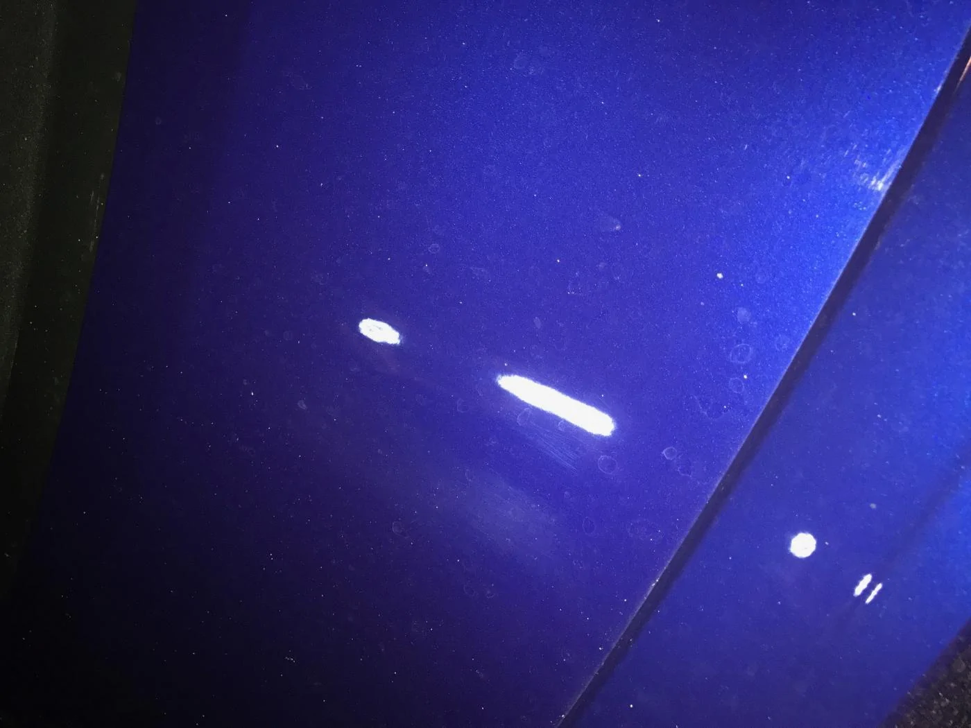

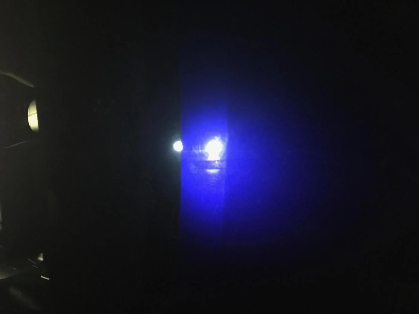

I had stripes all the way from front to back and decided to remove the roof, trunk and rear bumper portion of it(will remove all when I decide which black stripes to go with). Though I have noticed that there is a ghosting effect left from the stripes on the trunk of the car. Which is werid to me as the roof and rear bumper didn't have problems. There is also scratches from having to remove the horrible adhesive from the stripes(Pics below but for some reason came out sidesways uploading) .Can anyone recommend a product or a video that would be simple but VERY affective at removing both. I saw some Maguires scratch removal products at a local Walmart but I am also willing to buy a product online if needed(nothing wallet killing).

Get u a good da polisher and use a correcting polish and then a finishing polish and your paint will look better then it did when it was new.I just did mine,i will upload a few close ups of the paint.Its not hard to do just takes some time.I use adams products and pads,use quailty stuff.

Yes, I got a Griots Dual Action polisher years ago. Recently PatrickGT recommended Menzurna 3800 polish. It's a miracle polish! Got rid of all scratches, swirls and minor clear coat rock chips ( blended the chips not gone completely but hard to see. I then CQuartz'd entire car. Check out my video.
