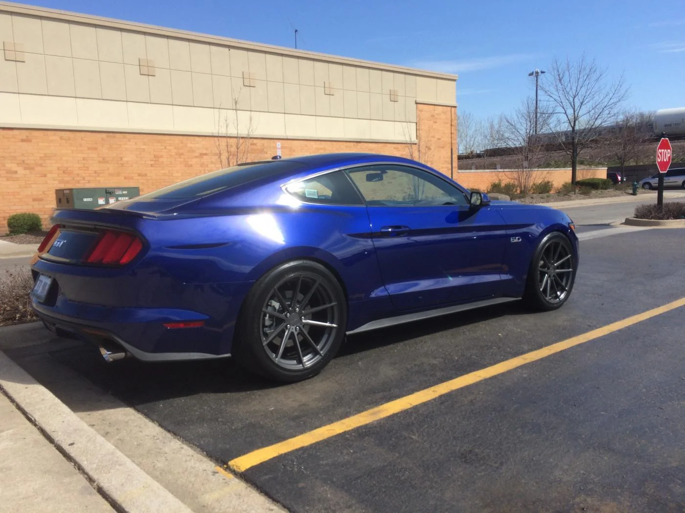

Here is my setup in the rear i used to have. 315/35/20 Toyo Proxes 4 plus. Toyo's run a little bit more narrow
