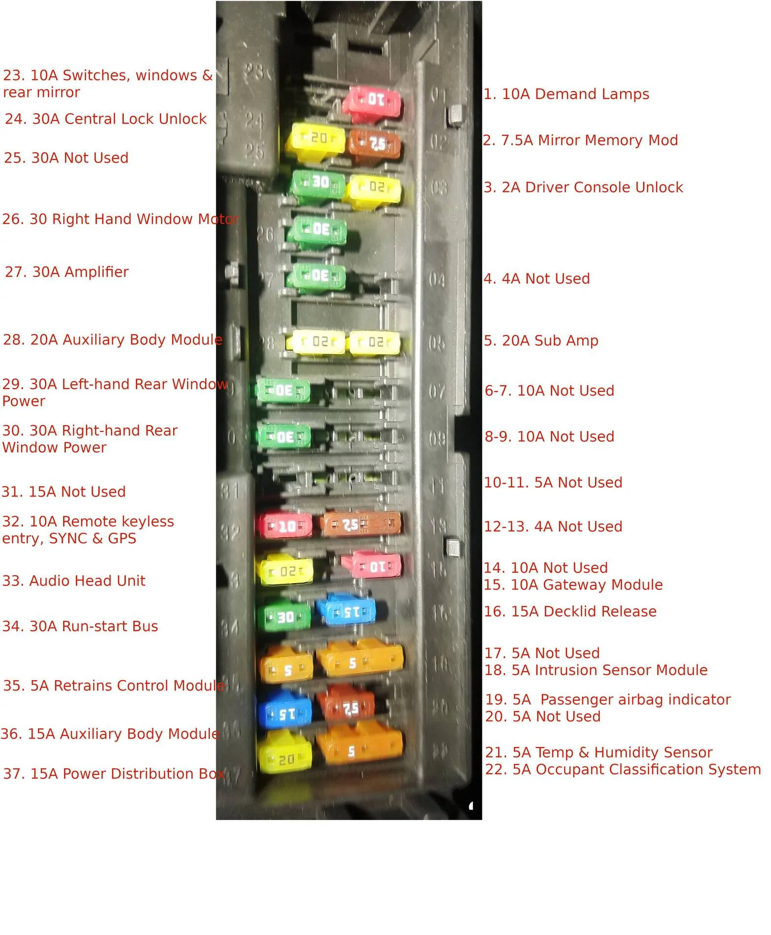

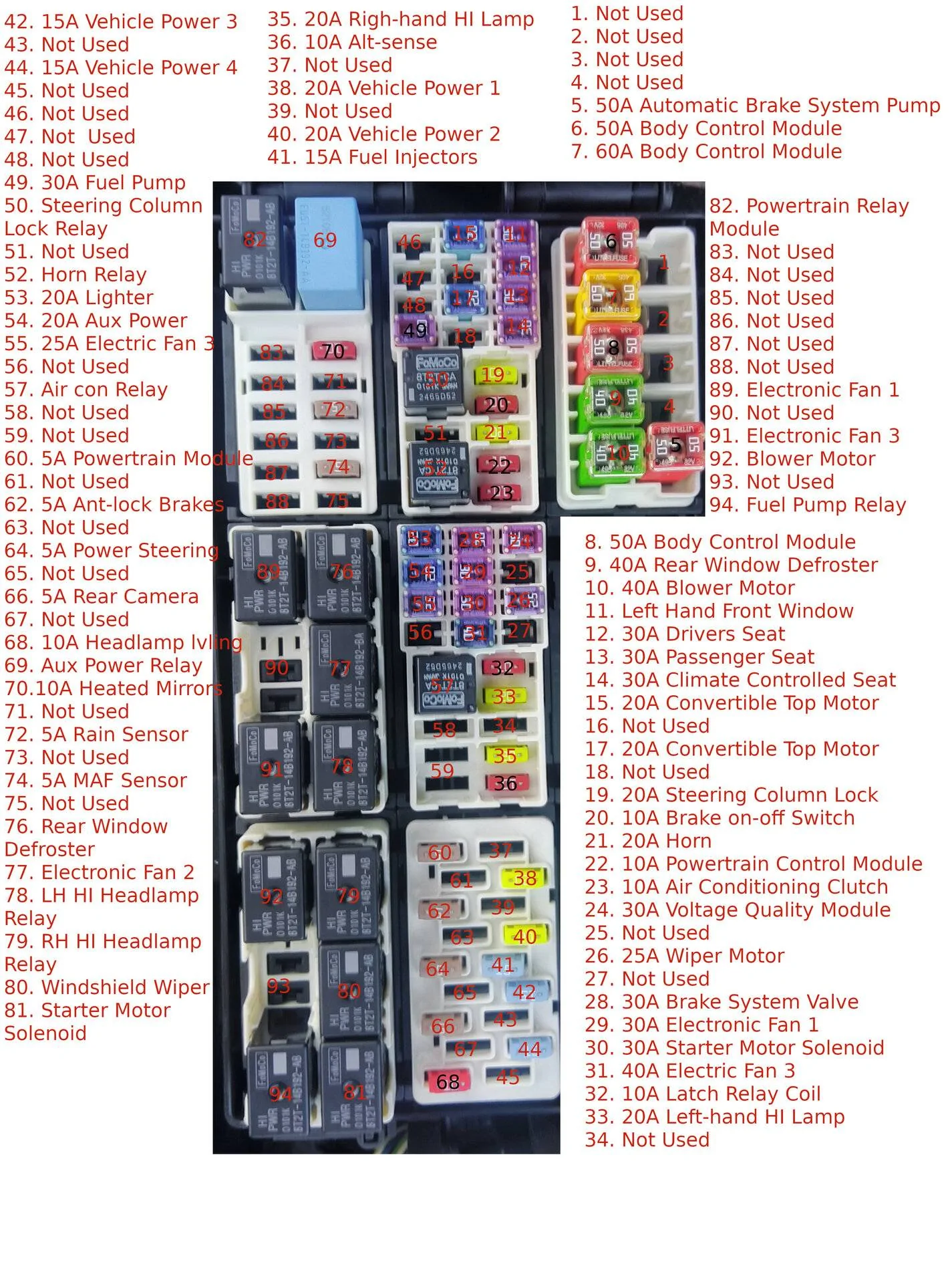

I have a 2017 Mustang Convertible (6500miles) and as the car is not used in the winter.Today its on the road and the rear HEATED SCREEN isn't working so checked the relay thats clicking when its pull it out and back in the dash light is on so is there a fuse somewhere as well checked the handbook unable to find a location of one so is there a fuse? .Thanks

Many Thanks for that Graham, I shall keep it for reference.The fuse seems OK took it out put back in now will wait for the morning dew !! anything else it could it be?Aidan
Earth connection? Have you a voltmeter or test lamp to check continuity?
