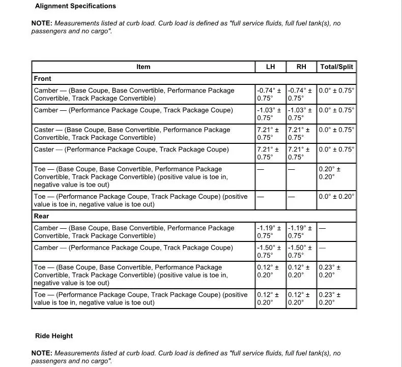

So I had somewhat recently installed the BMR 082/089 spring combo and I’m now noticing a big of wag from the rear end when accelerating. I first noticed it when downshifting to pass on the highway but also had it happen during some city driving today.
I had an alignment done right after the spring install, will try to post the specs tomorrow. I still haven’t clocked the bushings due to lack of time and I’m hoping it might be related to that. If anyone has any other ideas of what this could be I’d appreciate the input.
