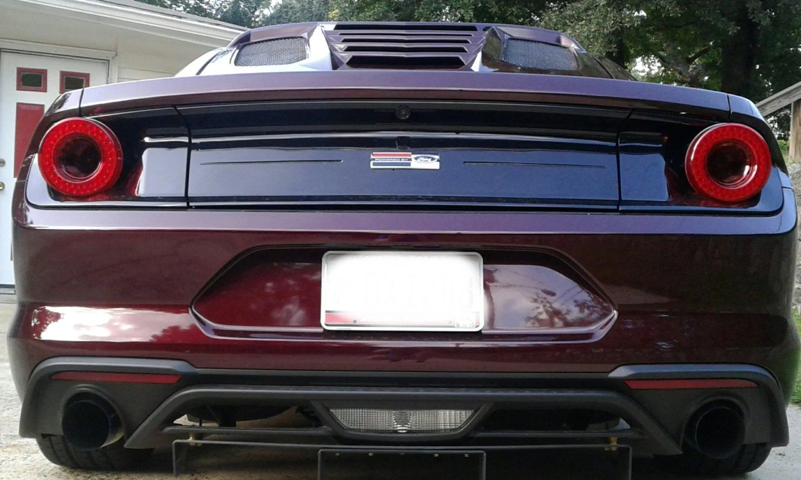

First mod: removed the factory clutch spring, immensely improved feel afterwards. Can't recommend this simple 5min job enough!

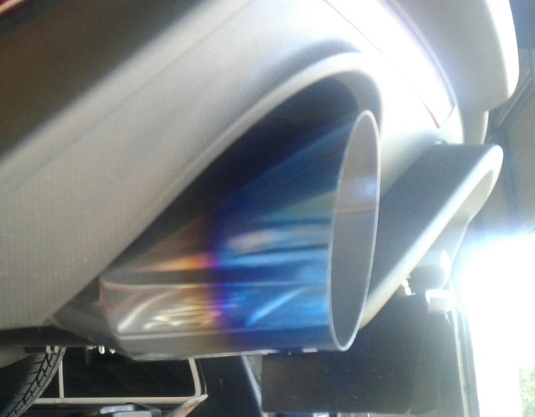

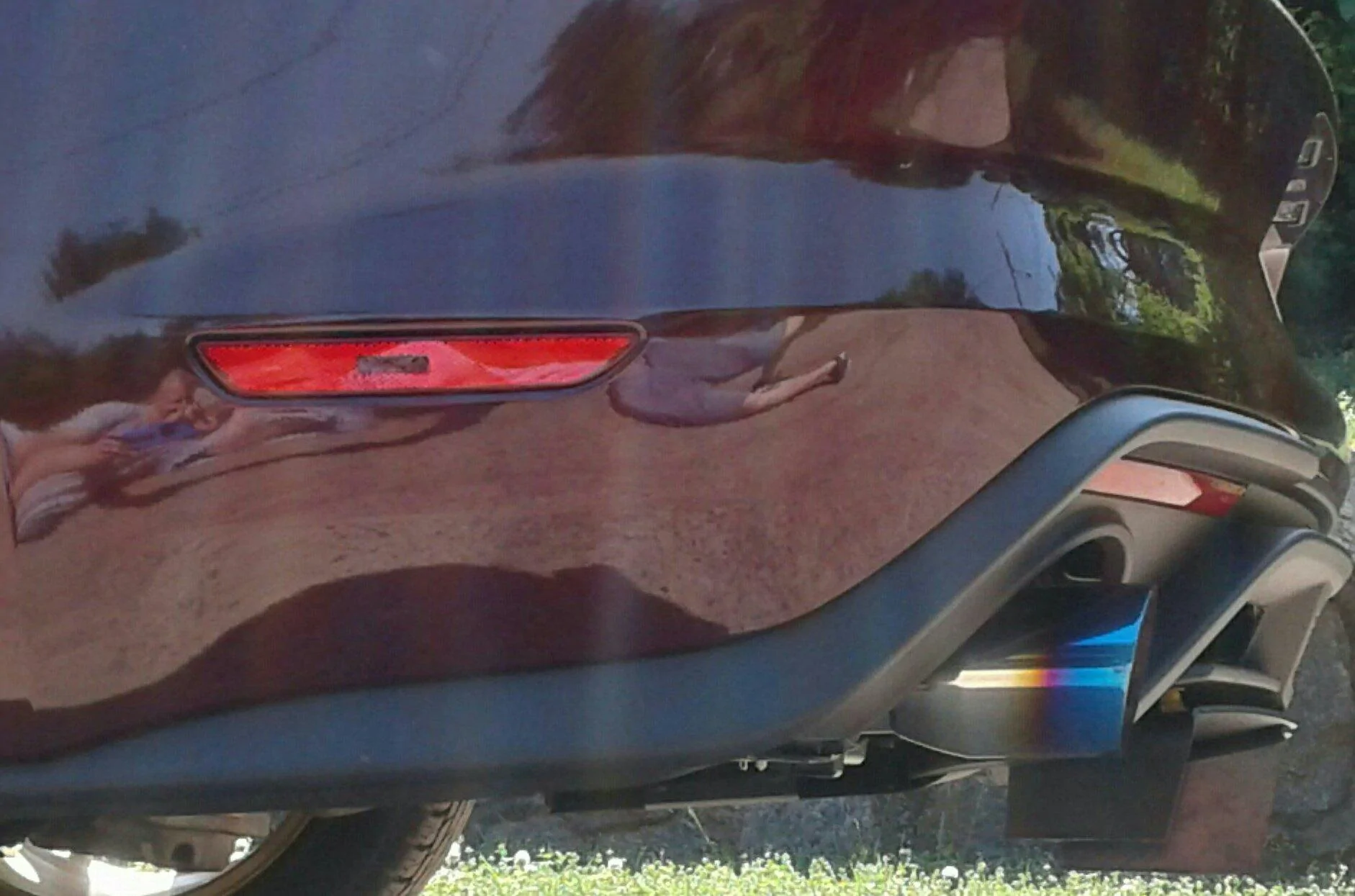

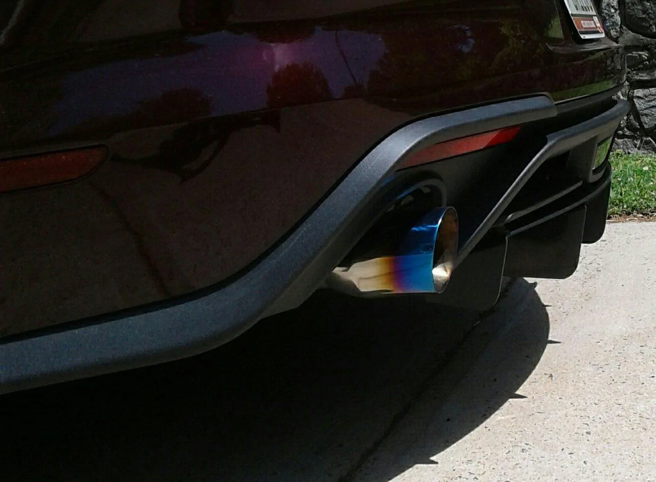

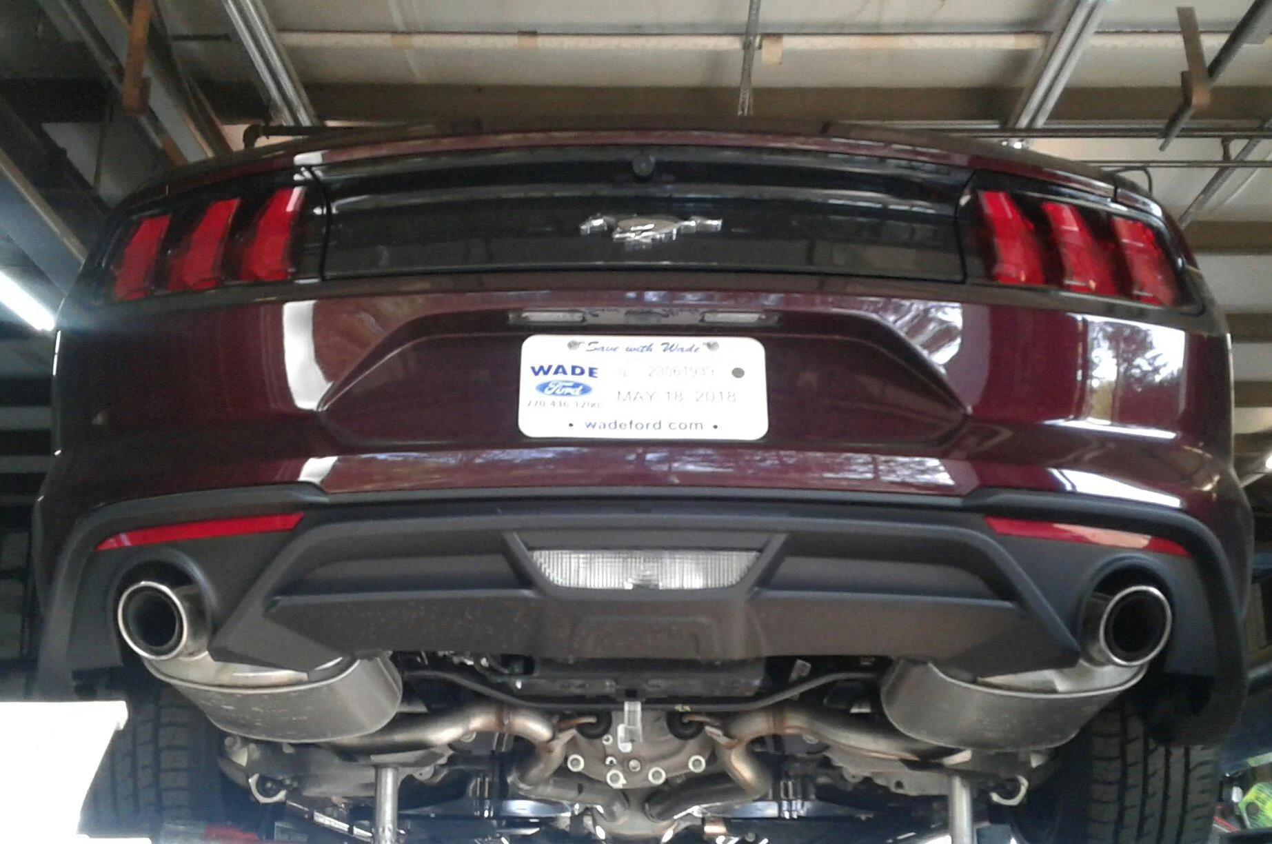

Exhaust: eBay straight thru 3"inlet&dual 2.5" outlets louvered core fiber filled muffler.
Placed in stock resonator spot. Stock oa pipes we're reused, then painted Marlon flat black to better blend underneath the car. Dual burnt 4" slash cut tips. Saved an est 25-30# of total weight and only cost me $310 total.
Has a surprisingly smooth little rumble to it outside the car. Owner of the shop who did it, has done a lot of ebms since they came out. He doubted my setup at first, and then when done said it was the only one he actually liked the sound of lol. Inside windows up cruising it sounds stock just deeper&growly.

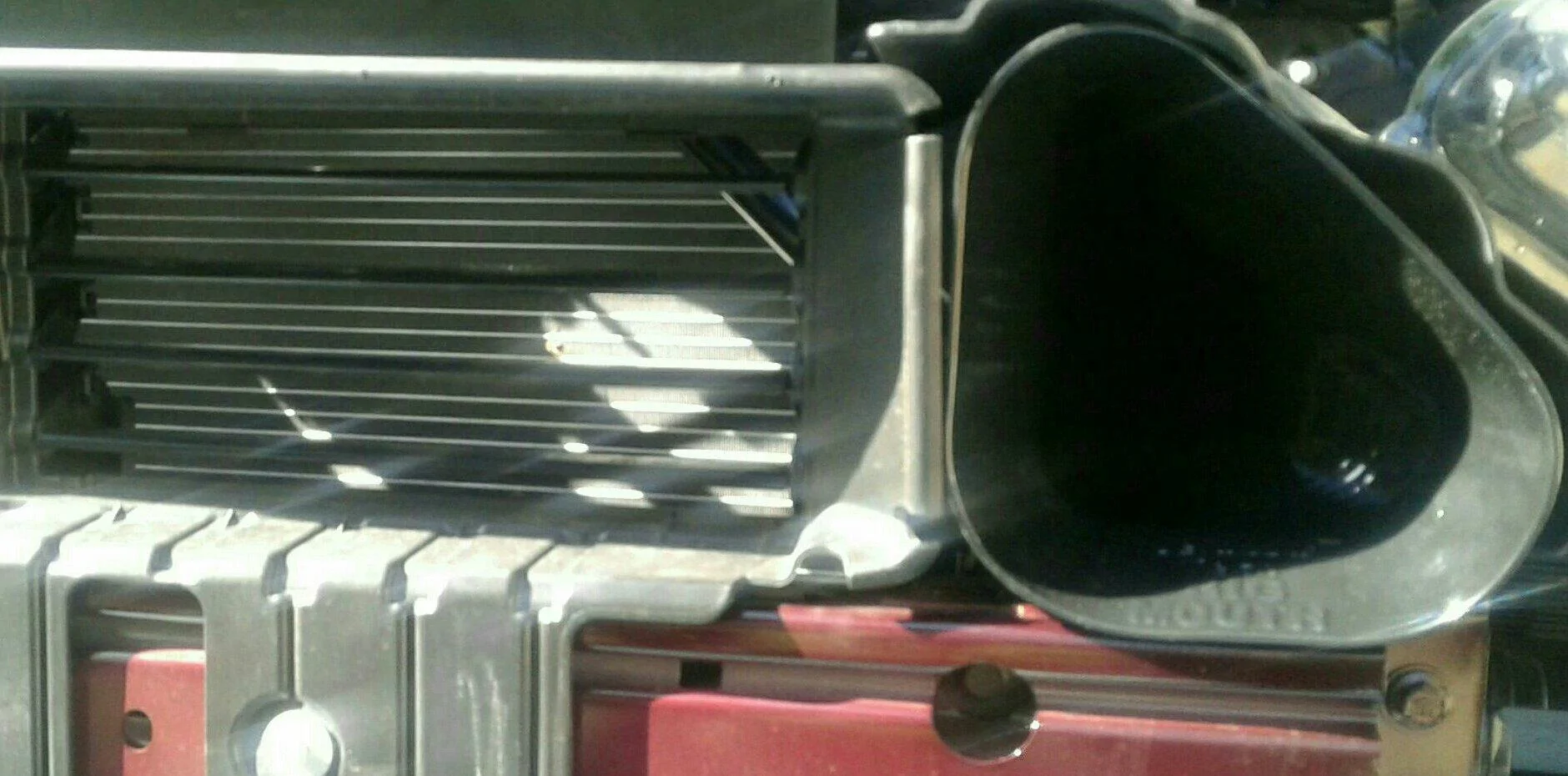

Intake: airaid modular tube(first on an 18), green drop in filter&velossatech ram air scoop(first on a 2018)
Plan to do the frpp tune whenever it's made available

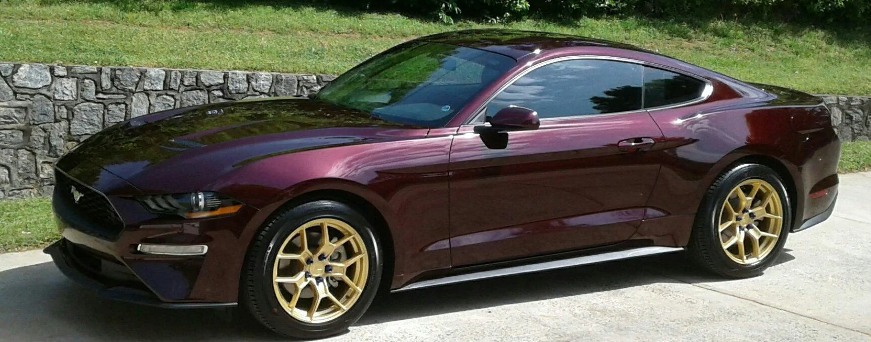

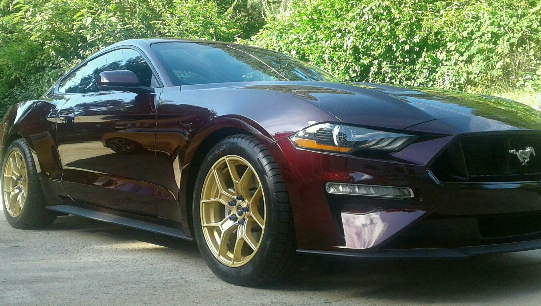

Wheels: gold motegi mr133, offset 25mm(wish it was 10 or 0mm, 18x8.5. 255/45/18 Michelin pilot sport 4s.
Did it right with metal hub centric rings, and just to be different 60mm blue extended lugs to match the burnt exh tips.
2" pony logo w/tri bar center cap stickers I had lying around from my last stang project lol finish it off.
Suspension: Megan racing stb, bmr vertical links, irs lockout&bushing kit, sr performance 1" lowering springs(so far very unhappy with these spring's, drop is only about half of that stated by the manufacturer. Less than .75" in back and only about .5" in front).
Someday? full monotube coilovers>350 sways.
Stock gt or performance pack takeoff 4 piston front brakes and gt rear vented rotors, stainless lines&better fluid to.

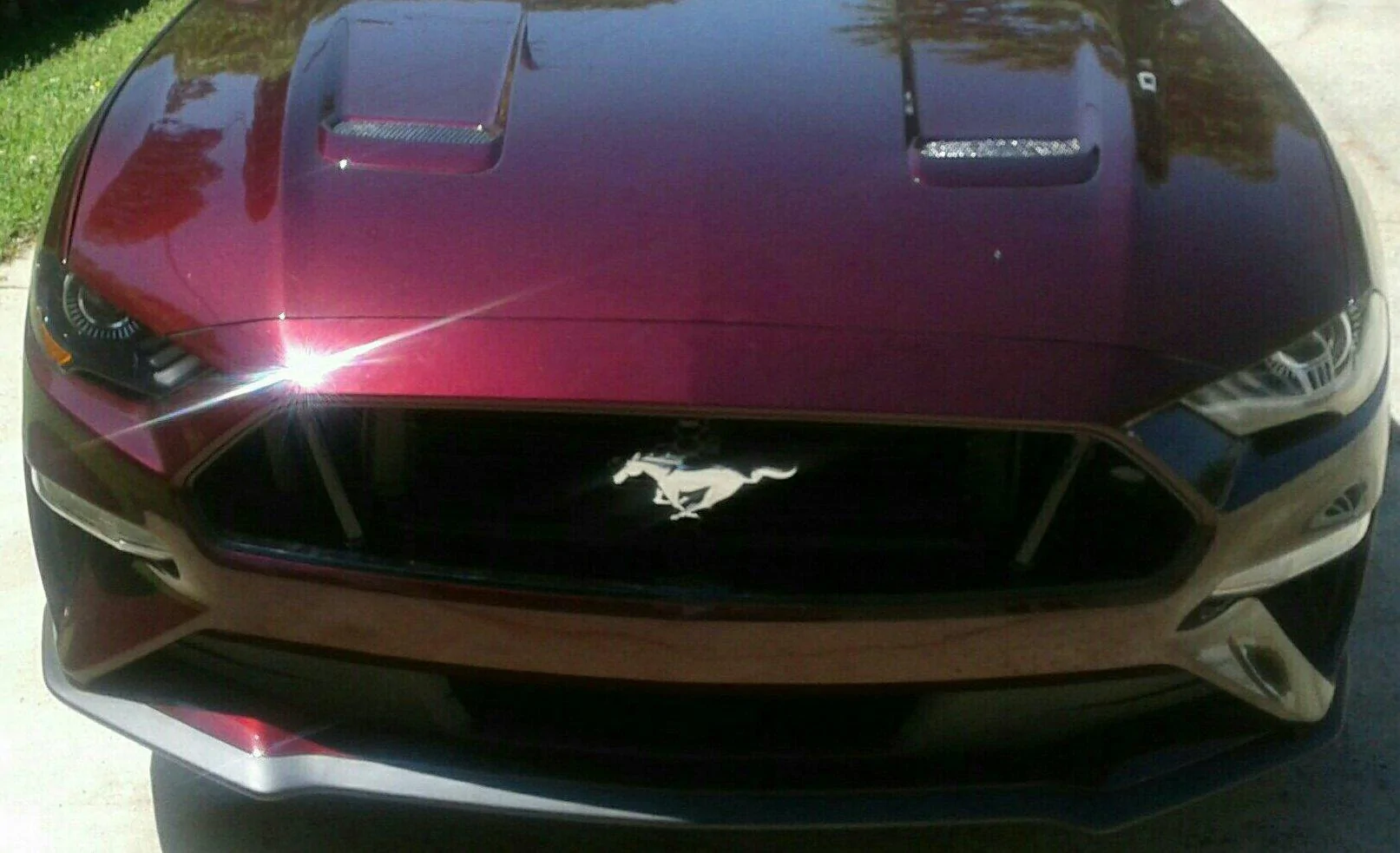

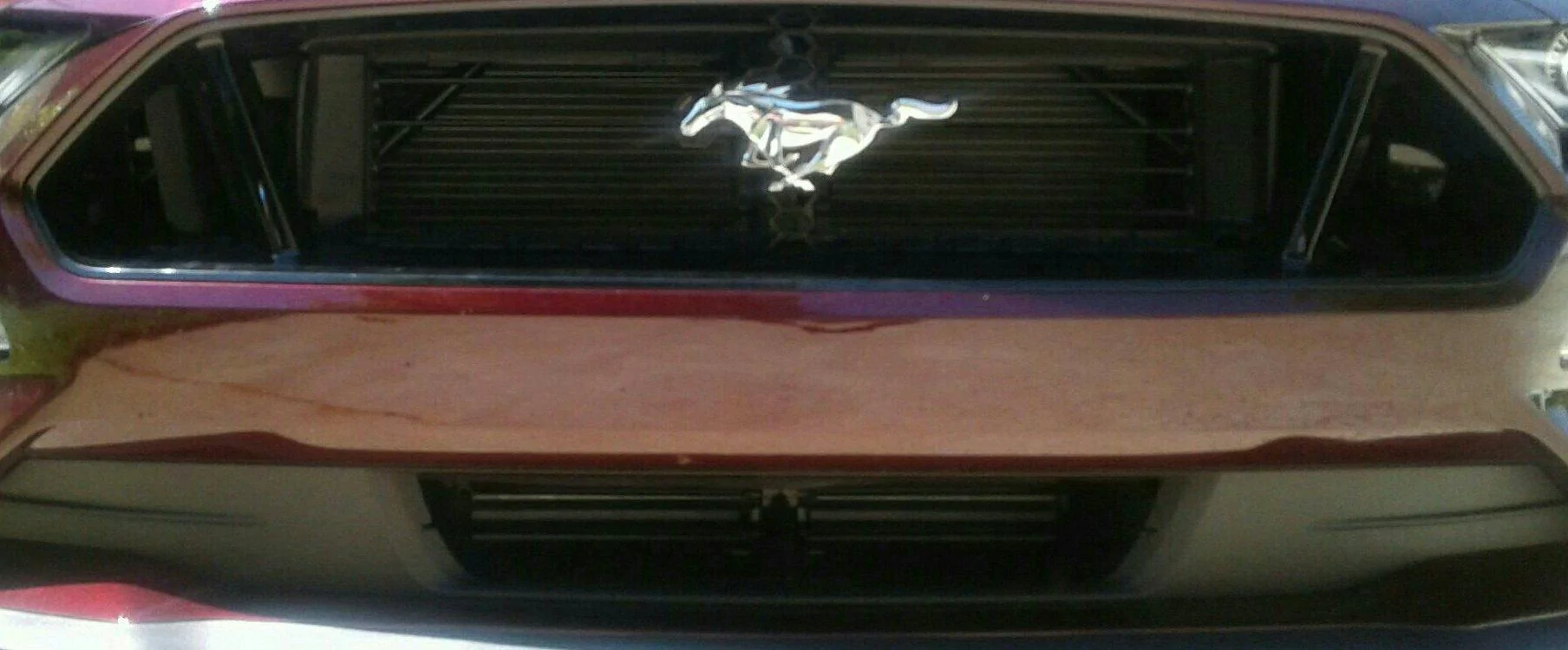

Appearance: stock gt grille opened up with the pony&corral retained in the center.
After doing that project I officially hate using a dremel tool to cut plastic with.
Lower grille cut out to match the upper. Side intakes/brake duct screens opened to match the actual vent size.

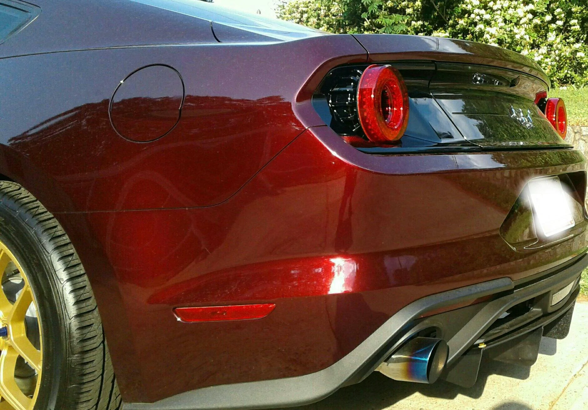

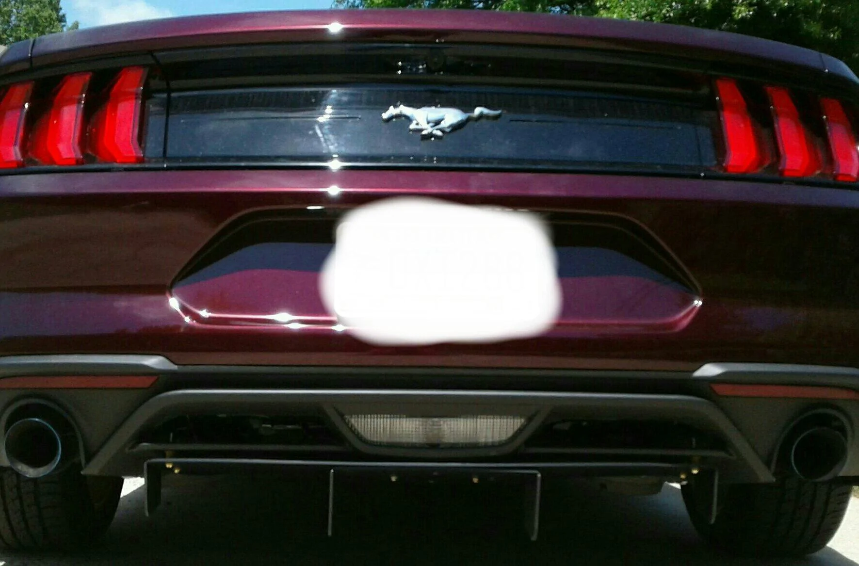

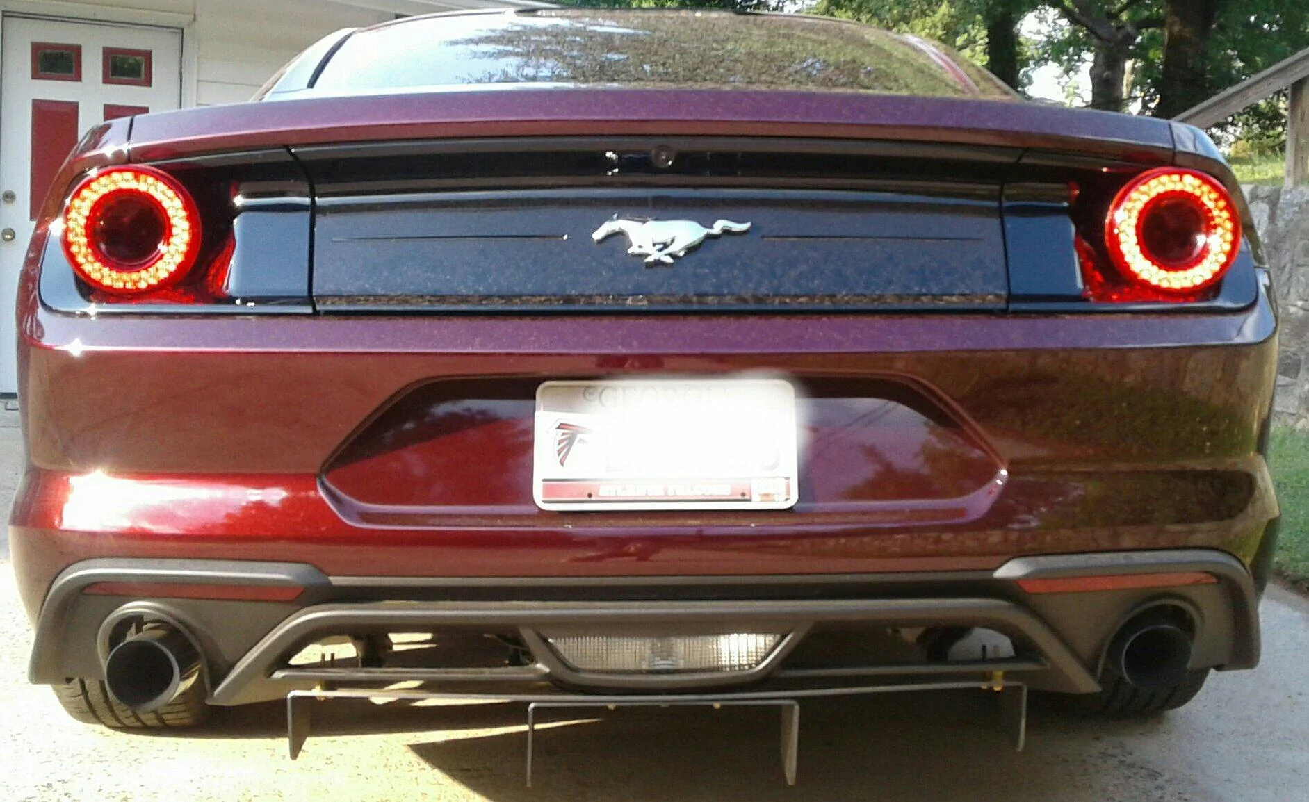

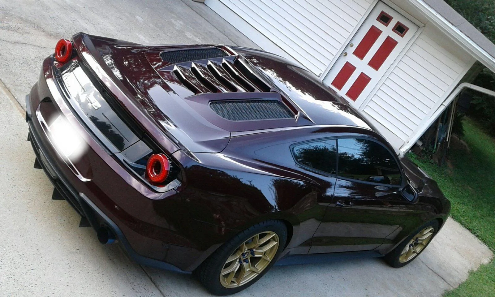

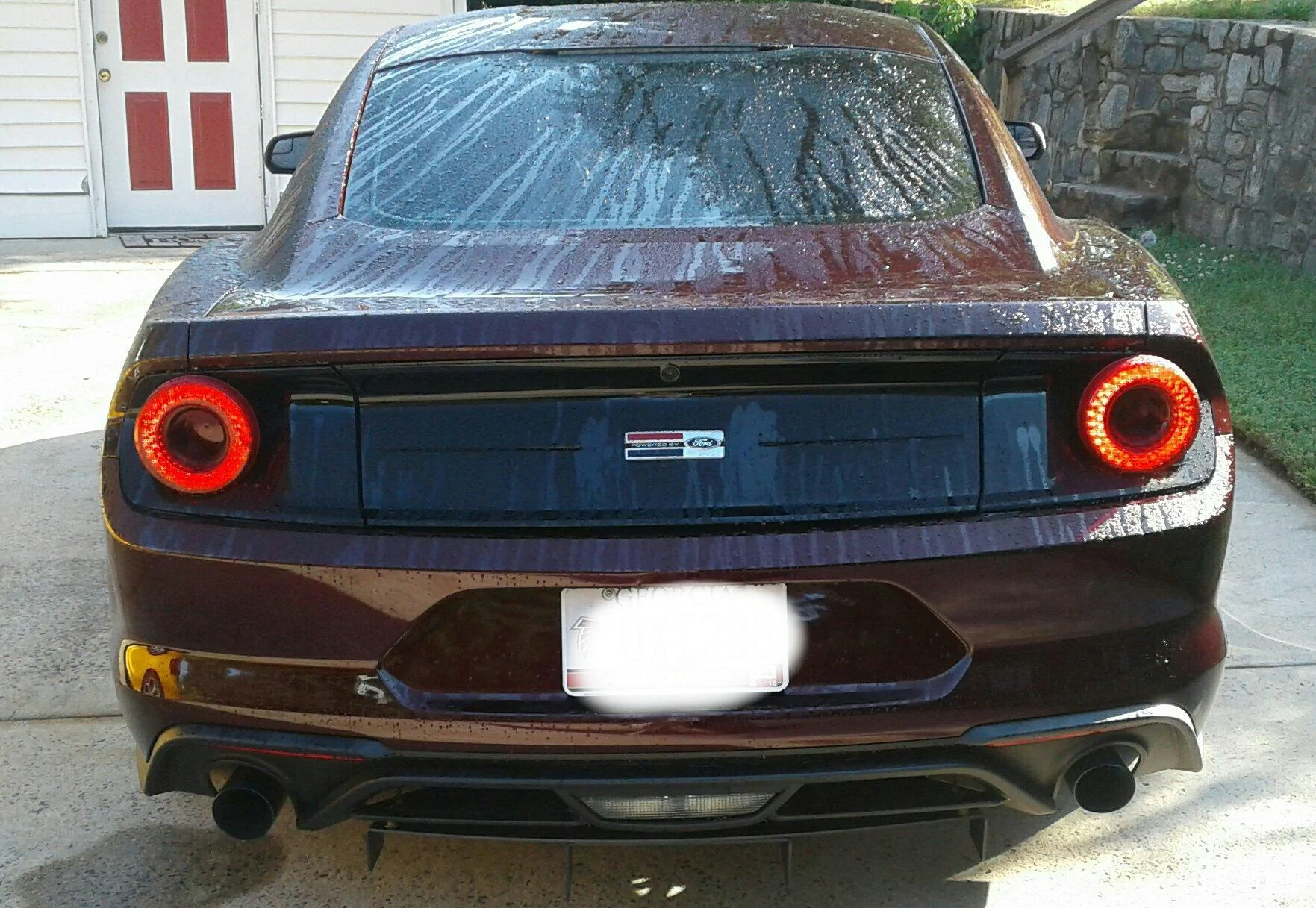

Rear bumper opened up either side of the reverse light area using a dremel, custom diffuser bolted up that I trimmed the fins on to better match. Gold/zinc plated mounting hardware securing it all to the bumper.
Hood struts.Mirimoto red "gt" style led smoked taillights. Ikon motorsports v2 rear louver painted to match.

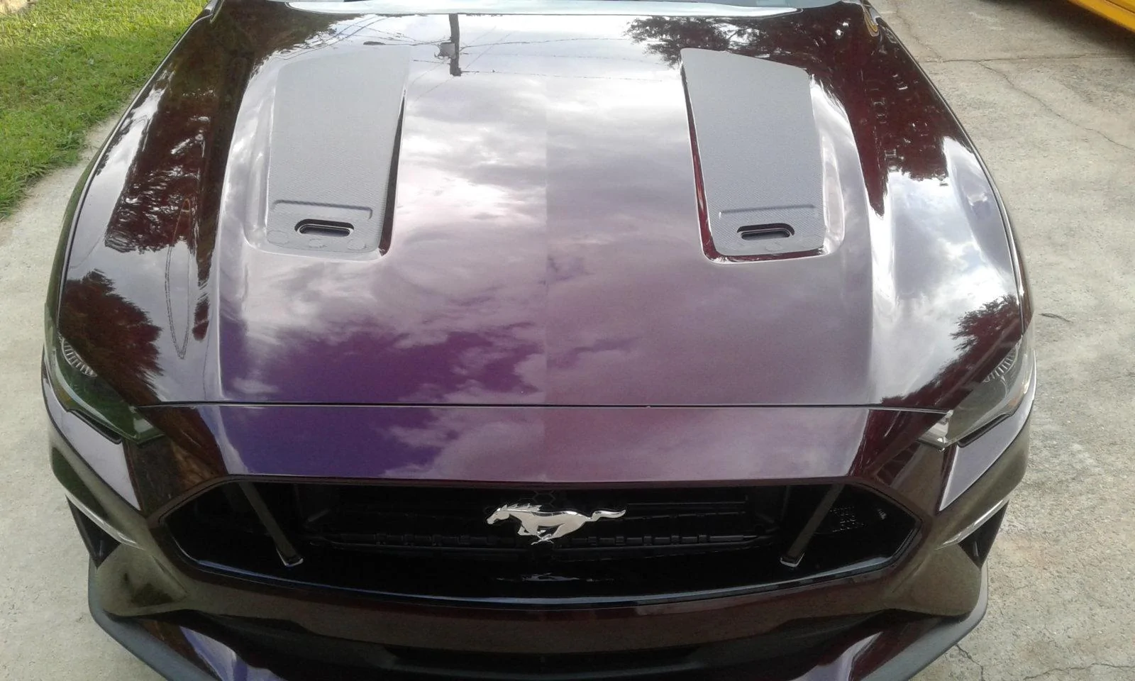

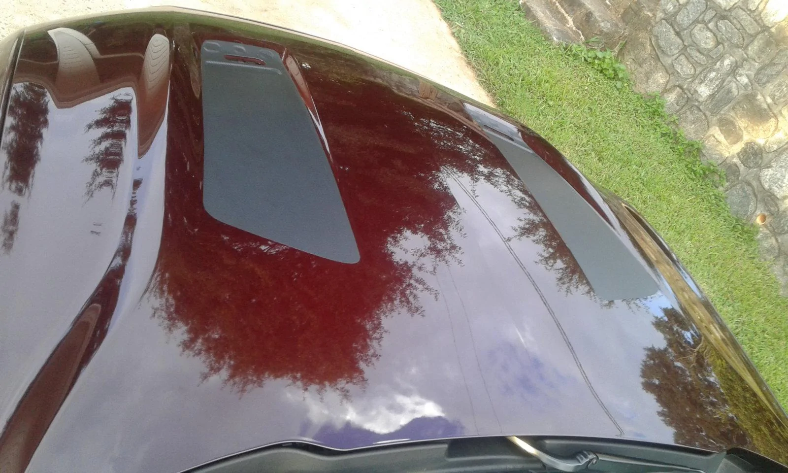

gt40 emblem replacing the rear pony. Hood vents removed&cf vinyl accents added in their place.
Tint at 20% on sides back&frontwindshield strip, 35% on the driver's&passengers windows. Rear marker lights also tinted.
Ceramic coated the entire car. Trunk scuff guard.
Fitted 50yr anniversary logo sunshade. Roush side vent inserts(not installed yet)
Want to ad the mmd front lip spoiler when made available.
Also a small gold side stripe/accent to better offset the wheels.
