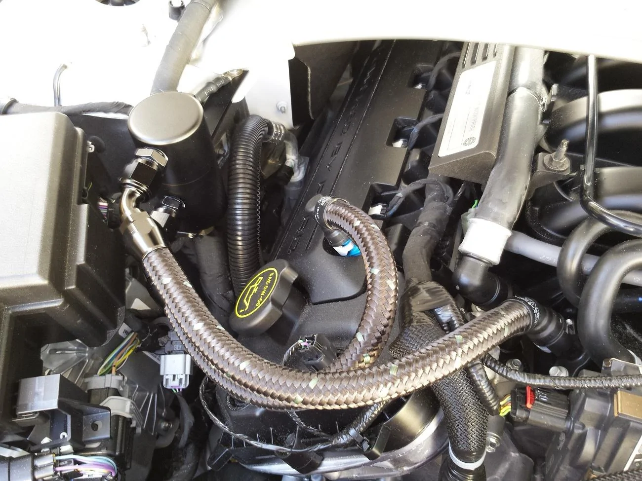

Here's a pic of mine. I took it out 6 months ago and replaced with the ford one. Ill use this on the gt500. I would have liked the bobs more if i would have cut the one line a little shorter

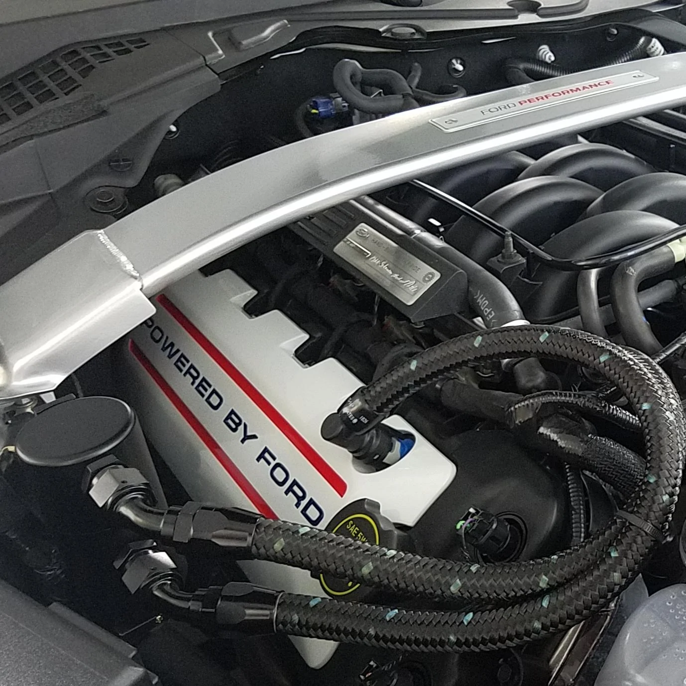

Here's mine in the old track pack.
