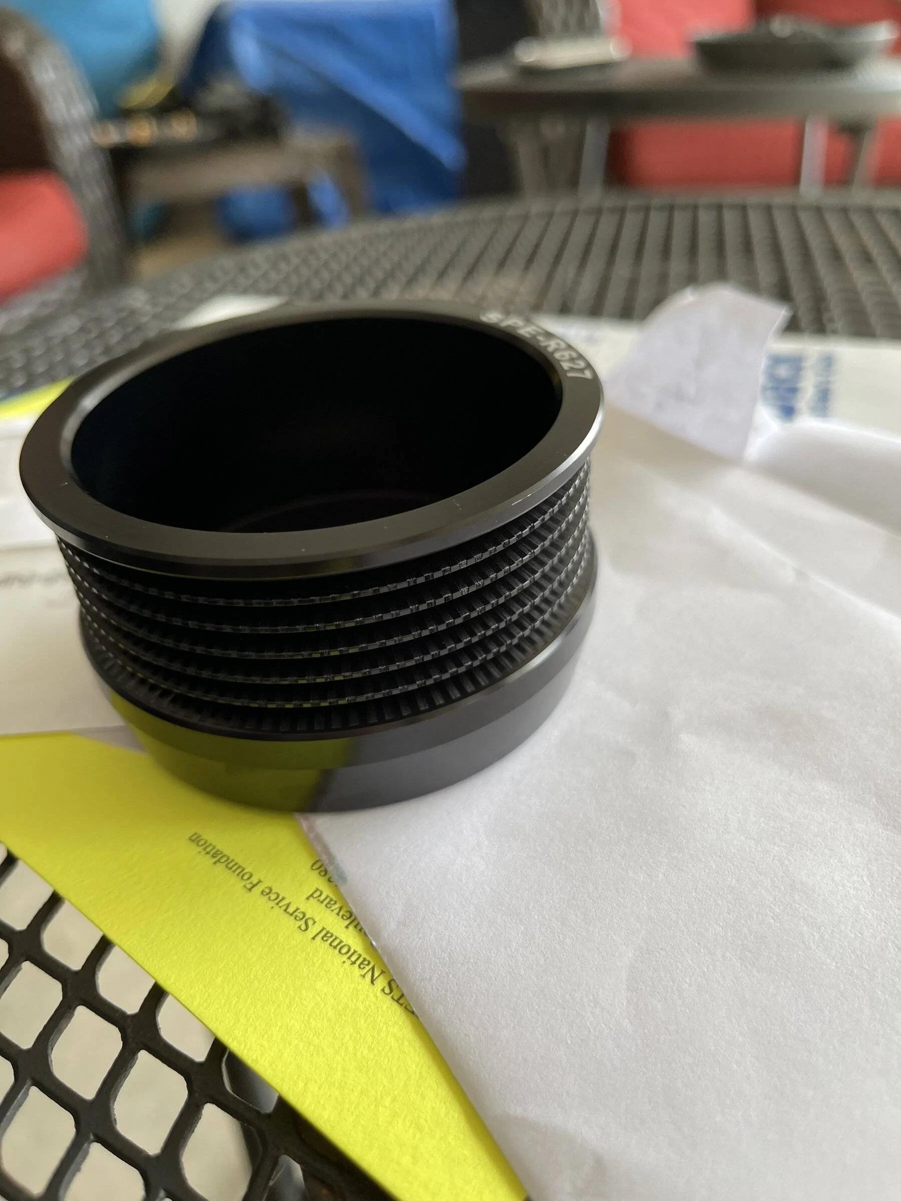

Griptec pulley just goes in place of the regular pulley on the supercharger.

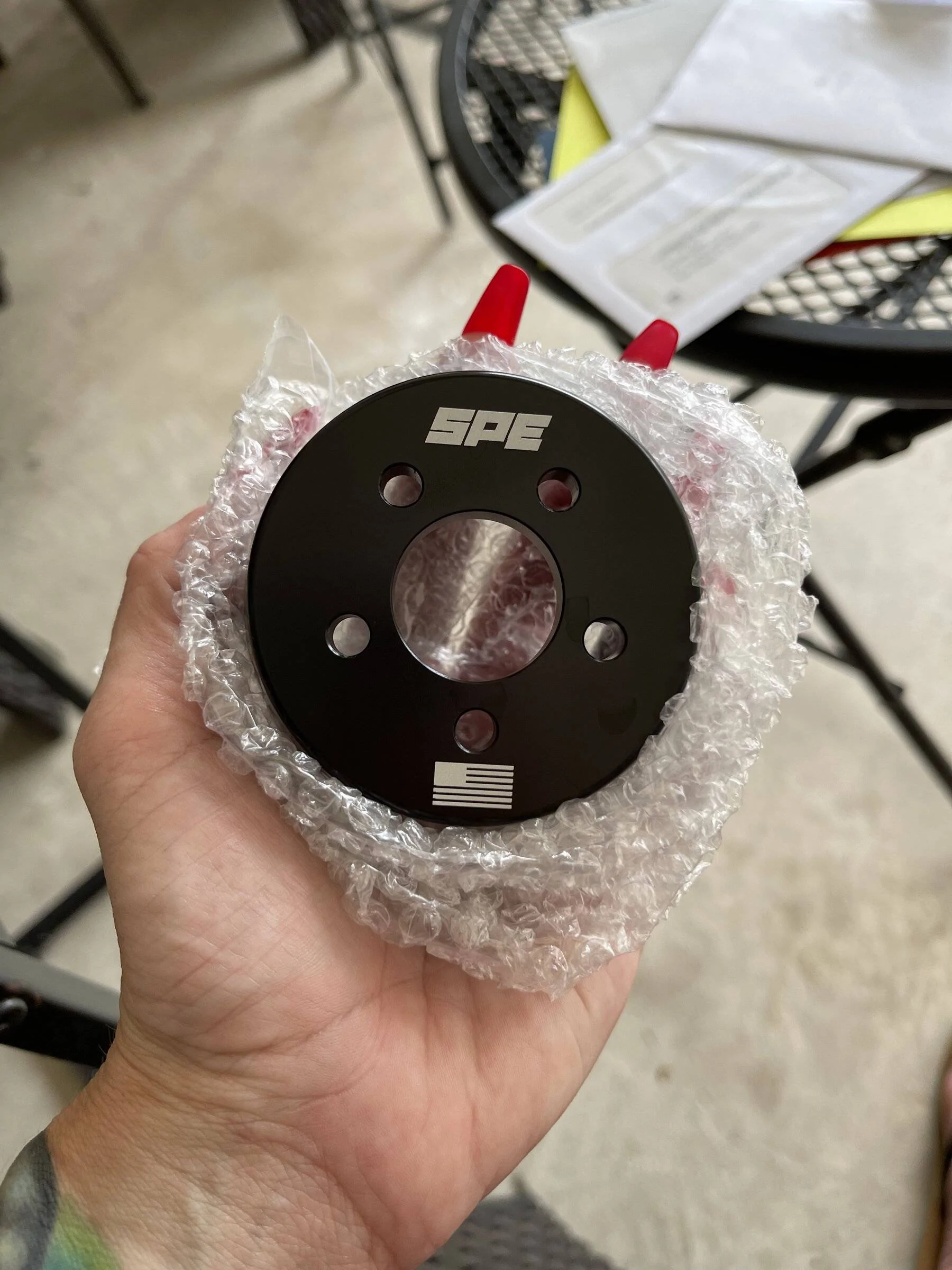

Ah. Never heard of SPE. Wonder how it stacks up against the Griptec?
Looks good!
