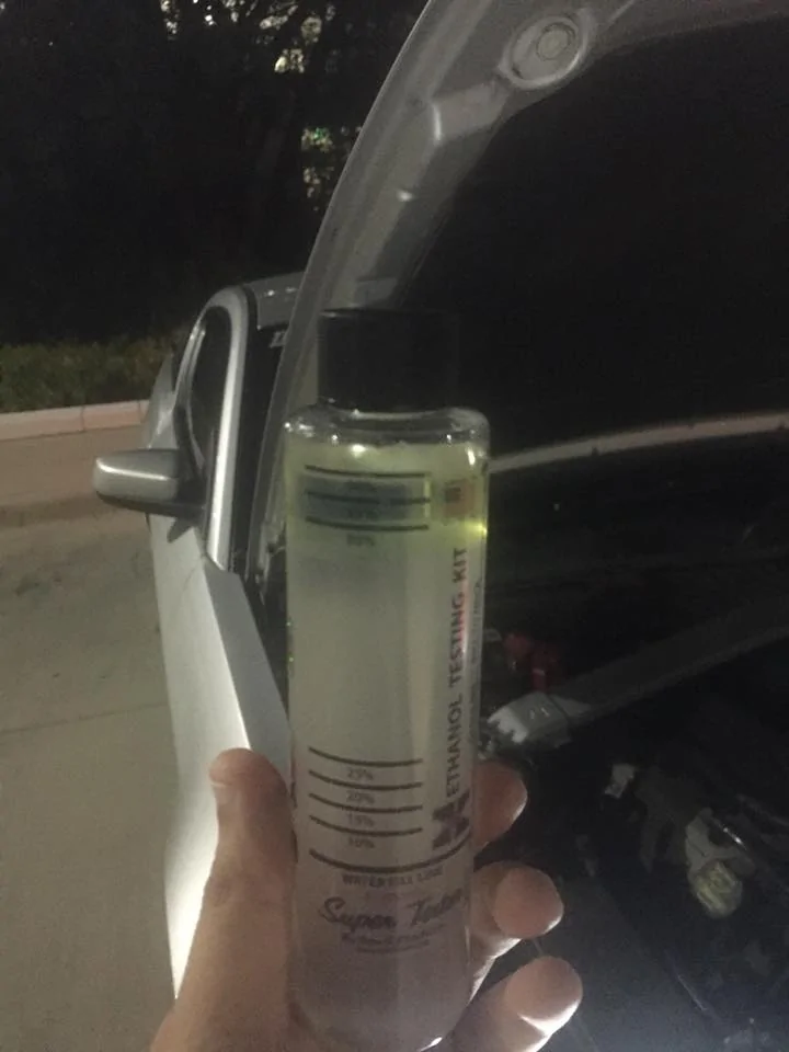

This is why you want to test your pump e85. This particular fill up was e70, which has a stoich value of 10.7. Since this car runs a e85 tune(not flex fuel) it needs to have an accurate stoich value in the tune in order to avoid running into fuel trims that are out of spec(I personally like them to be +/-5% max).
Best way to handle it is test the e85 you use when tuning, you tuner will set the stoich value for the e% you are running, 10.7 for the picture I posted, then you dial in the MAF knowing it's accurate, from there the tuner can change the stoich to give you a tune you can swap too in case you get a different e85 percentage, Usually I would send a e60, e70, e80, and e85 file that way the customer has options in case he runs into some crappy E

It won't matter, I do mine the same as you, water first, since the water line is on the bottom. But as long as the same volume of water is put in the tester, it will show the same value. What happens with the tester is the water attaches to the ethanol and not the water, this causes the ethanol to stay under the unleaded, which gives you a separation line, which tells you what the e% is since water only bonded with ethanol and not unleaded.
