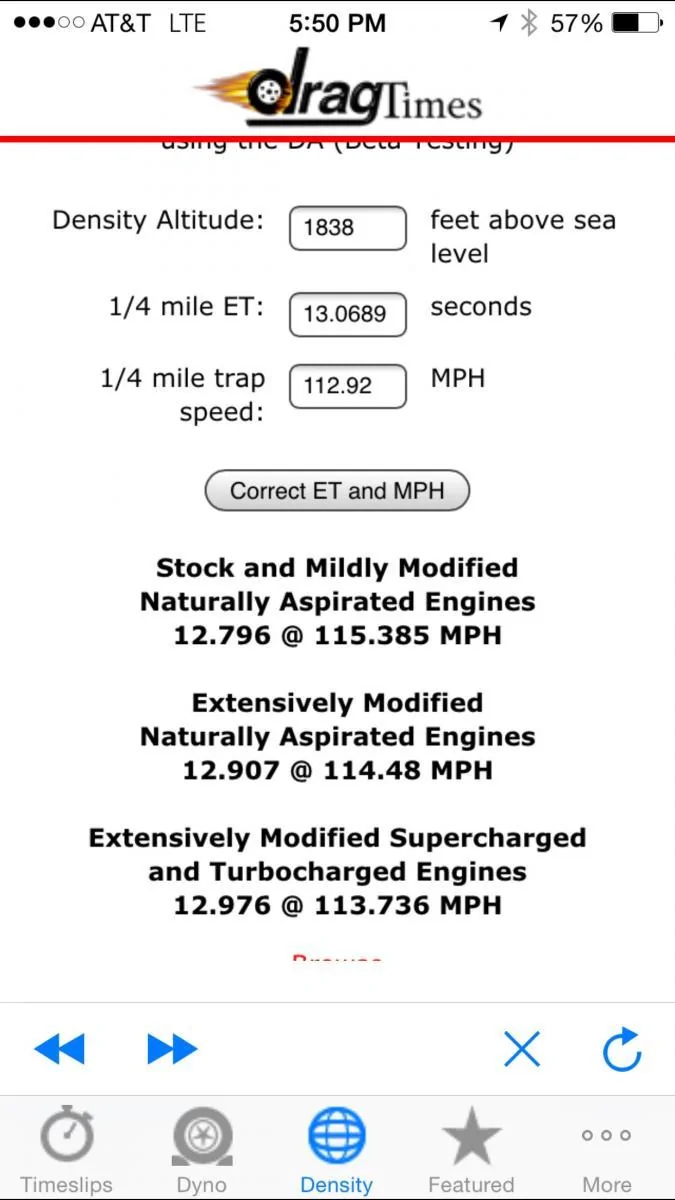

your 60ft is killing your time. Here's the DA of the track you were at. Also the corrected times. Not sure how accurate it is.
