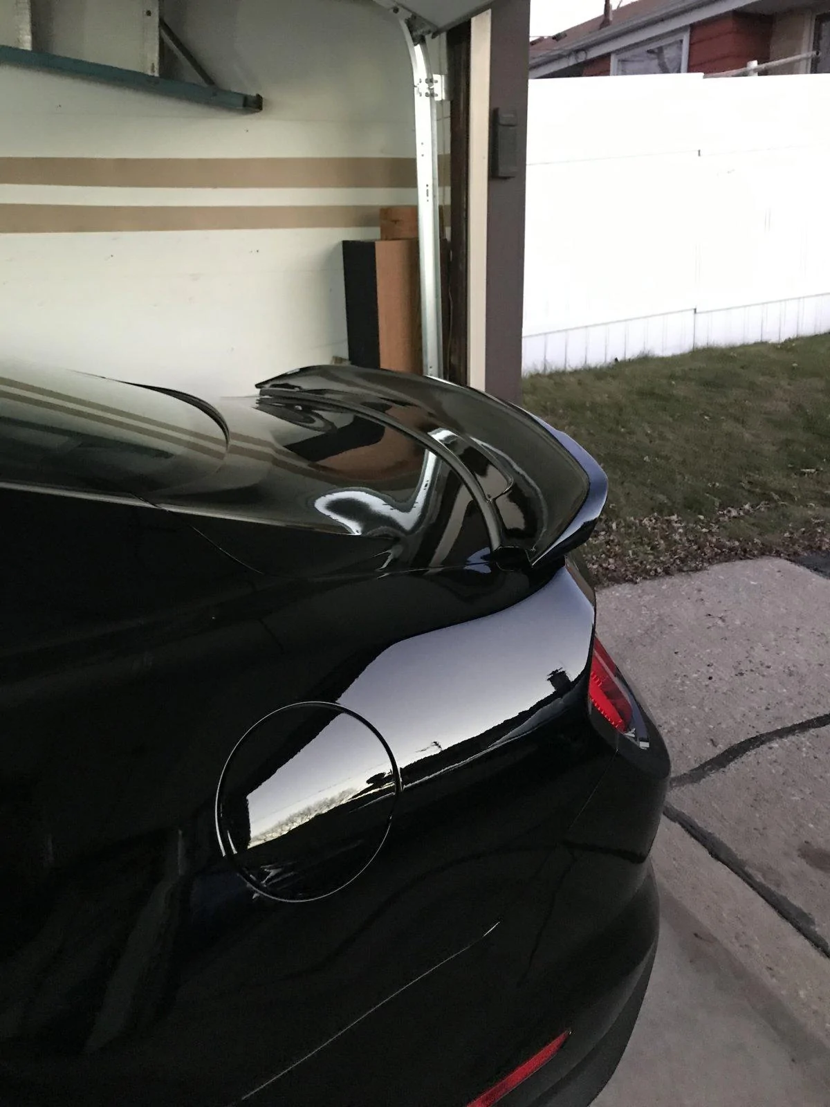

So I just wanted to give a little update on my spoiler install. I decided to not drill onto the trunk and just went with 3m double sided tape. I will say that that spoiler is stuck on there like white on rice. I did not clay bar the trunk but I did do all other steps. I used rubbing alcohol , some 3m adhesive spray and 3 strips of VHB 3m extremely strong double sided tape. I found some at home depot. I did do someting stupid though. After the install I did not allow the tape to cure. I let it sit for maybe an hour and took it out for a drive. On that drive the spoiler was exposed to an average of 70 mph winds and some light rain. When I got home the spoiler was still solid like a rock. The next day I felt really confident that it was on there. I got the car washed but when I got home that's when I got down in the dumps. The spoiler was still very solid but when I looked down at an angle, I noticed the 3m tape was lifting up. I was about to throw in the towel and completely remove the entire spoiler and start again but decided to put some 20 lbs weights with plenty of microfiber towels under on top of the spoiler right on the edge where the 3m tape was lifting up. I honestly didn't think it would help at all but decided to give it a try. I left the weights on there for 24 hours. So just today I got home from work and lifted up the weights and the 3m tape sat back down flush with the trunk. I was very surprised but still thought it was not sticking. So I tugged and lifted and pushed and pulled at that spoiler but that thing is on there. It is rock solid... So anyway that was my experience. I went with the tape and not the screws. I don't regret it. But who knows maybe with time the spoiler will start to lift and not stick but for now I'm going to see how long this spoiler lasts. From what I can see and feel the spoiler is rock solid. If someday it starts to come off. Ill just start fresh. And for sure the next time I will def clay bar and allow the tape to cure. But for now I'll see how long this thing stays on.

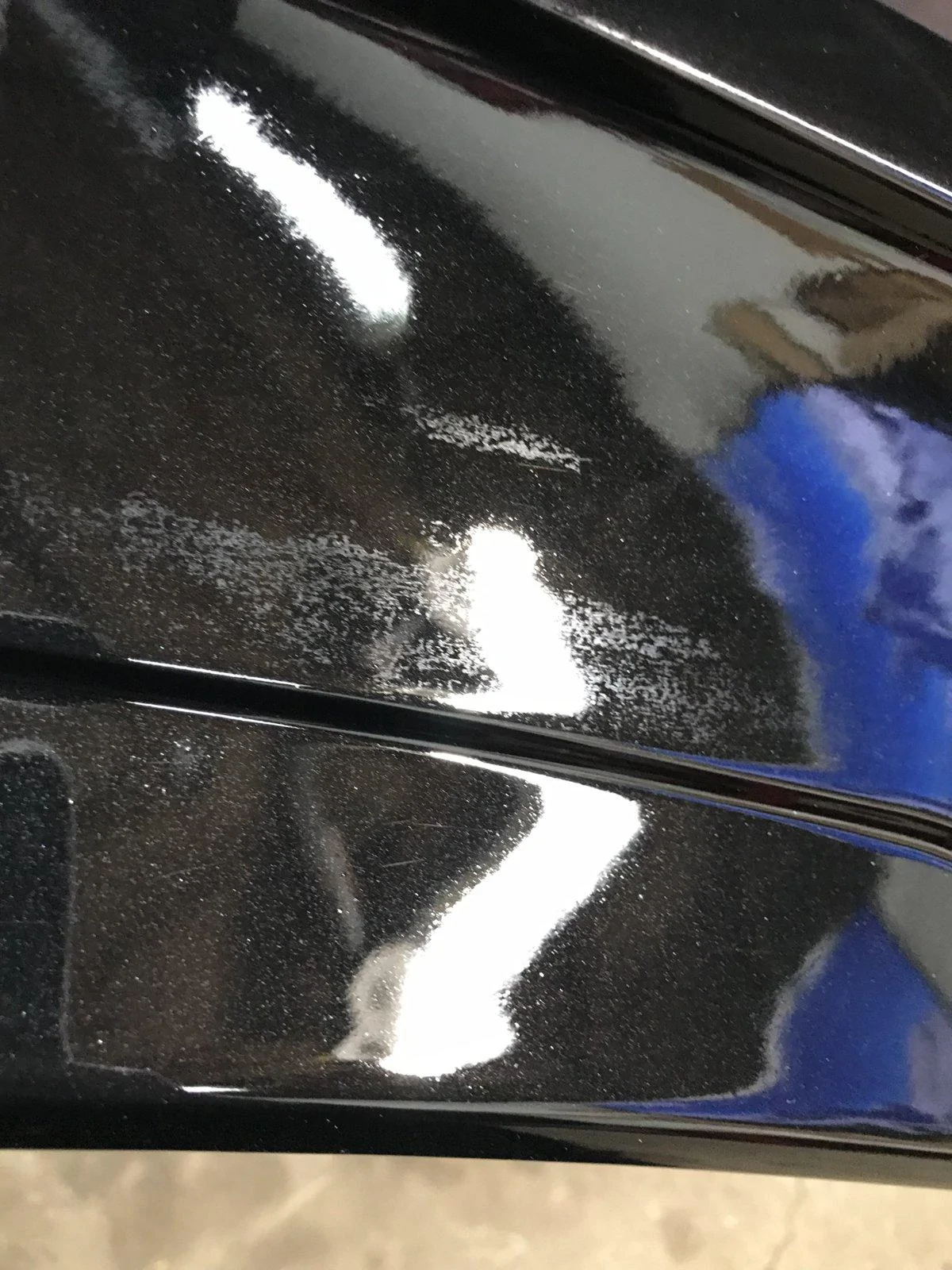

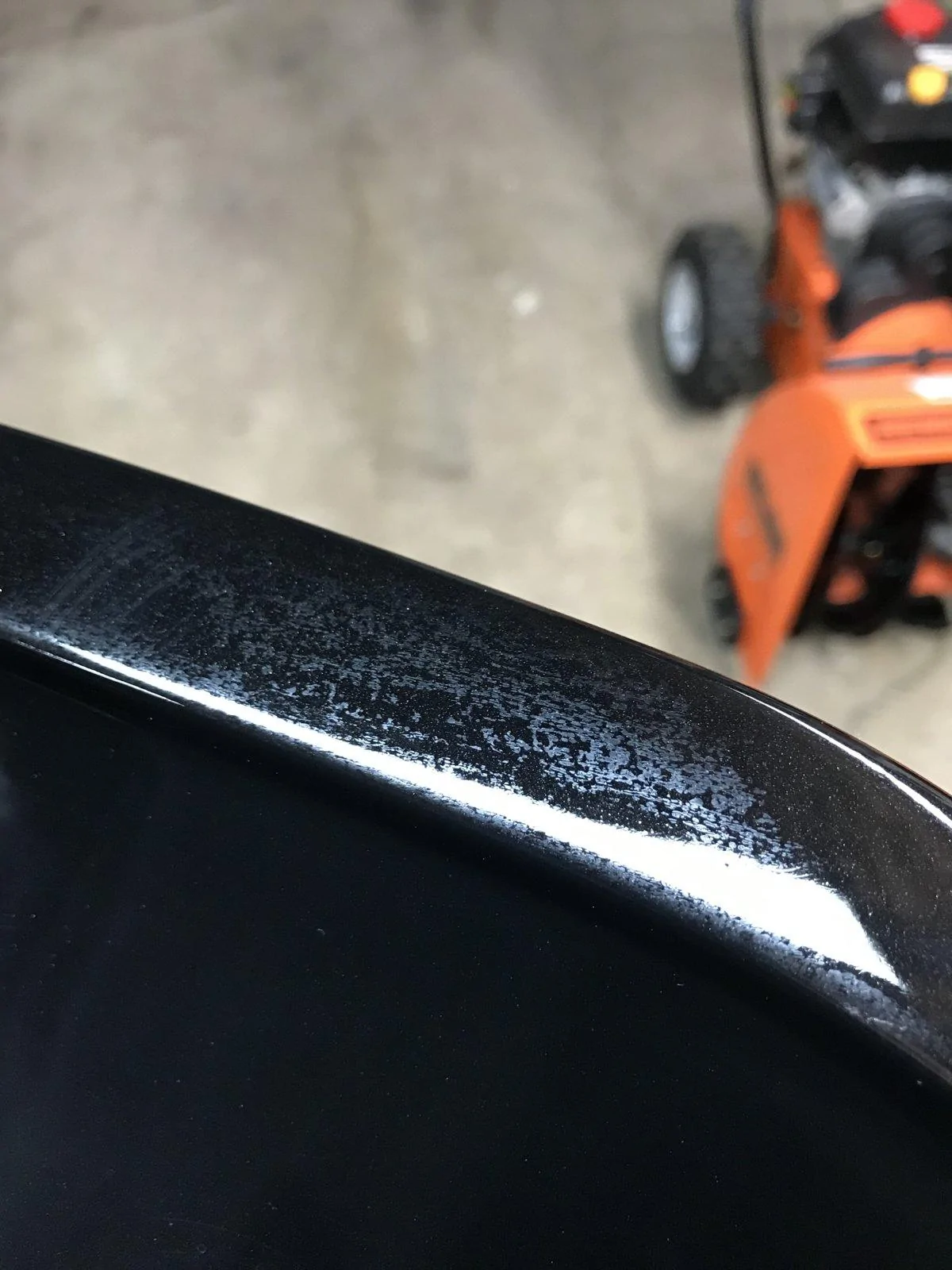

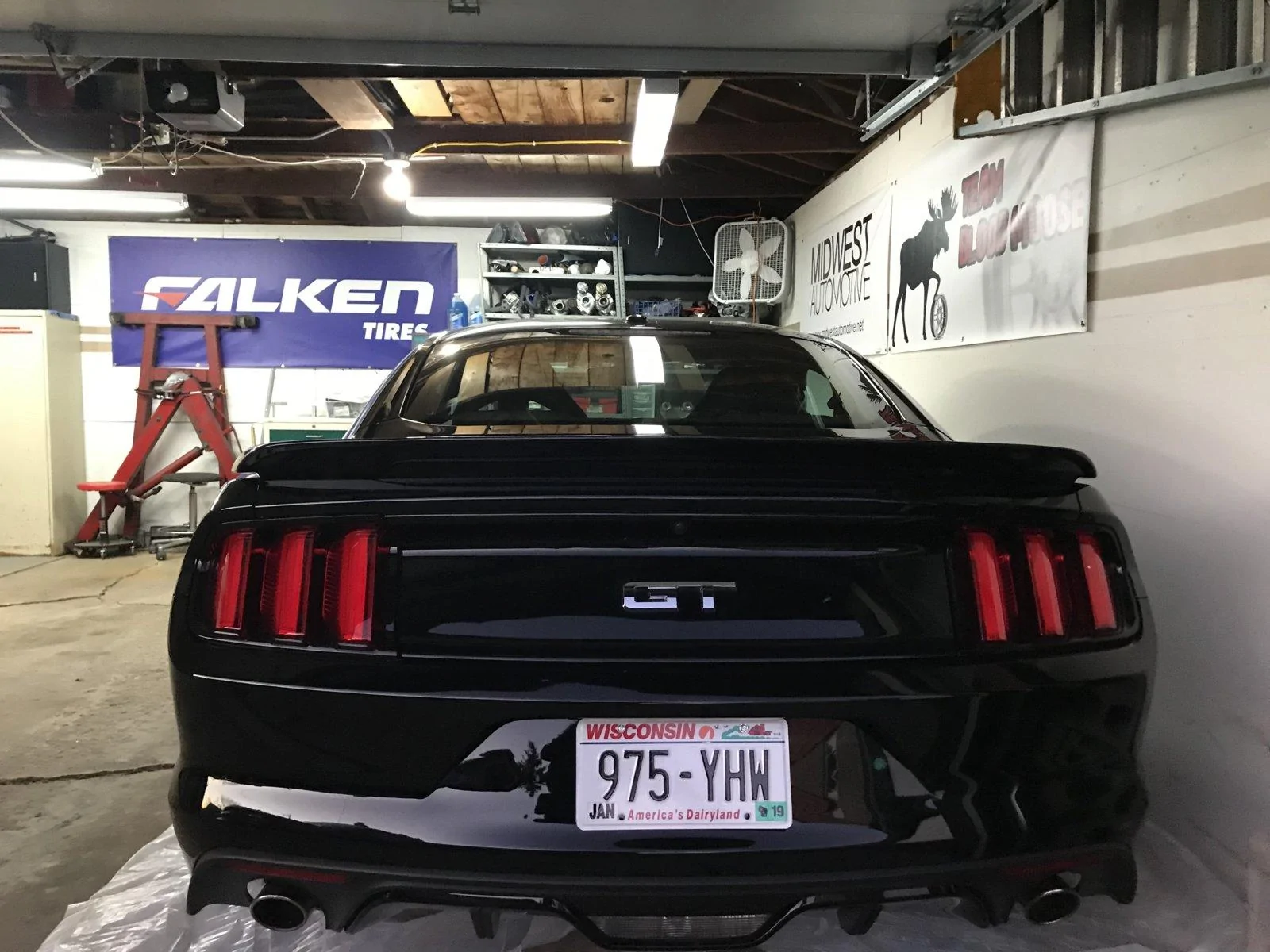

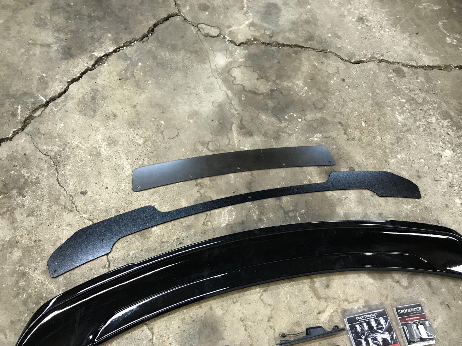

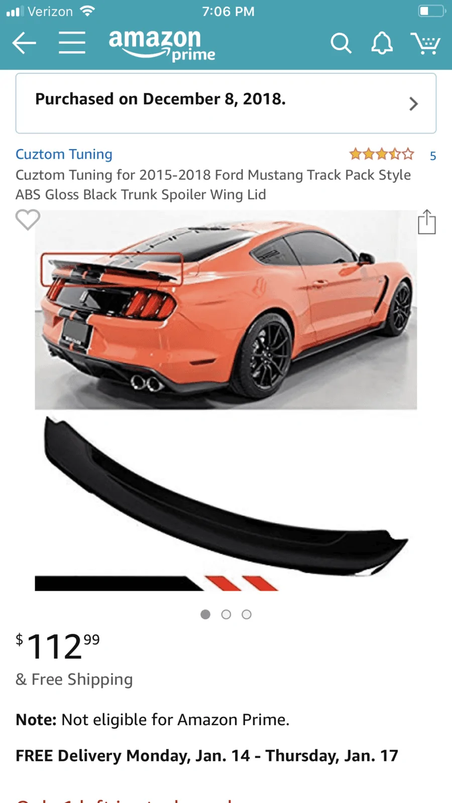

I purchased a track pack spoiler from Amazon. The specific one is below. Upon it arriving, the spoiler had some marks from the packaging. You can see the spots where it looks like styrofoam was pressed against the paint. I tried a quick spray wax, and an actual cleaner wax on it. Neither pulled the foggy smudge from the paint. In addition, the clear coat is so poor that even a microfiber with a spray wax on it leaves scratches.
The spoiler itself it decent. 4 screw holes in the bottom. Seems pretty sturdy. There isn’t any waves in the spoiler or random dents. Overall the actual spoiler was in good shape. But the paint was horrible. I would never put the wing on the car as is. It would last 2 days and immediately look like garbage.
However, I knew this was a potential risk. Since I will be taking the GT badge off the rear deck lid and having a friend fill holes/smooth and paint that, I will be having him paint the spoiler as well. Basically this wing comes “painted”, but should be treated as unpainted. For $112 shipped, I am decently happy with it.
Photos attached of the spoiler purchased, the wing sitting on the car (not installed), the “scuff” marks on the wing, and the wing laying next to the ZL1 Addons wicker bill that will be installed.
