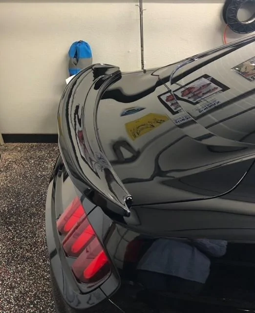

That close up shot looks like the OEM spoiler. Yea i got the one painted in gloss black. Ill post some pics when i get it. You've been helpful. I feel a little better about this ebay spoiler:like:

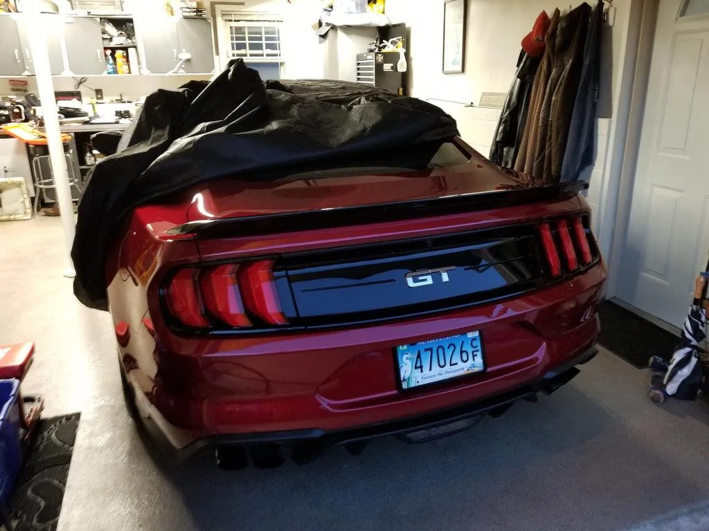

Shadow, that reminds me the one I got from amazon, did not come with mounting hardware. The stock spoiler has studs that come off of it, the one I got had helicoils in it and I used some stainless steel bolts and washers to fasten it.

Oohhh. I was afraid of that. Im pretty sure mine will be coming without mounting hardware aswell. As long as it has those helicoils inserted I should be ok right ? Just gotta get some bolts to insert. Your spoiler looks good btw

Shadow that is correct, like I said I didn’t use the 3m tape they provide I bought some branded 3m, and 4 stainless bolts and washers. Also to note the factory spoiler has 2 non threaded studs on it that they use for alignment purpose, my replacement spoiler did not have these so used some silicone to fill those 2 holes and let it cure before I installed to keep any water that may get under from having an open hole to get into the trunk lid. I think this was more my ocd over thinking things.
Bolts were 6mmx10 and I think I used 2-3 washers on each to make up any extra length and some blue locktite.
Good luck install was really easy, removing the old spoiler was a pain in the ass.

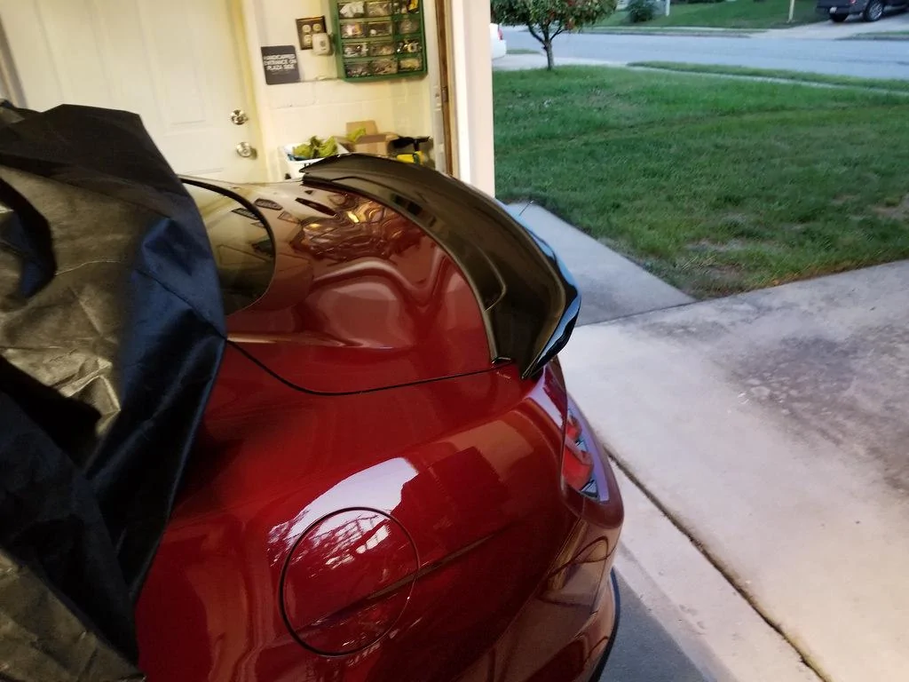

JimsFury, the hole pattern was exact on mine i had the factory blade spoiler, I didn’t have to drill any holes it all lined right up
Mine is a gt350 look alike spoiler, I very happy with it.

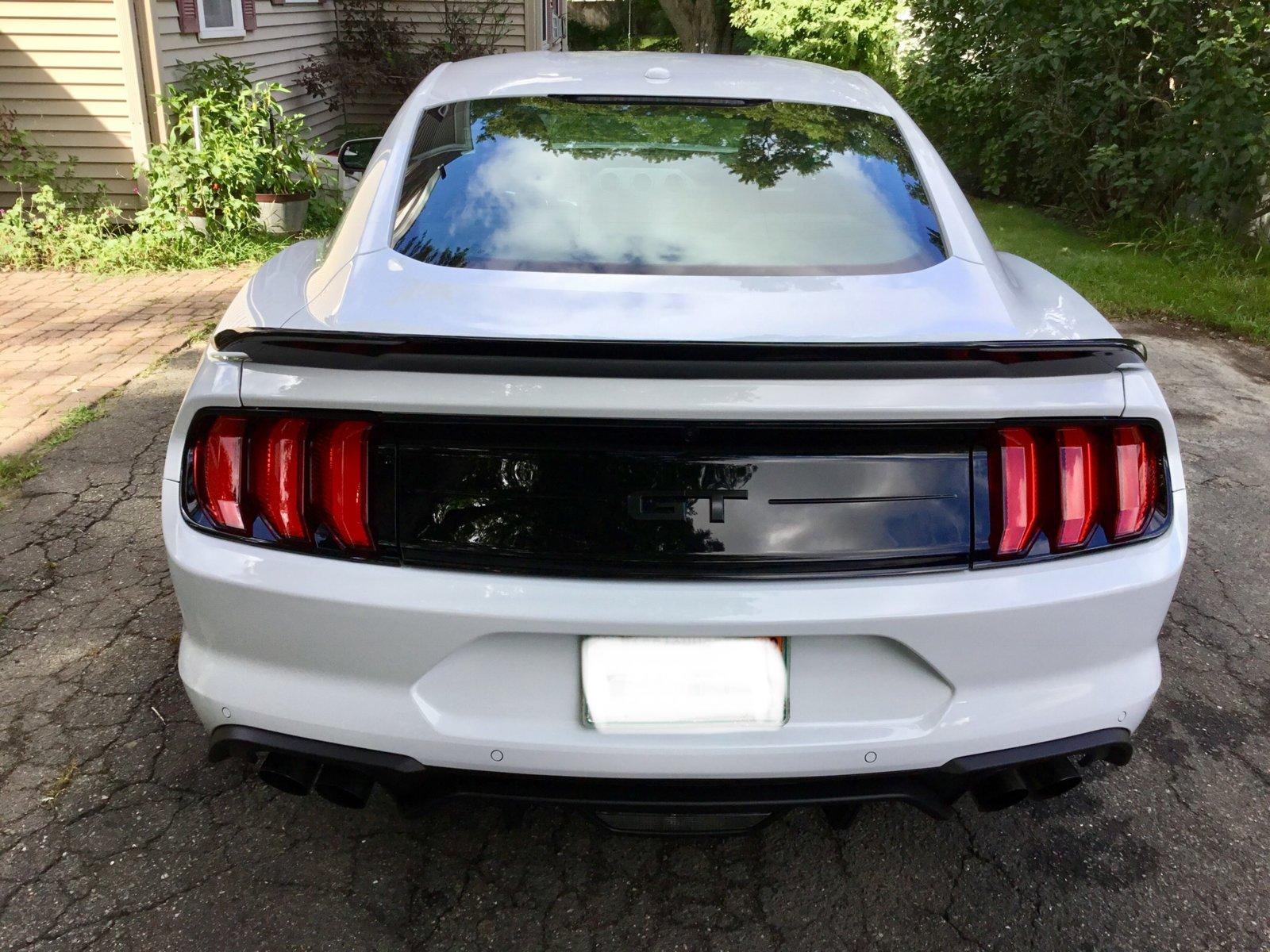

Purchased my track pack spoiler from the Spoiler company on ebay. It came painted and as far as quality and fitment it was spot on. Removed the original spoiler and all the holes lined up perfectly. Paint was very good also. I would highly recommend.

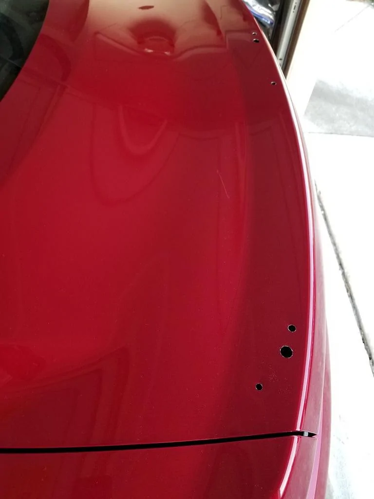

I bought the Ikon Motorsports Trak Pak spoiler on ebay. It was a little over $200, but I had 15% off, so less than $200 total. I did a lot of research and settled on Ikon as good quality. Shipped from CA to MD the 1st 1 that came had a smashed end. They were great about it - I sent pics and within a day they shipped another. Second spoiler arrived with a slightly less smashed end. They wanted to give a partial refund and have me get it fixed locally, but I opted for full refund. They sent me a label to return it. I can't complain about the service I got from Ikon at all. Their packing wasn't up to cross country UPS treatment.
I ended up buying the genuine Ford part for quite a bit more money. Cheapest I could find it was on ebay for $417.95. I waited for another 15% off deal and bought it. Seller is Portsmouth Ford in Portsmouth, NH. 1 end of the box was damaged, but the spoiler was unscathed.
1 big difference I didn't realize is if you don't have a factory spoiler the Ford version requires drilling 9 holes, 3 separate sizes. The Ikon was 4 bolt holes only. The Ford part comes with a really nice pattern to locate the holes. Extreme pucker factor when the drill came out!
Awesome ! Thank you for your feedback. Picture looks really good! I have my fingers crossed for me but from what im hearing sounds like I shouldn't worry
