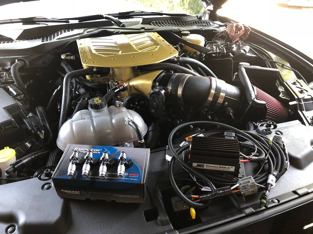

So we headed over to Power by the Hour where Jake and crew installed some Injector Dynamics ID1300x's, 3.625" pulley and a JMS Fuelmax pump voltage booster. Since the car already had a fuel pump upgrade from the stage 2 kit there was no need to do anything else with the pump.
After the parts were installed the car was strapped to the dyno for "Grill Master " Jon Lund II to do his thing. A few pulls and some datalogging with tune revisions we got the go ahead that the car was ready. Unfortunately we didn't get any solid HP numbers from the dyno as it wasn't reading correctly. However the datalogs looked great which is all that really matters.

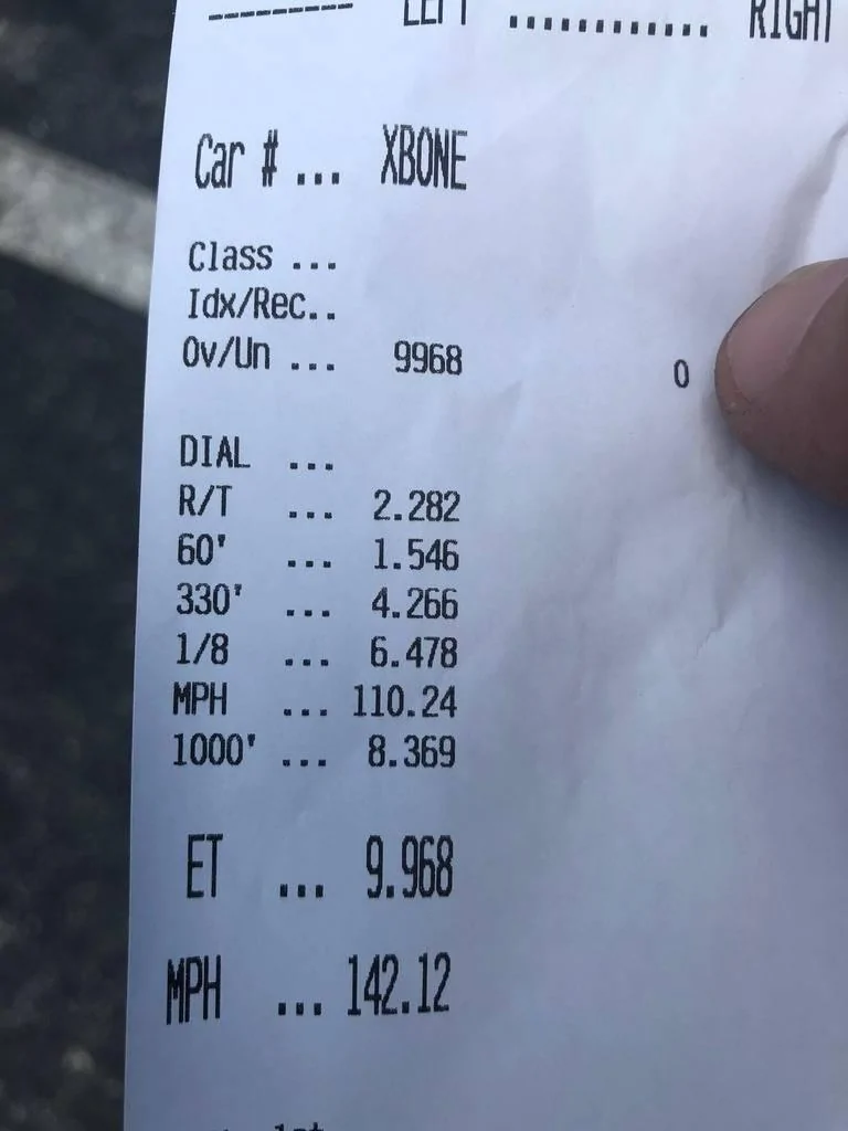

It was a hot and humid morning at Palm Beach International Raceway which is to be expected in July down here in South Florida. We unloaded the car and made our first pass of the day which yielded us a 10.02@142mph. So close to that first 9 second pass. Cooled the car down and made another attempt this time remembering to datalog the car. 9.96@142mph with a 1.54 60ft time.

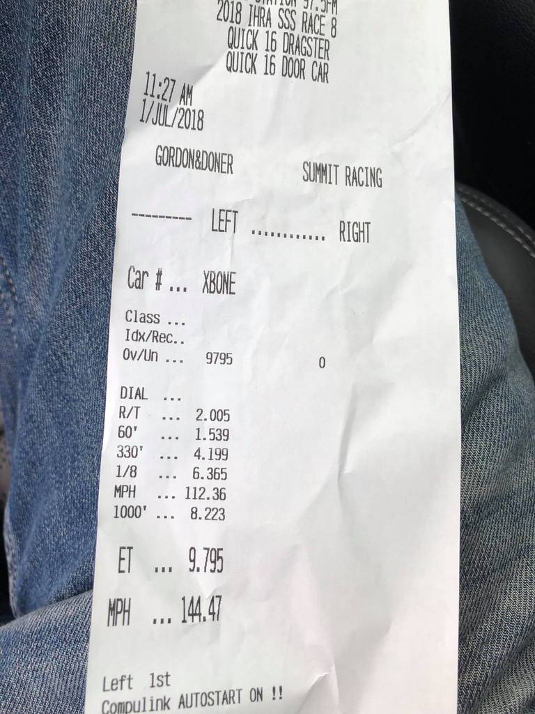

After Jon Lund II reviewed the datalog he fired back a tune revision which we flashed the car with using the Lund Racing Ngauge.
The next hit Jared was able to crack off a [email protected] run.
