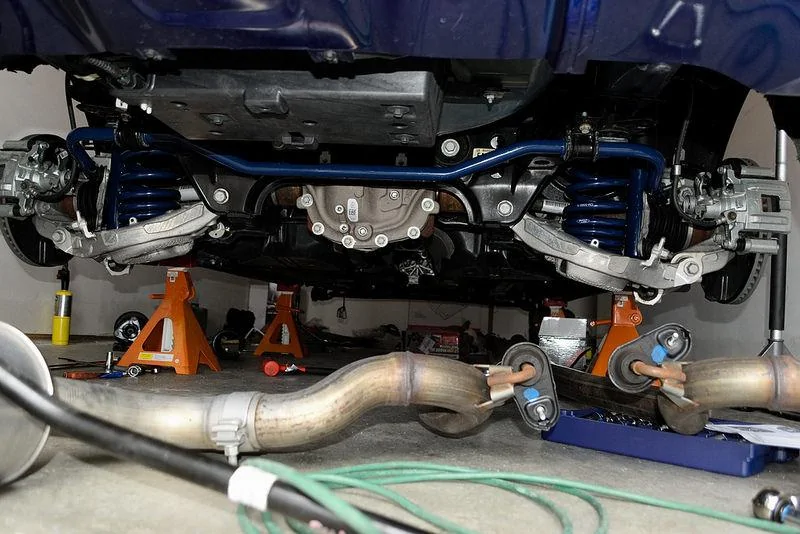

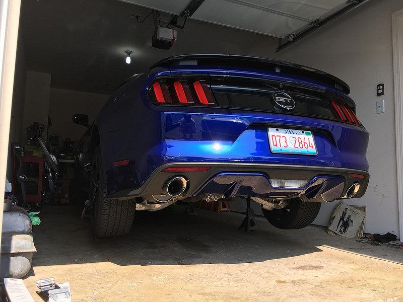

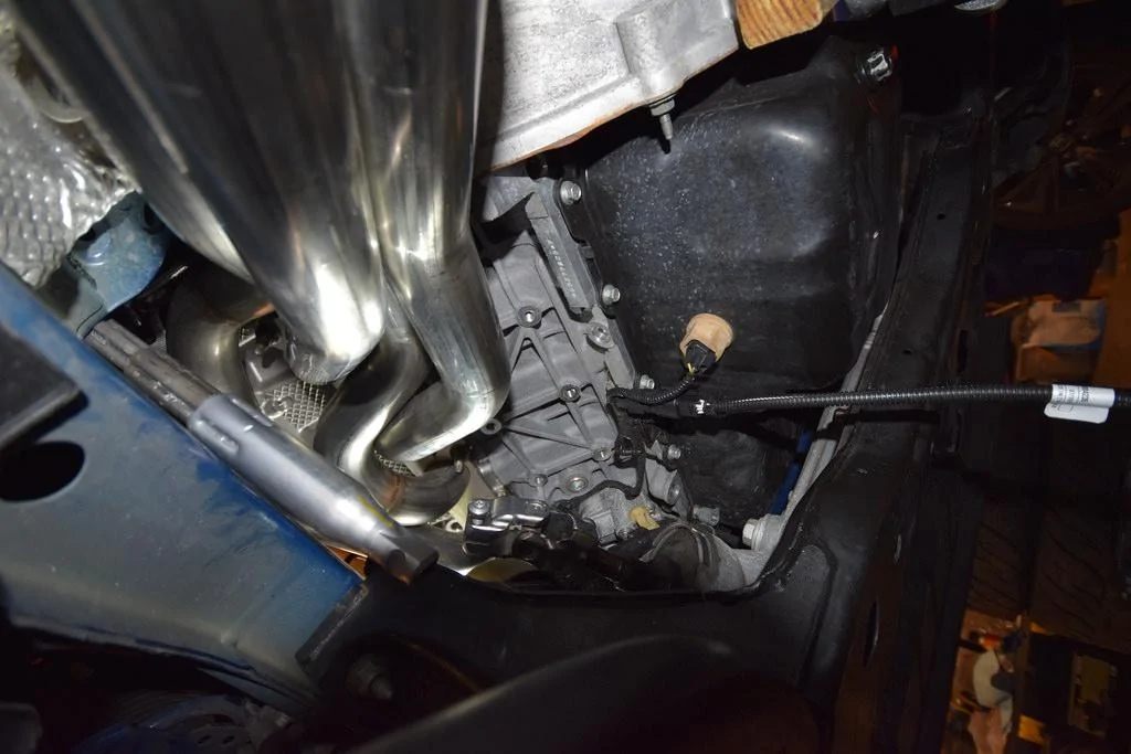

Within 2 weeks I had the roush axlebacks installed on the car, then x pipes couple months later:
2016-09-24 13.29.47 HDR

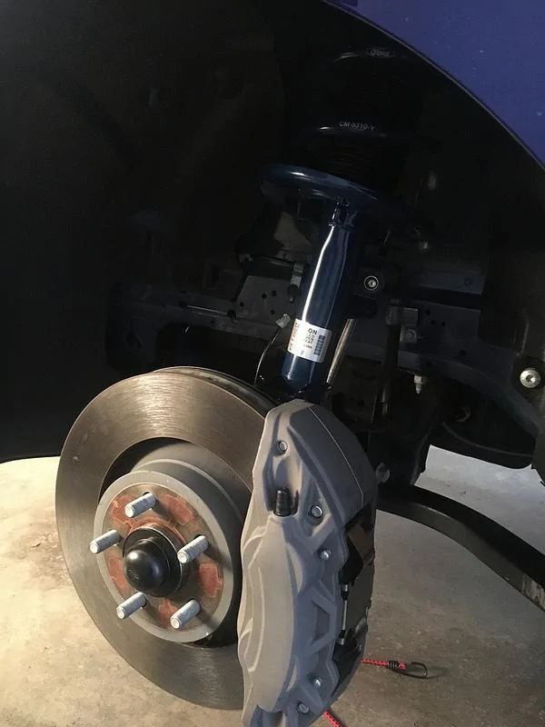

At about 10k miles the ford performance track handling kit went in. much stiffer than stock, and more low is always better!

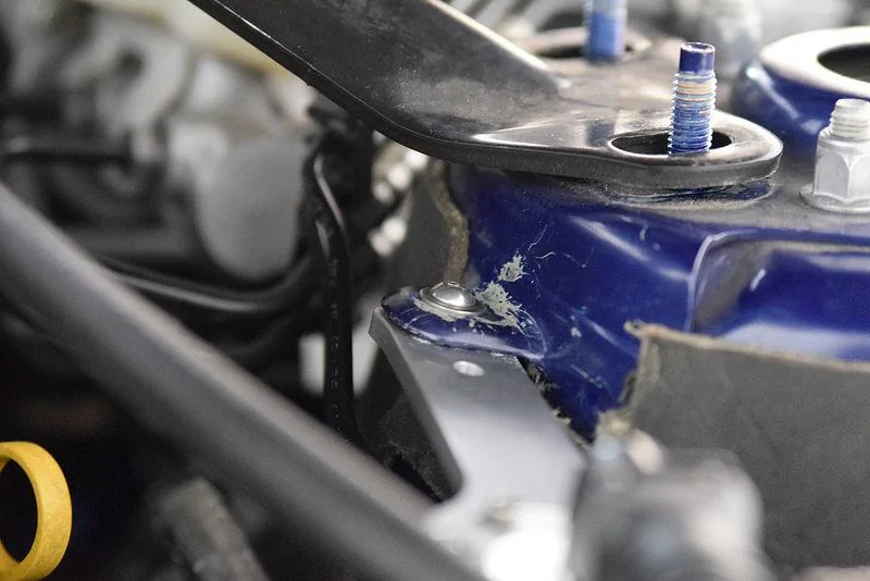

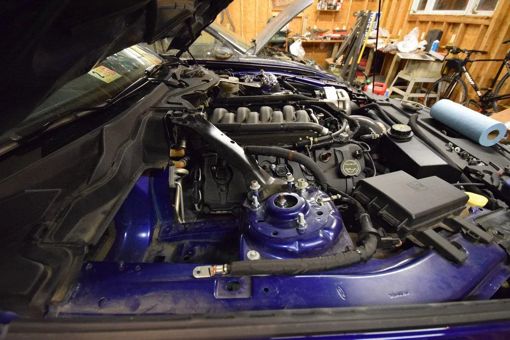

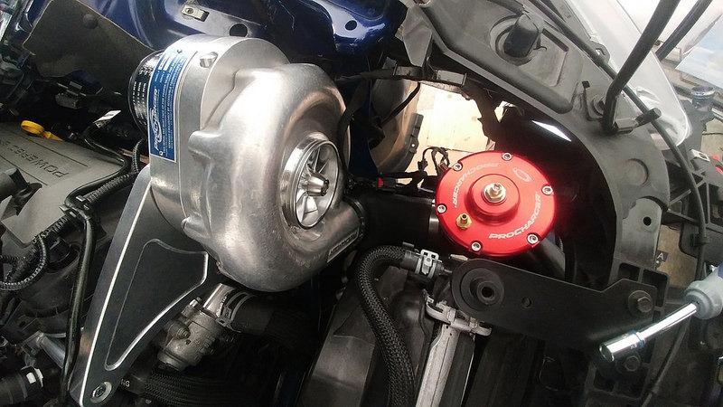

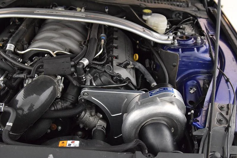

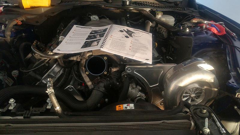

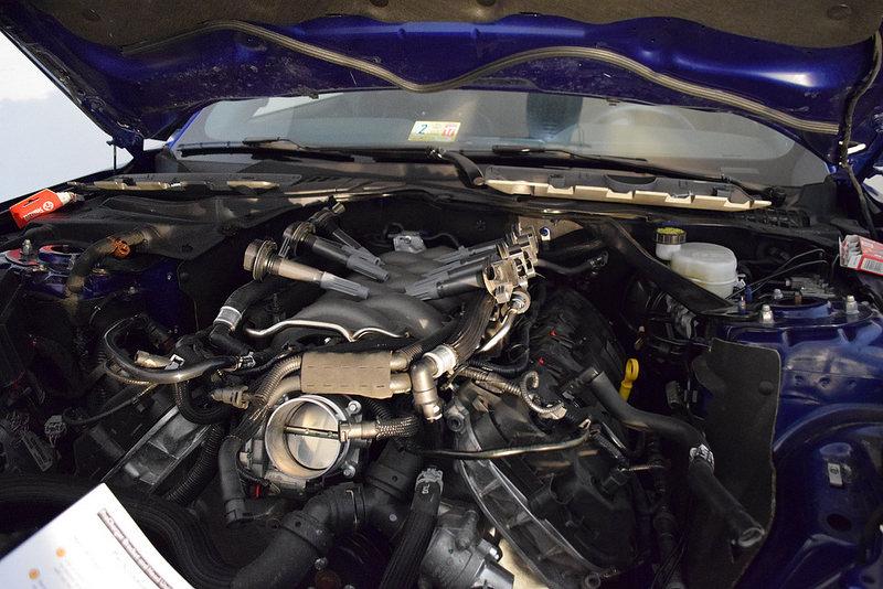

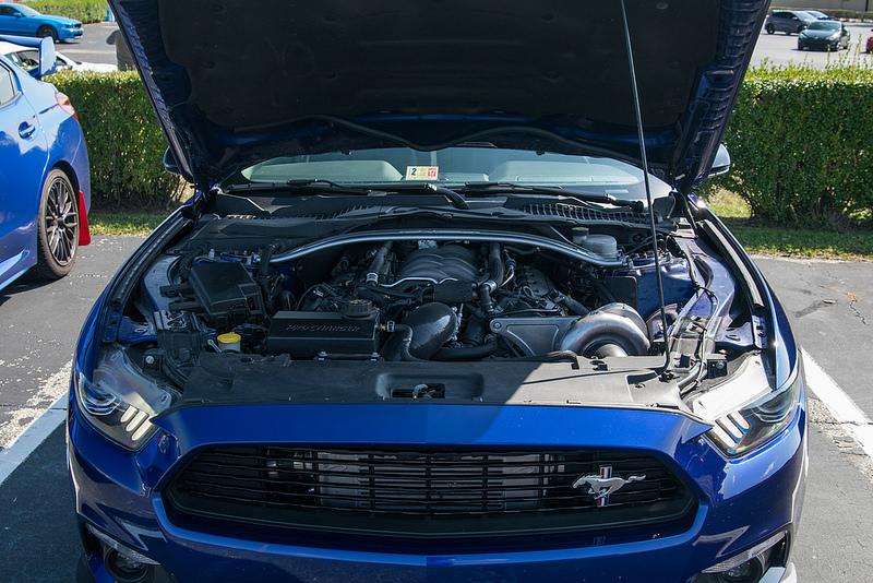

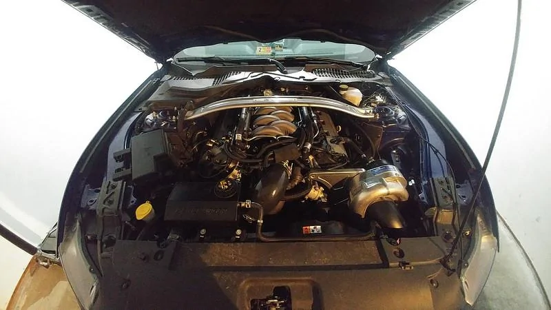

March 2017, at 20k miles, installed the procharger P1 HO complete kit. Pretty straightforward. Most difficult parts were the bumper removal, sound tube delete, and trimming the compressor outlet hose. All known points. One thing to note, is that for me I had to reclock the compressor housing about 10 deg to make the outlet hose fit better.
DSC_0114

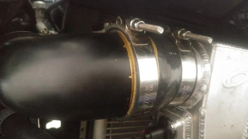

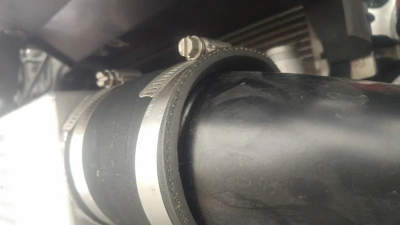

Next month, took it out to the local track. Second time at the ¼, ran a 12.9 @ 115. Now I realize I’m not the best driver, but something had to be off. Also was noticing a lot of false knock, and at WOT car wouldn’t command more than 13-14 deg. Took it apart and wouldn’t you know..
2017-05-05 18.58.15
Bought some generic t-bolts, and paint marked them to see if they’d move. It’s been about 12k since and both inlet and outlet hasn’t gone anywhere.
2017-05-05 20.10.31

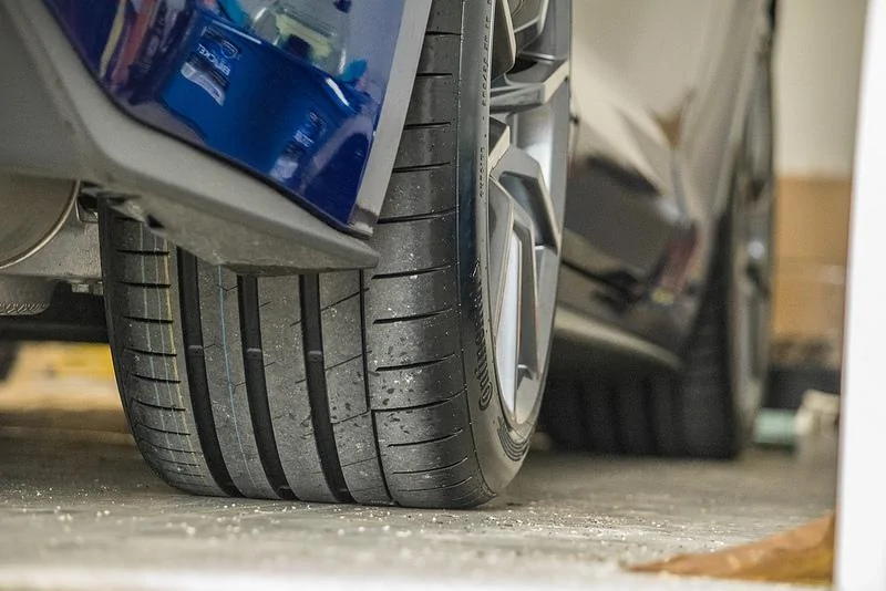

Summer of 2017, found a local killer deal on a set of MRR M350s. also found a killer deal on a set of new continental extremecontact sports. $550 for 2 275 35 19s and 2 285 35 19s. Great tires, but a 285 is a bit stretched on a 11”. Probably replace that with a set of 305 35 next year since rear tires were shot after 4k miles. And hopefully that’ll also give me that few extra mph at the ¼!

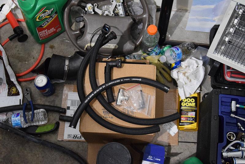

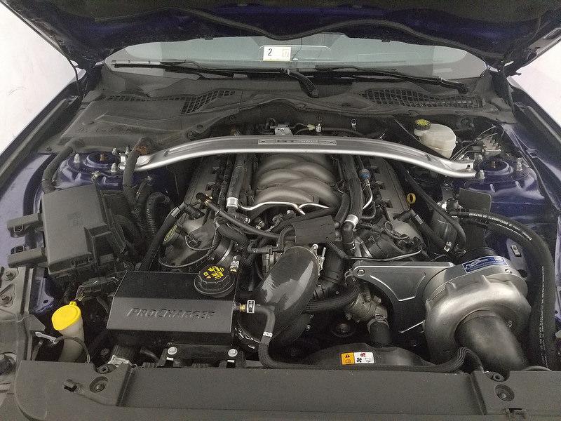

I've been meaning to get myself a catch can for a while, so when I saw UPR's system for a good price, I decided to jump on it.
Packaging was good, and the lines all come pre cut, although mine did not come with instructions, so had to do a bit of digging around.
Few things to keep in mind if you are planning on installing:
- you need to reuse the procharger T fitting that connects the driver side PCV to the IMRC vent.
- taking the old PCV lines off is a PITA. i'd suggest taking the inlet off the blower, as well as the driver's front wheel liner.
- the catch can mounts to a tab that comes off the strut tower. all the photos i've seen mount the catch can on top of the tab, but I could NOT get the thing to align. For me I had to use the bottom of the tab to mount the can.

after:

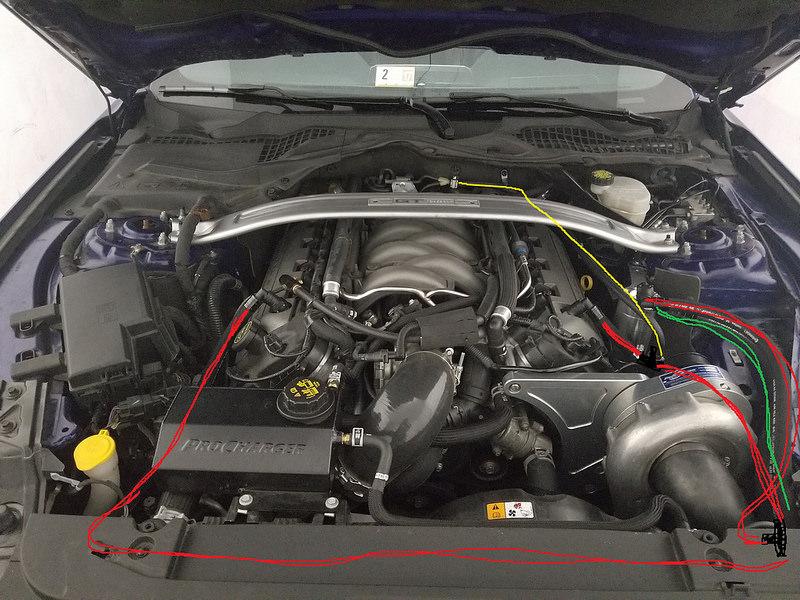

here's my routing. red is dirty line, yellow is IMRC vent, and green is clean (goes to the intake).

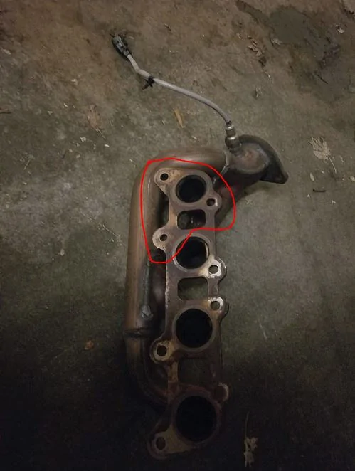

Dec 9 2018 Update!

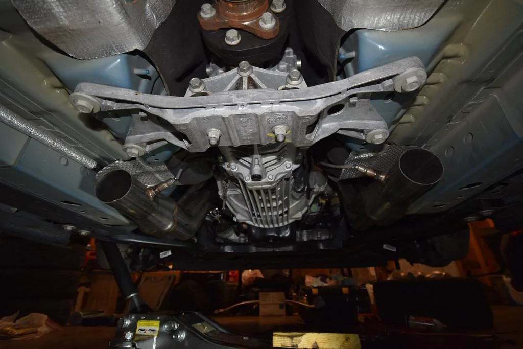

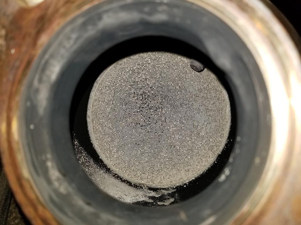

In the past couple weeks found out that I finally plugged my stock catalytic converters. My symptoms were:
- flashing CEL ('soft' random misfire P0300, no CEL on dash)
- loss of power after 5k RPM
- overboosting at high RPMs (10psi with a P1SC on a 3.7 pulley???)
So I pulled the passenger side cat (flanged side) and it looked like this:
20181125_194546 by Jae Choi, on Flickr
Thankfully, this was about the best time for the car to go down, because it was black friday week and there were all sorts of deals going on! So picked up a set of TSP catless long tubes and a Vortech BAP (didn't run one before!)

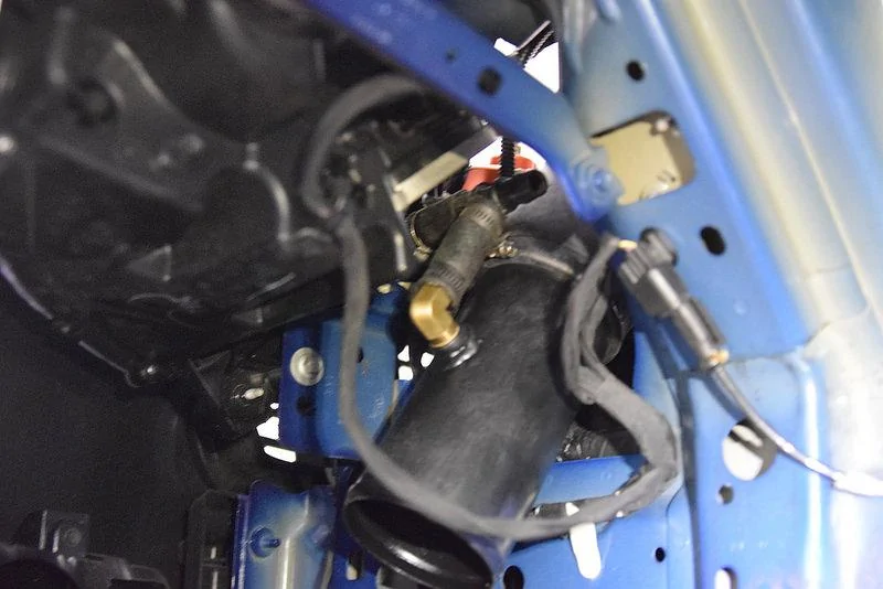

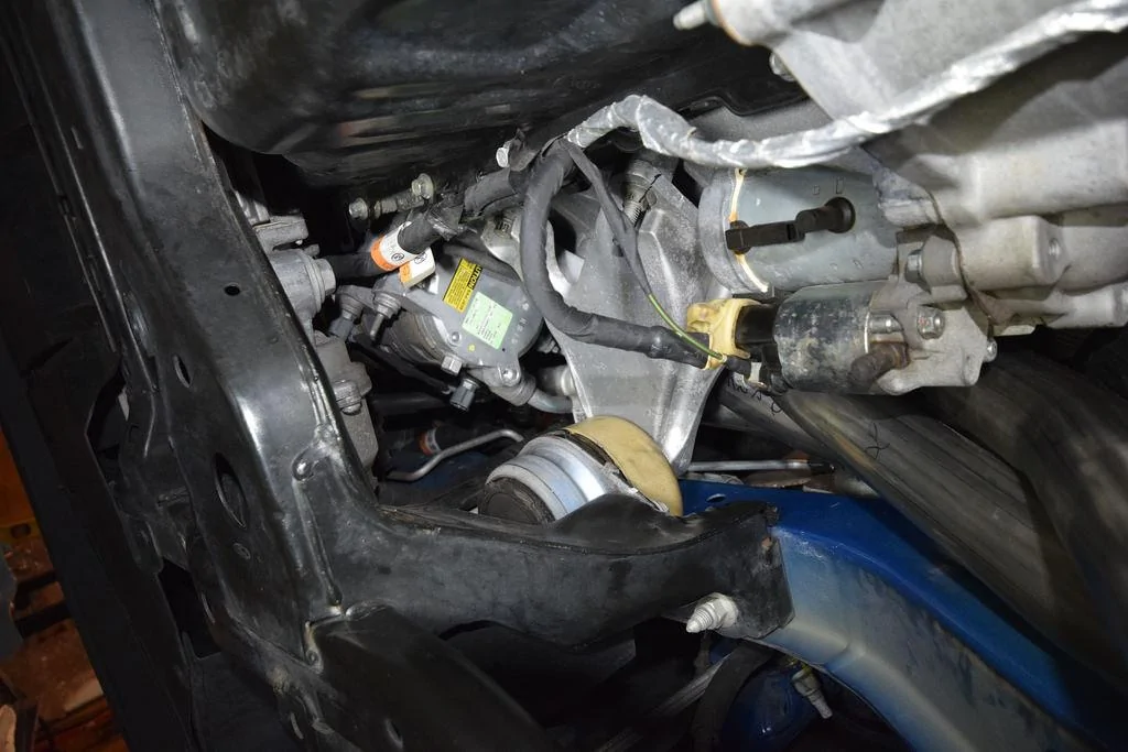

There's lots of documentation and videos going around regarding long tubes install so I won't post them all, but here's a few tips that doesn't seem to appear on popular how-to guides:
- Most headers come with header bolts, which requires you to pull out the studs. To me that's super sketchy. So I tried to remove the least amount as possible. I had to take out 3 studs for the long tubes, all on the passenger side. Circled are the studs I removed.
Capture by Jae Choi, on Flickr
- Remove the battery tray and the insulation! Makes it easier to get to the header bolt closest to the passenger side firewall. Also lets you reach the infamous AC stud easily.
DSC_0032 by Jae Choi, on Flickr
- Speaking of the AC line, I removed the bracket entirely and relocated the bracket to one of the extruding battery insulation bolts. At least, thats the plan. Currently it's zip tied to the positive battery wire.
- First time I dropped the motor back on the mounts after installing the headers, noticed that i had much less clearance to the frame rails on the passenger side than the driver's side. If this is the case, jack the motor up slightly, pull it towards the driver's side, then drop the jack. The motor mounts have slight adjustment built into them.
- Most writeups and videos I've seen, they were lifting the motor from the oil pan. It's a bit uncomfortable for me to do that, so I lifted from the bellhousing instead.

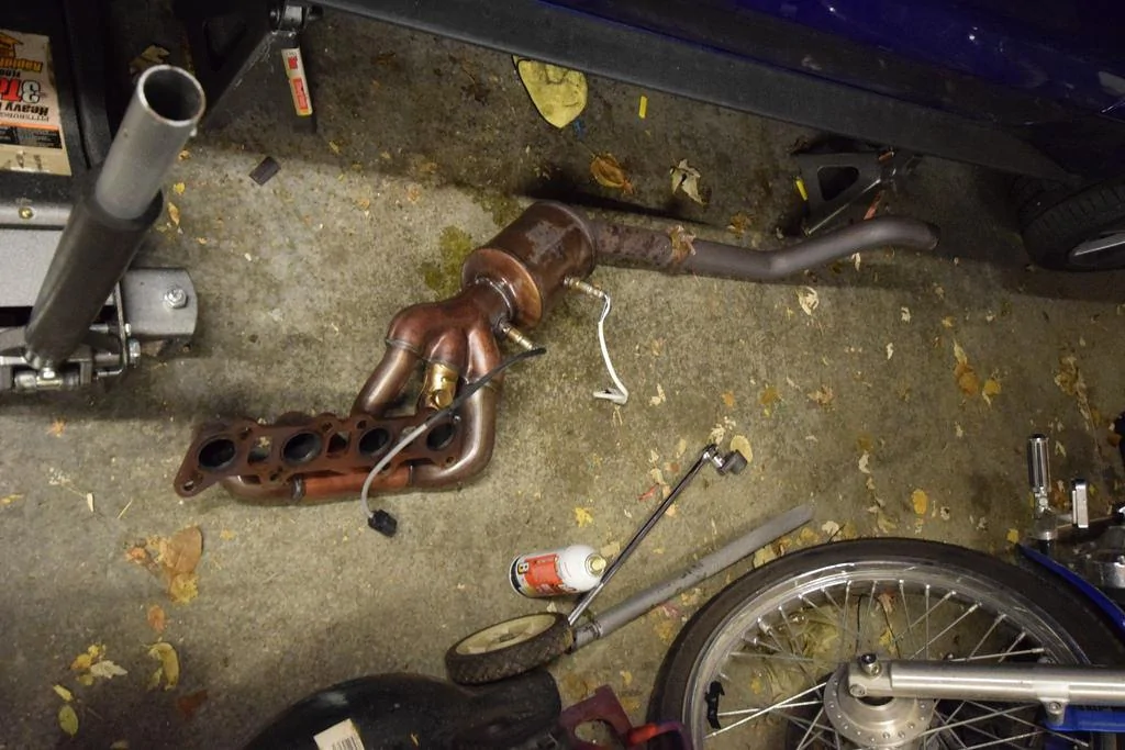

- Driver's side stock behemoth
DSC_0033 by Jae Choi, on Flickr
