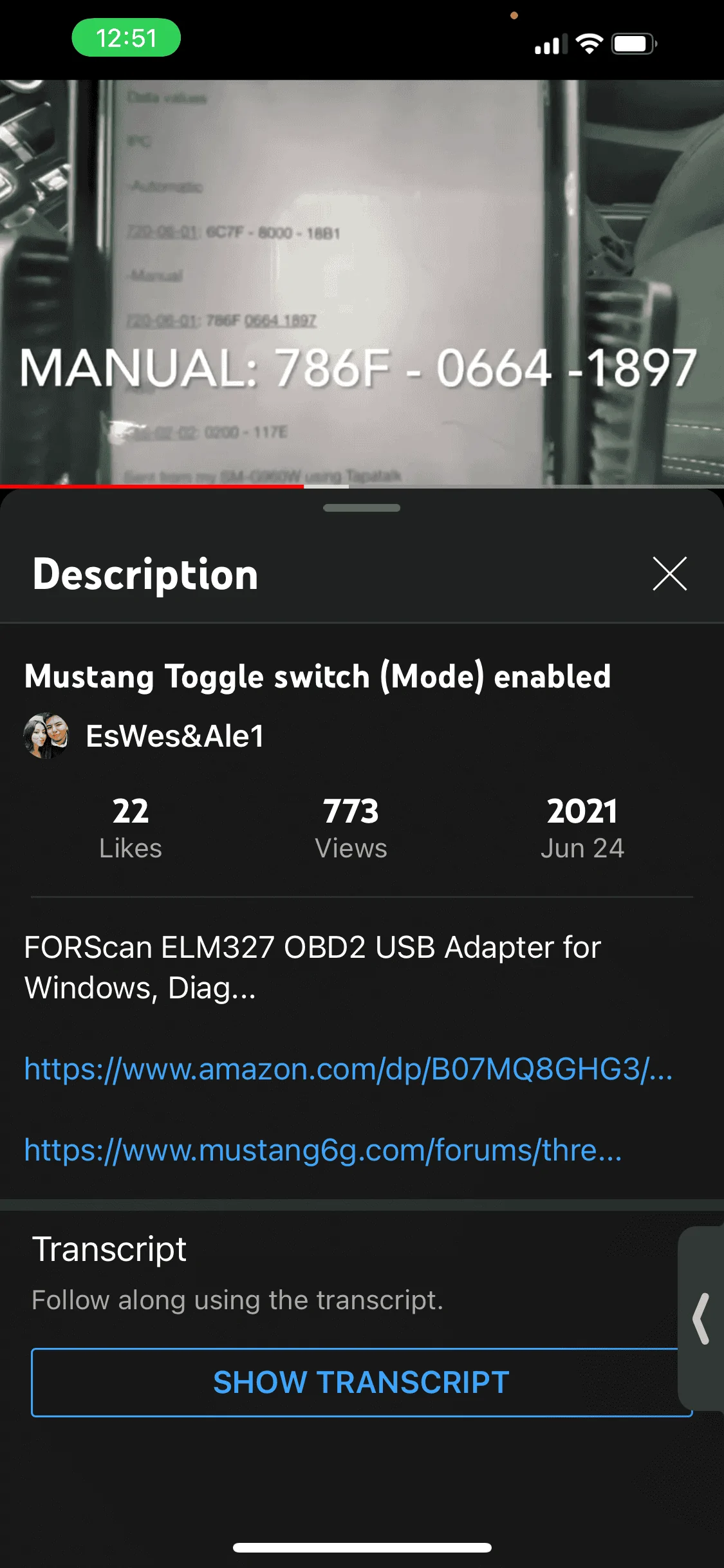

Hello, yesterday afternoon I programmed my 2021 base model mustang GT with FORScan to enable my mode switches. Upon doing that and following a video I saw on YouTube I noticed that the only mode working was drag strip mode. I made sure I put the Following numbers as the guy in the tutorial was shown. Since it’s a manual the numbers were: 786F-0664-1897. I didn’t not mess around with any other program and I also noticed that my line lock and launch control were gone as well. Wondering if I can get any help and see what I did wrong ?
