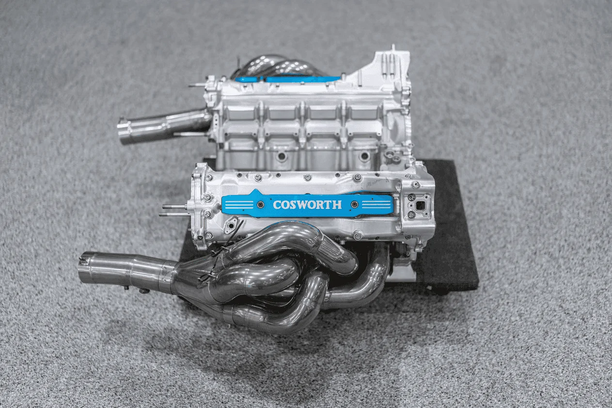

This high revving Cosworth F1 engine has very short headers.
https://collectingcars.com/for-sale/cosworth-ca-formula-1-engine-and-headers
Yeah, i questioned that after I wrote it. I did say depends on the gearing. F1 engines make a lot of power but have little torque due to their low volume, so ostensibly they're trying to shore up the below peak torque. I'm unfamiliar with the gear boxes for F1 or Indy cars.
Point is, primary tube length adjusts the curve, diameter moves the peak.

One other thing I'll point out is the collector on that Cosworth is only slightly larger in diameter than the primary tube size. It also has a stepped design so ED was probably wrong on his disdain for stepped tubes. Like I said I never tested this. If I get the chance I will.
Stepped 4-2-1’s and collector Choke design.
Calvin Elston is a Wizard.
