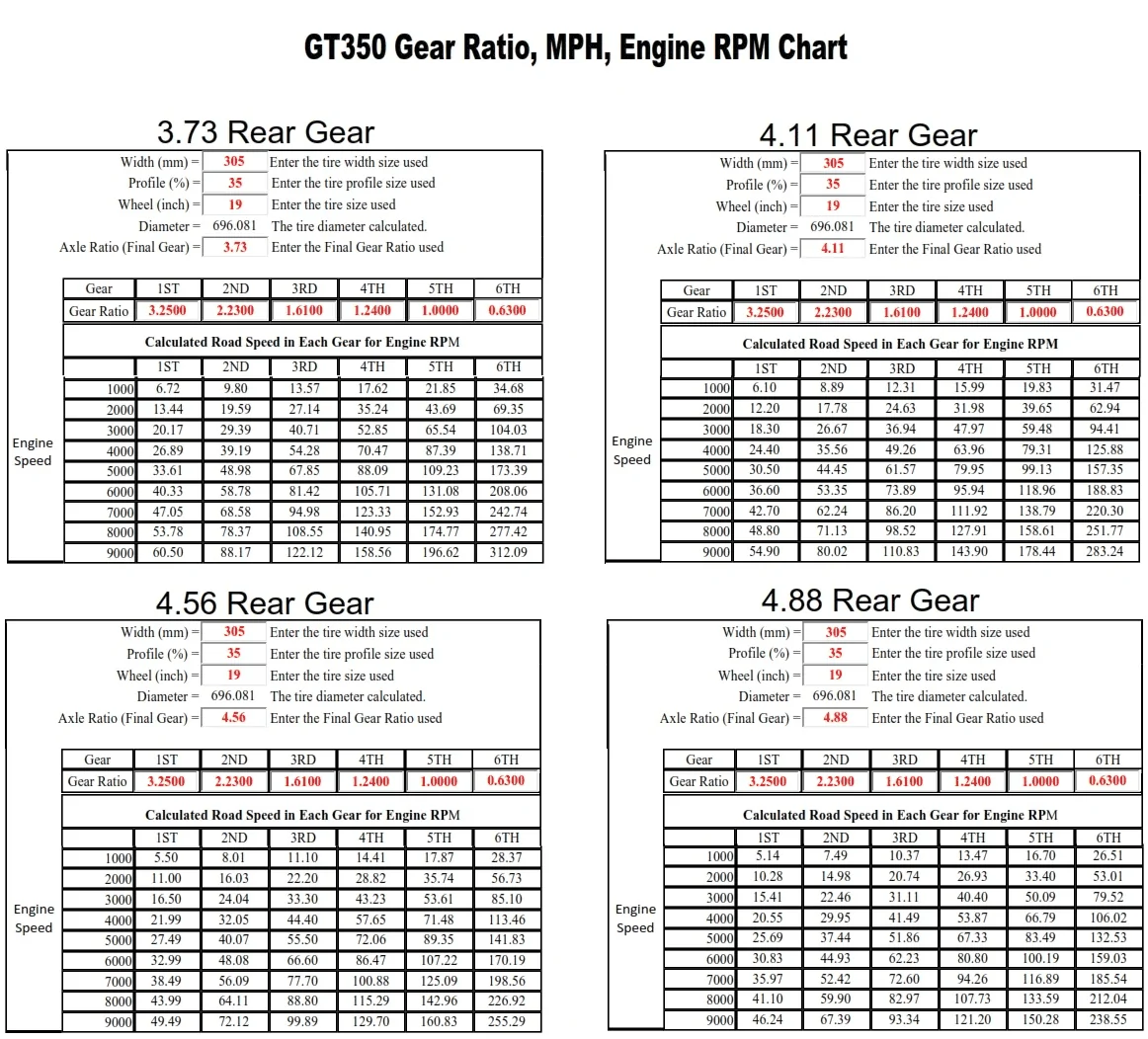

First of all let me say that I am ordering a new Mach 1, manual transmission. So, I am excited about the stick.
But the gearing is very close to the Bullitt. If Ford uses the gearing from the Tremec in the Gt350, overall comparative gearing looks like this:
Bullitt Mach 1 Difference Mach 1/Bullitt
1st: 3.237 3.253 100.5%
2nd 2.104 2.233 106.1
3rd 1.422 1.611 113.3
4th 1.0 1.243 124.3
So, you can see from this that the equivalent final ratio of the Mach 1 vs the Bullitt would be having a 3.75:1 axle out of the hole in 1st. No real significant difference.
This is why most folks are going to have a very difficult time doing more than a 12.5 in the 1/4. When I was at Milan, there was a guy there racing his GT350 and just barely got under 12.5. He had drag radials as well.
It is the launch with the long gearing that makes it so tough. That said, my likely ONLY mod will be replacing the gears in the axle with 456 or something like that.
