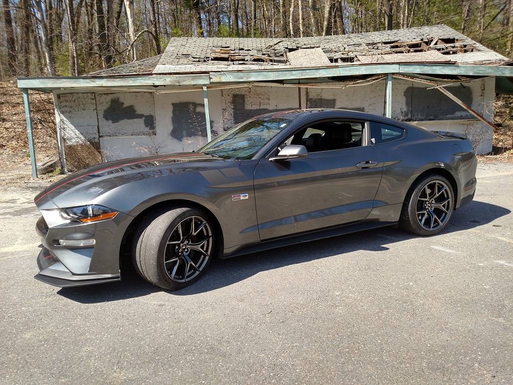

Hey, nice pictures. I am also looking for lowering springs for my car and tending towards Steeda, want a little close to 1 inche drop. Can you tell me how much drop did you get with the lowering springs, on the site they say about .75 inches. Also, wow is the ride compared to the stock springs?
Steeda is a really good company to work with, their support team is always super helpful when I call. Basically the sport springs will lower the car near 1in, but you'll give up a little performance with the softer springs. The ultimate handling springs are really designed to aid handling performance, but you ultimately only get about a half inch drop.
Most people wont notice the ultimate handling springs because the drop is so minor, but it does give the car overall a more aggressive/flat stance (and the slight drop). However, I'm blown away by how well they perform and drive. Plus, I was hitting the front lip all the time on stock suspension so I really didn't want to lower the car that much. Ultimately, I'm very happy with the ultimate handling springs.
