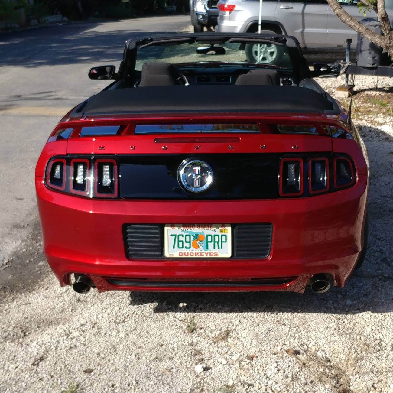

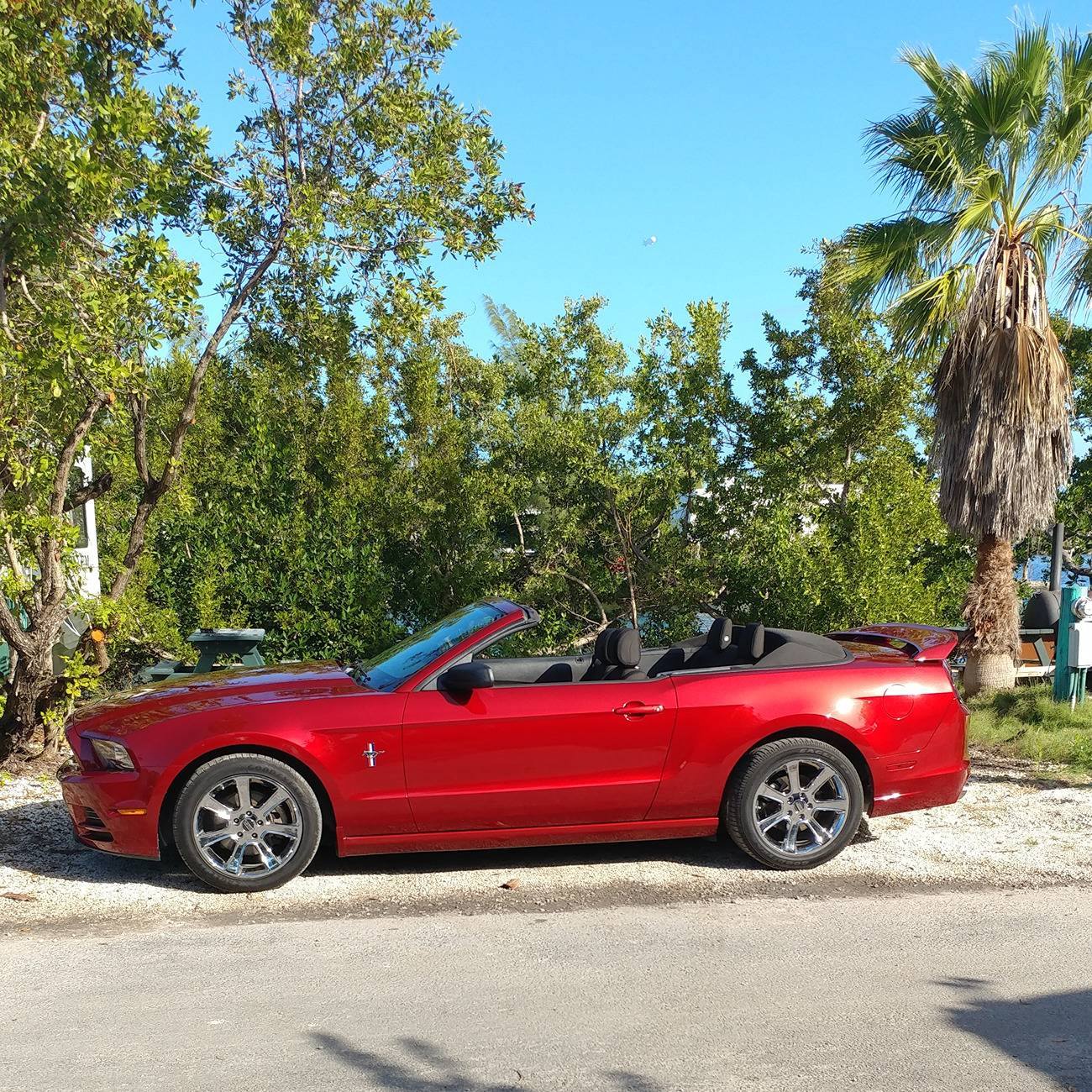

When I had my 2014, I installed a California Special wing on it. Looked great in my opinion. I know it's not an S550, but I was told I couldn't install one on my S197. Surprise, it works and looks good too. P.S. I did drill holes in the decklid.
