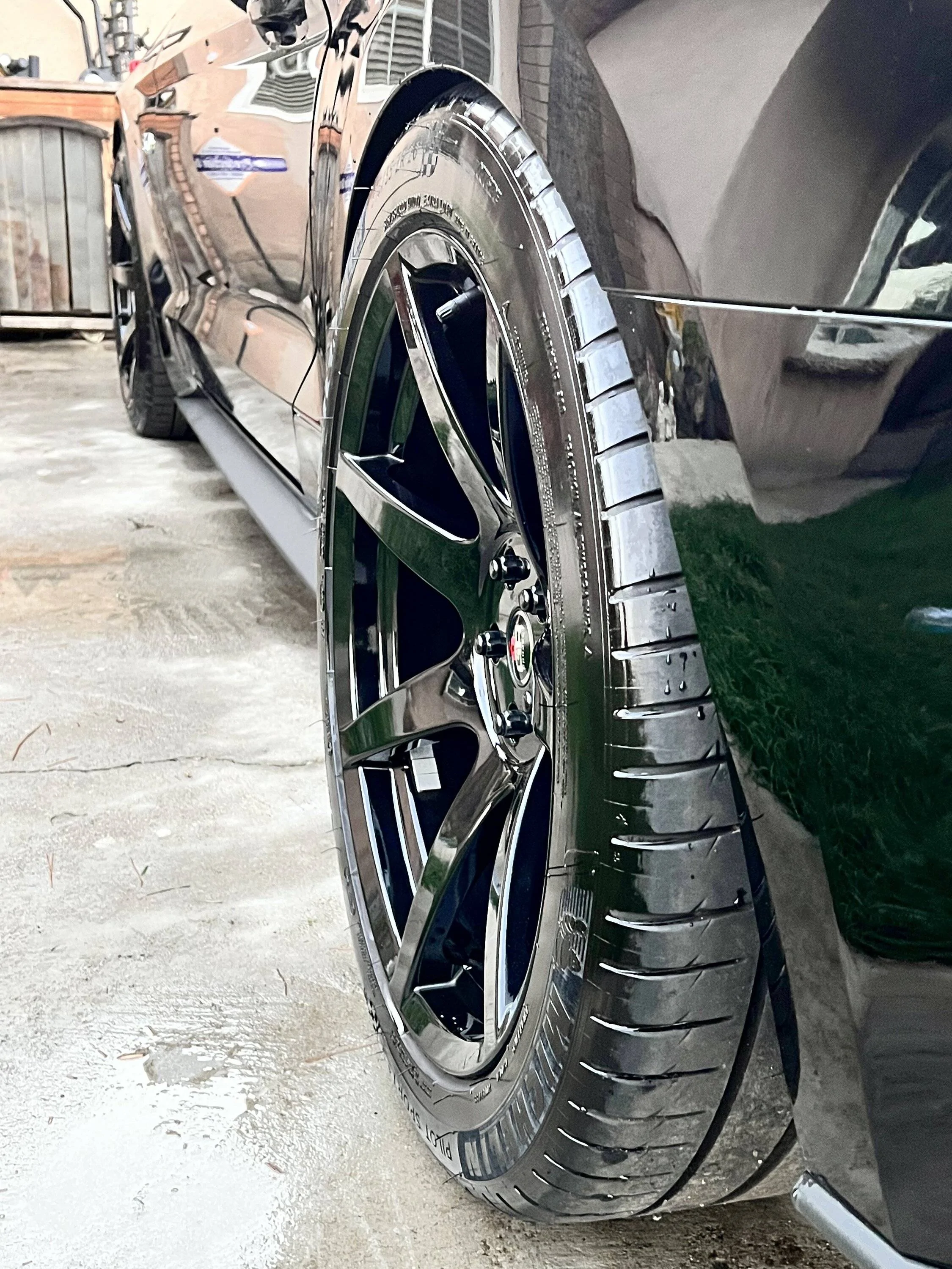

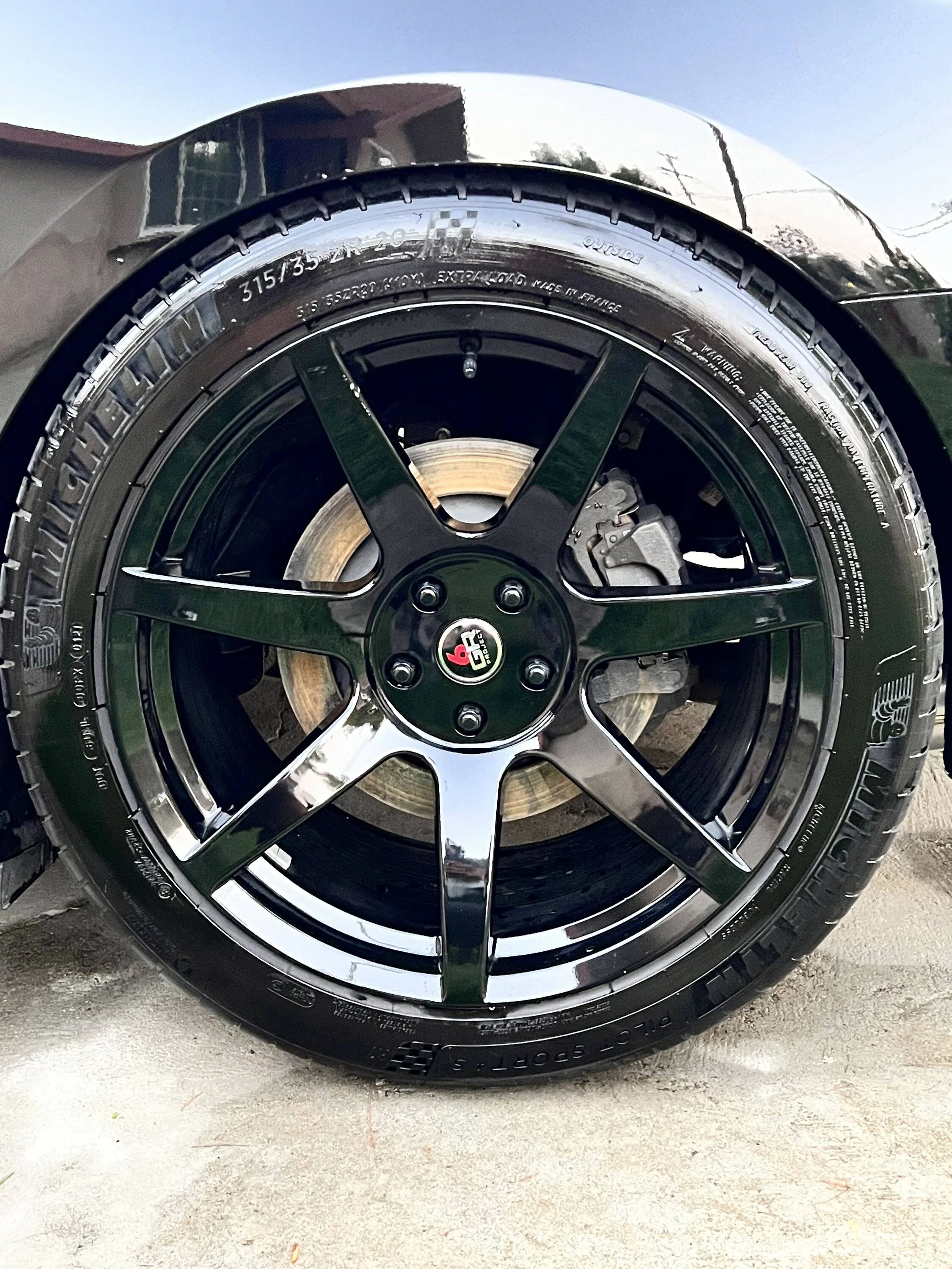

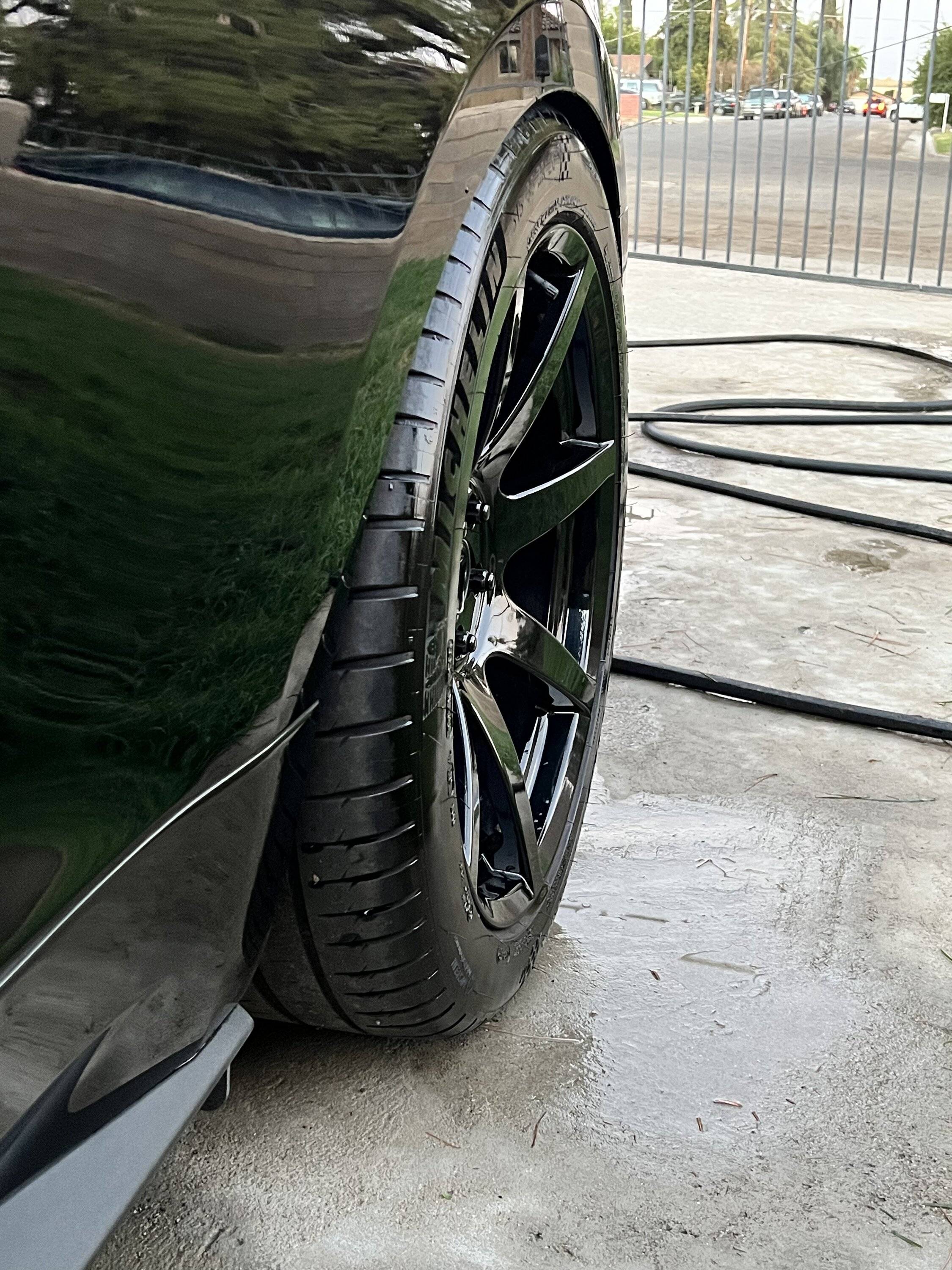

I’ve got steeda 8242. Paired with MPS4S 315/35/20 on project6 GR SEVENS. Love the stance. After the springs broke in, it dropped a tad bit more. I am barely fit a finger inbetween the fender and tire. Hope this helps.
