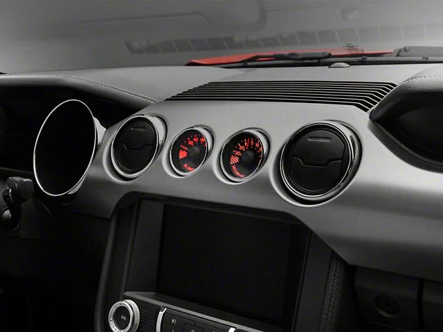

Guys I'm looking for the part number for the performance pack dash panel. I want to add the gauges to my 17 GT premium but having trouble finding the dash panel. Tried eBay but everything seems to be the version with three vents.

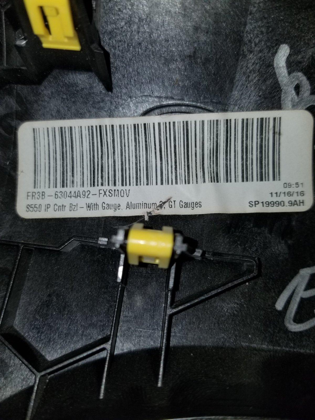

I found the dash on ebay by searching 2017 mustang dash. Most of the used part sellers on ebay just list it as a dash trim panel. If you search ebay using the part number you will get new parts from the dealers which are expensive. I paid $100 for my used panel about a week ago off ebay. Ebay has them but you have to keep checking because they go quick.
You may want to check behind your radio for the connector because I have a 2017 GT premium w/auto and I did not have the connector behind the radio for the gauges. I have parts on order to tap into the wire harness but not sure if I want to do that just yet. Pick below shows back of the dash panel with part number.
