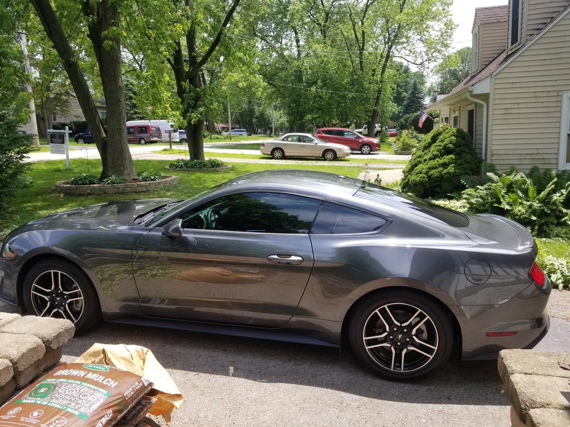

I have not been able to find anyone who had powder coated the stock ecoboost 18" rims. Is there any reason for this? I feel like I might be missing something.
I'm going to eventually get new wheels but I want to powder coat these black till I wear the tires out and then keep them for winter's. Im looking to do all gloss black. Anyone have any experience with these wheels?
Thanks
