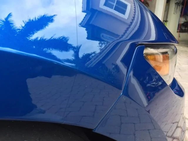

I had PPF on the front end and I put CQuartz on top. If you have ever worked with CQuartz, check one of the used suede application cloths after 24 hours. It's as hard as a rock. I like having that level of protection from bird poop, acid rain etc.
While it won't prevent chips, like a PPF, it puts a hard shield on your paint that will last up to 2 years (3 if you have a garage queen). I think I paid 85 bucks for the 50ml bottle and the "reload" spray. Well worth the 85 bucks.

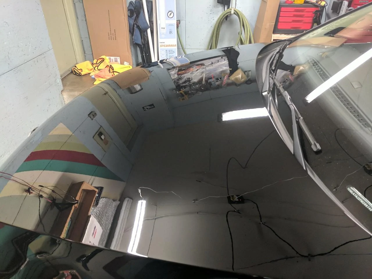

Like everything else in car care, the prep is the key. Using a clay bar and a paint correction compound with a D/A is mandatory. I just spent 4 hours doing the hood of a new Jetta last week. It was Black and the dealer screwed it up horribly during PDI. It came out pretty well. I then had it wrapped with PPF and will be doing the CQuartz later this week.
Here's what 4 hours with a D/A and a paint correction compound can do. This is post paint correction. There is no PPF, Wax or sealant on this.

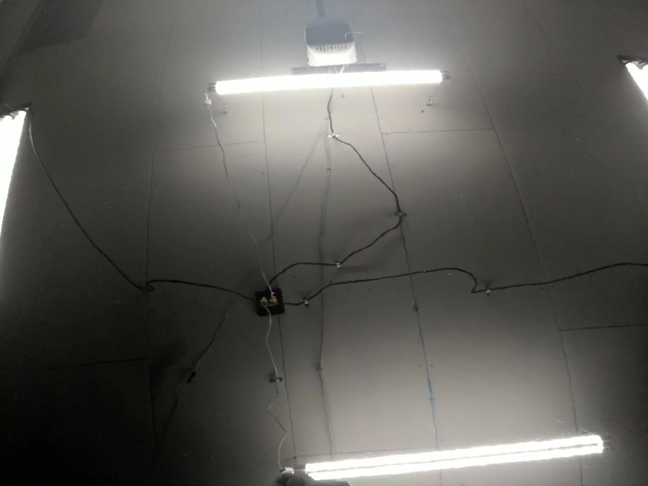

Mike, you need to fire your electrician. Nice work on the paint correction however.
LOL! Yes, that has not been a top priority for me but I knew when I took it that I would get those comments. Should have known it would be you, Tom :cheers:

I was a former IBEW journeyman electrician. Then one day I was stupid and took a flying lesson. :doh:

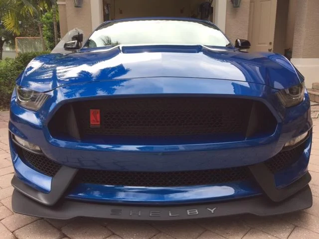

At least it's starting out good! This Xpel stuff goes on nice. If I can do it in the dark in a thunderstorm, it ain't that hard! More later ...

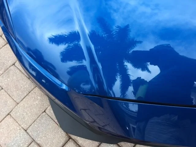

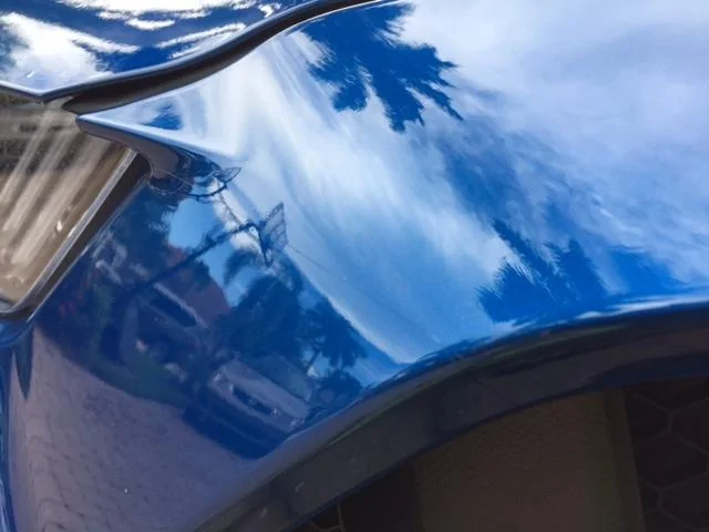

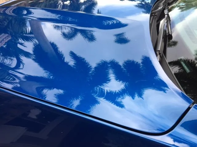

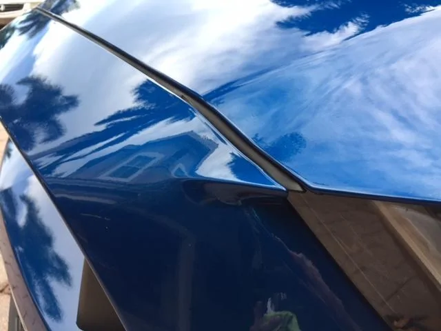

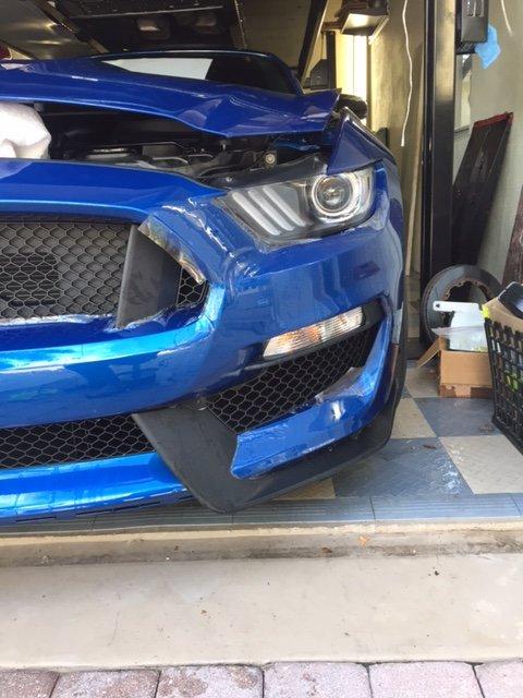

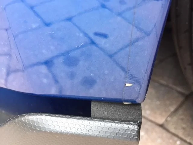

Two full days later I finished my install. Also got the splitter on and a couple Ford racing catch cans.
I bought the xpel product to apply to the film and cquartz to do the rest of the car. I expect to have another day in the paint coating. Then I'll take some good pics and it will be all downhill from there :cheers: I will say that front bumper is no joke to get on the car. All in all, I have learned that the install pros earn it when doing this work! It takes artistry. I'm pretty happy with my DIY result but I do have some minor experience. 15 minutes to do the A pillars and about a 10" strip on roof but all damn day to do the bumper and surrounding parts. I have a few minor flaws but none that will motivate me to redo anything. One day in the sun has resolved much of the little fluid pockets. I was going nuts on a couple dirty fingers when I realized they were the factory install bits on the wheel arch. :) Anyway, my driveway install is just proof that, like any hot rodding, some prep and trial and error can get a job done. Next one of these jobs is going to "clear bra George" down the street. My back hurts! PM me if you want more info.

Congrats on the install and sweet looking car!
And thank you for making me feel better about paying to get mine done. That sounded like it really sucked to do and would've probably taken me twice the amount of time.
