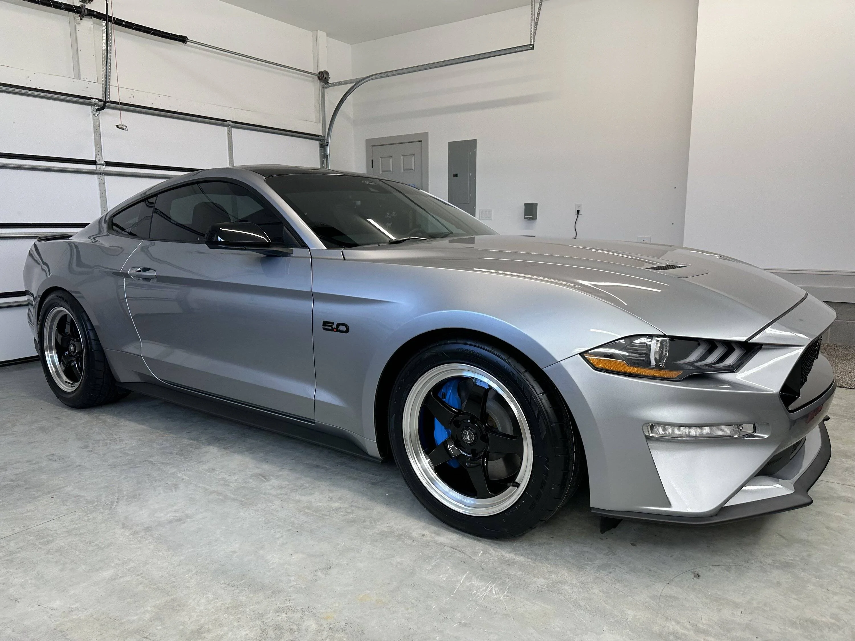

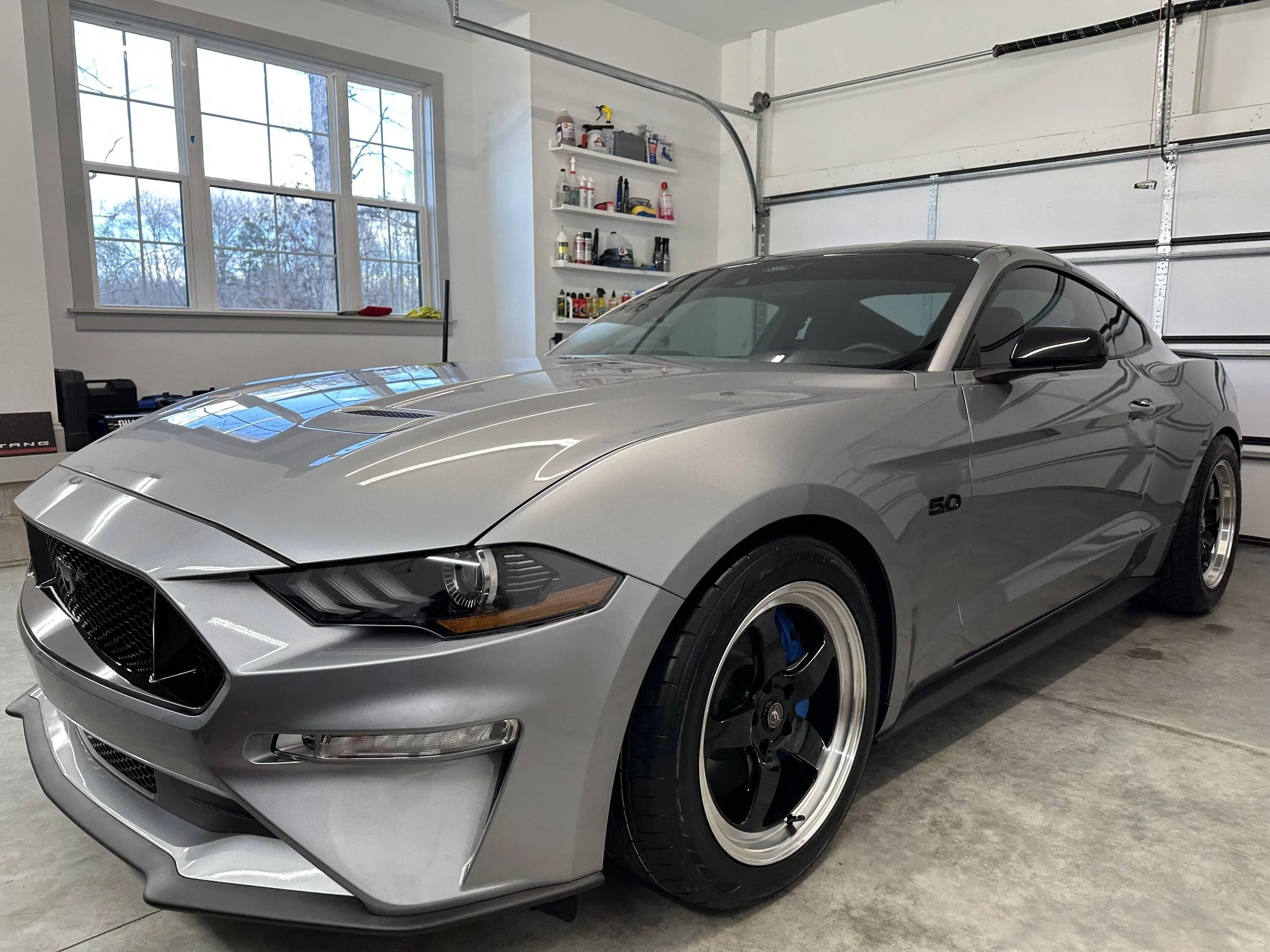

I can finally play in the aftermarket wheel game...ForgeStar D5 18x9 front 22mm offset and 18x10 rear with 42mm offset. Fitment is 100% flush. Tires are Nitto 555 G2 255/45/18 front and 295/45/18 rear.

WOW, the new combo looks amazing!
Any rubbing in the rear when the suspension cycles?

I plan to drive it to work tomorrow and see if there is any rubbing anywhere, but I don't think it will. We will see though.

Simply gorgeous. Those blue calipers are a perfect contrast too.
