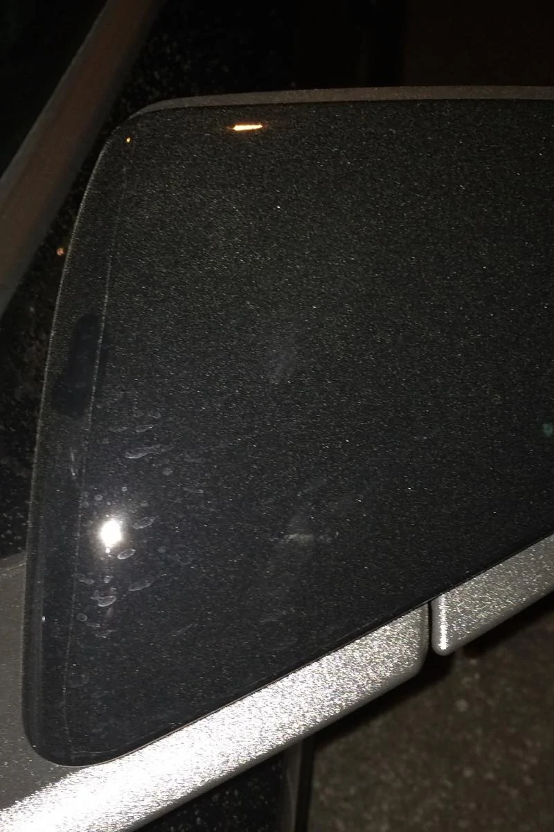

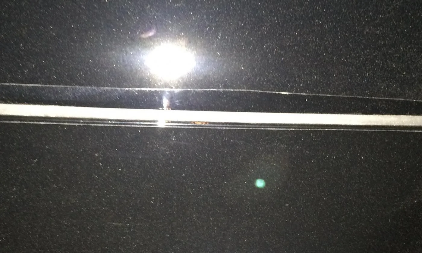

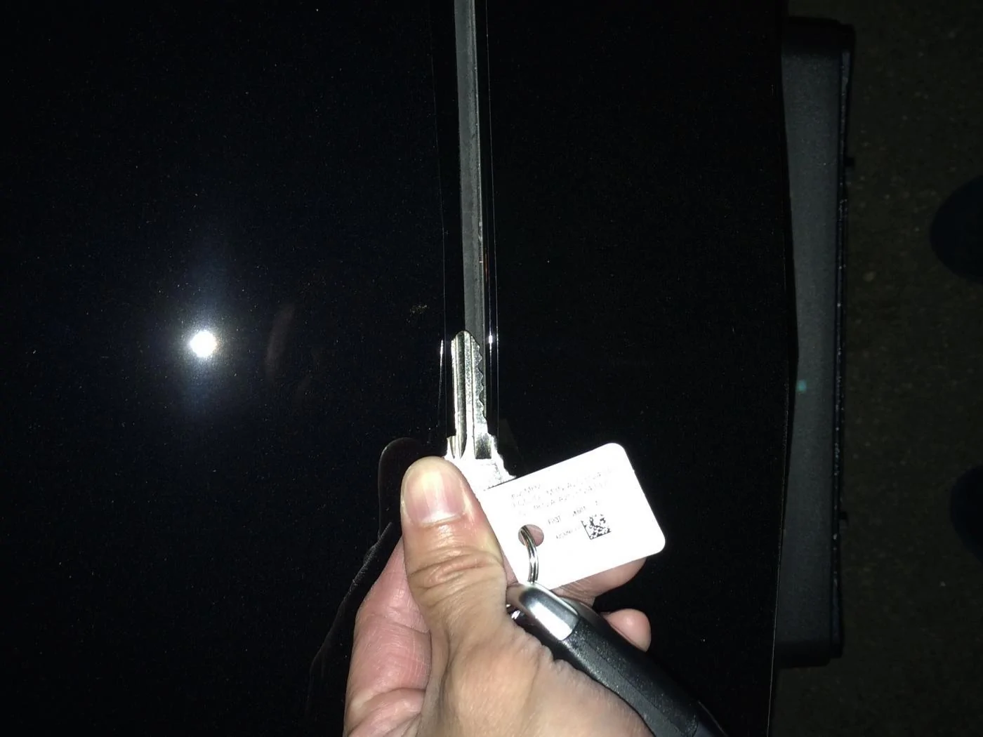

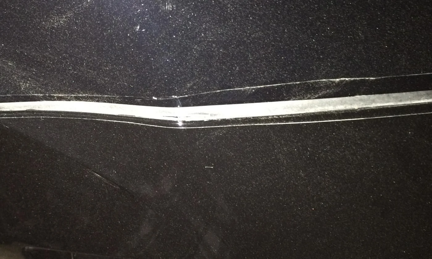

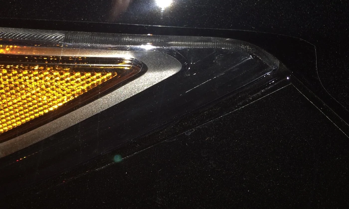

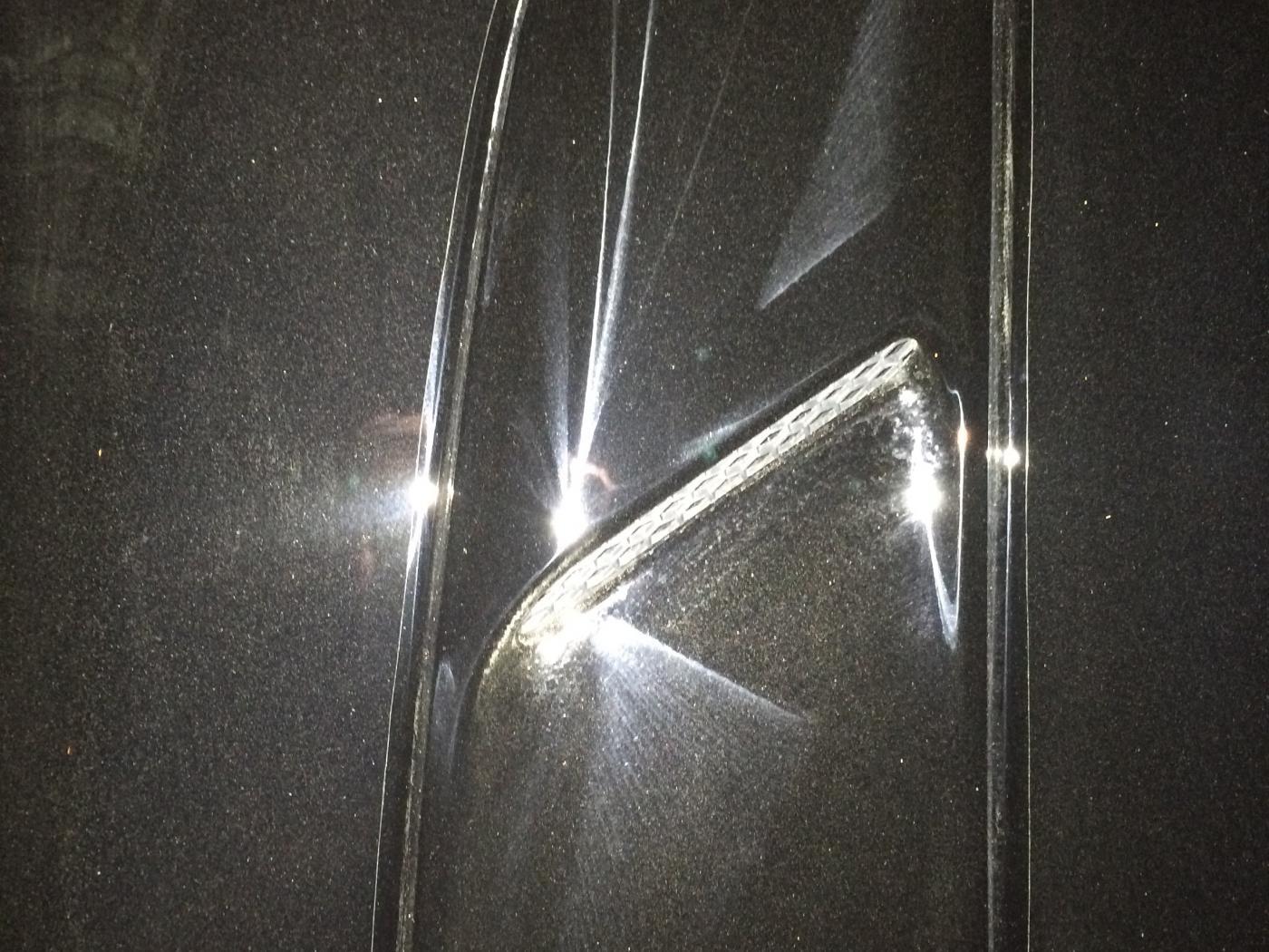

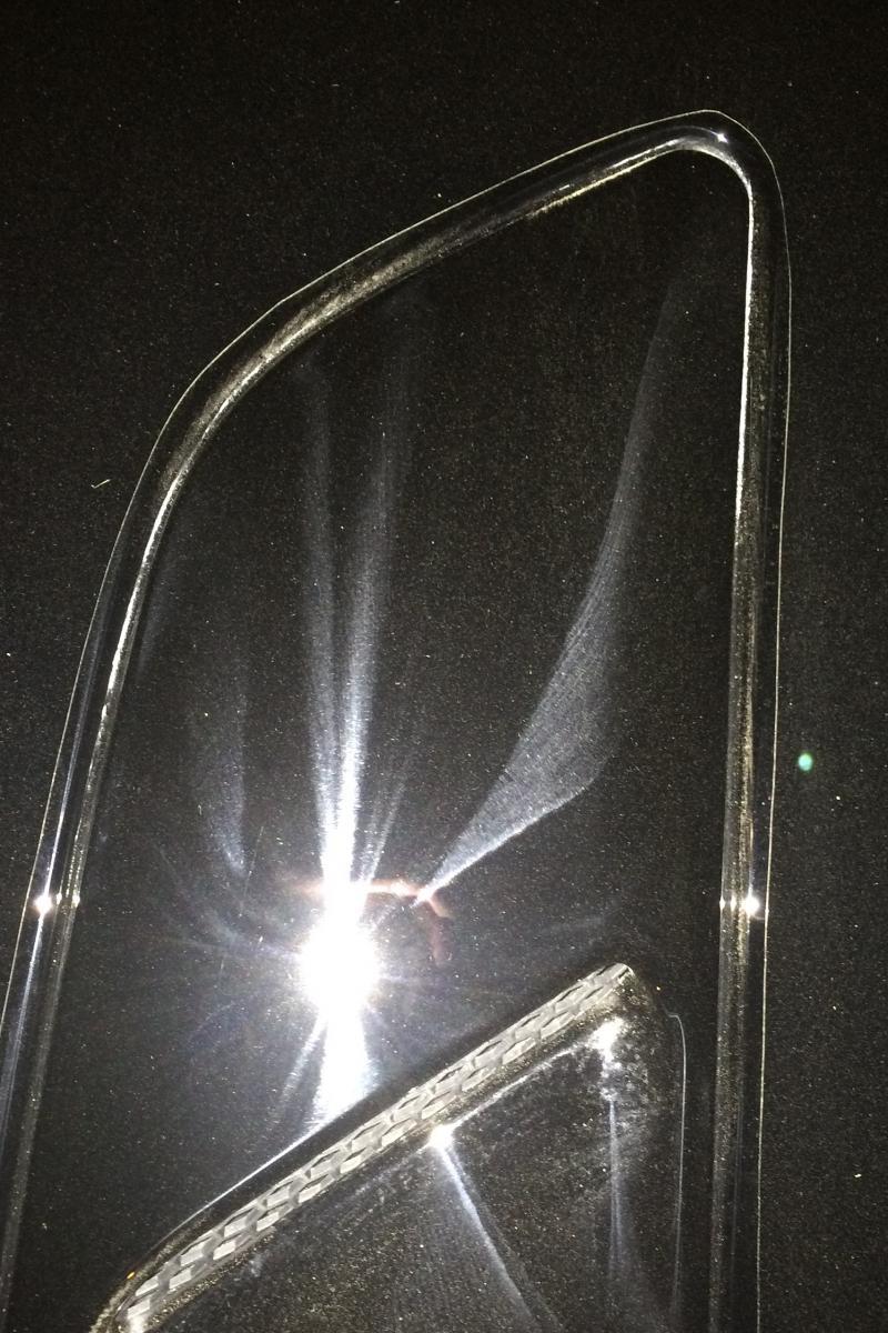

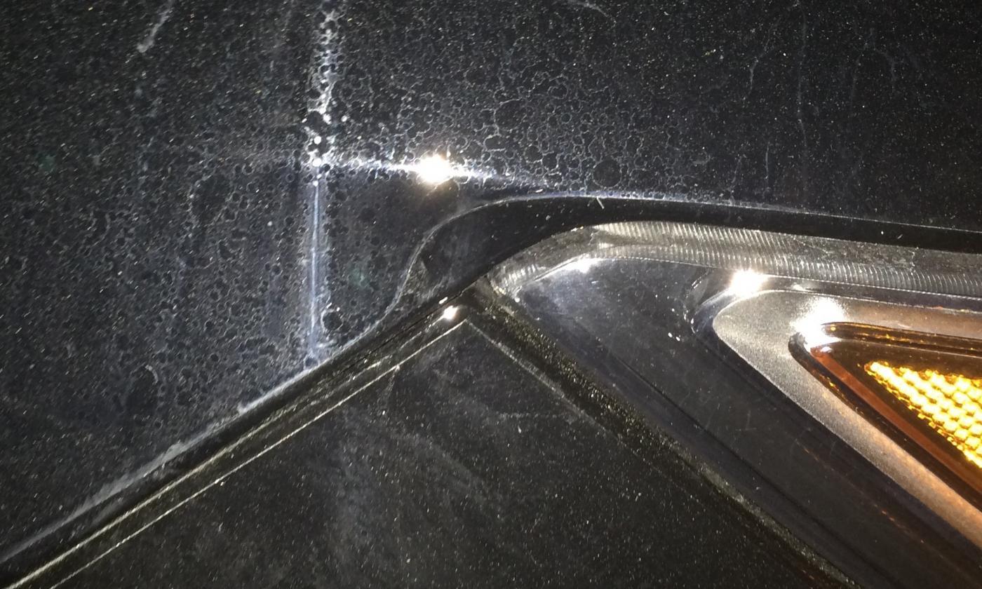

I just took a closer look at the clear bra installation quality on my car and it looks bad. It's not just the hood, but other places as well. Here are some pics. Mirrors (though I don't know if the installation area is common practice), heat extractors, fenders, etc. Please let me know if you guys thinks this is quality work. Please let me know if I should have it reinstalled. Is there another way to fix this other than reinstall?
This is supposed to be a reputable company in town. I was recommended to go to these people. I saw Vettes and 911s on their lot. What could have caused this (assuming it is as bad as I think)?

Clearbra is usually cut from templates from the company. Most templates do NOT wrap around the edges, which is sometimes fine. Only time you really need it to wrap, is around the hood.
1st picture: Either template was bad and caused that big curve gap OR lazy cutting.
2nd picture: Over stretching material resulted in wavy ends.
3rd picture: Very poor cutting of the edges.
4th picture: Again, probably was a template. Mirrors also require a lot of stretching, to avoid fingers and as a result you got wavy lines.
Overall, yeah it is pretty mediocre. At least there is no dust or dirt that I see though.
