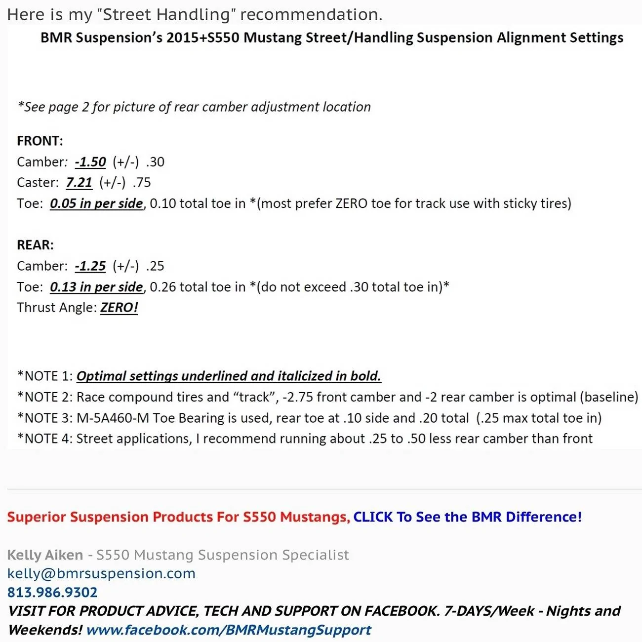

Hi,
If anyone is running front 20x10 +40 wheels with 285/30 tyres, would you be kind enough to share a few pictures, especially the side profile ?
I consider any part of the wheel or tyre that protrudes from the arch (at the top) to be poke, and I don't want any poke - I'm hoping the above size gives a flush (or very slightly inset / tucked) look.
I don't want to be running an excessive amount of camber to get the look that I want - I'm targeting this kind of alignment :
Thanks in advance
WD
