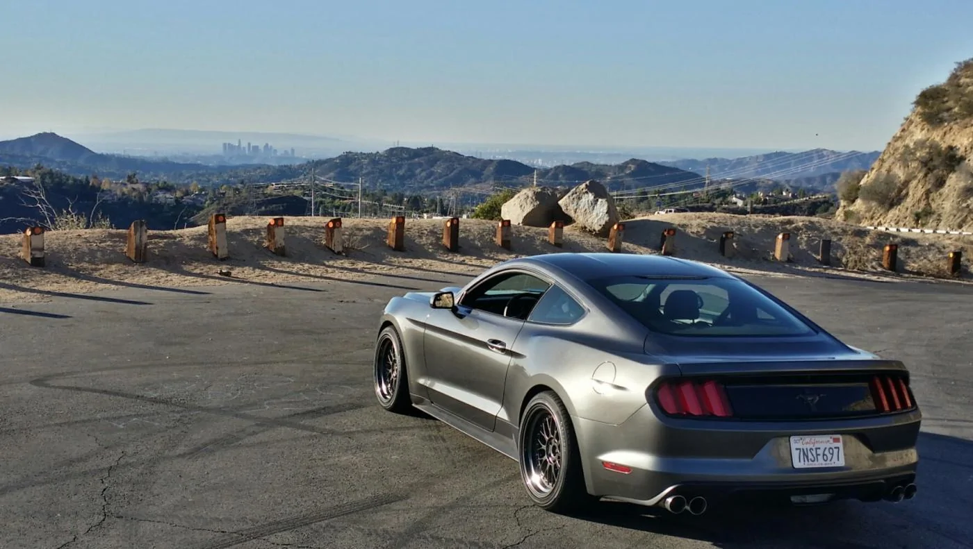

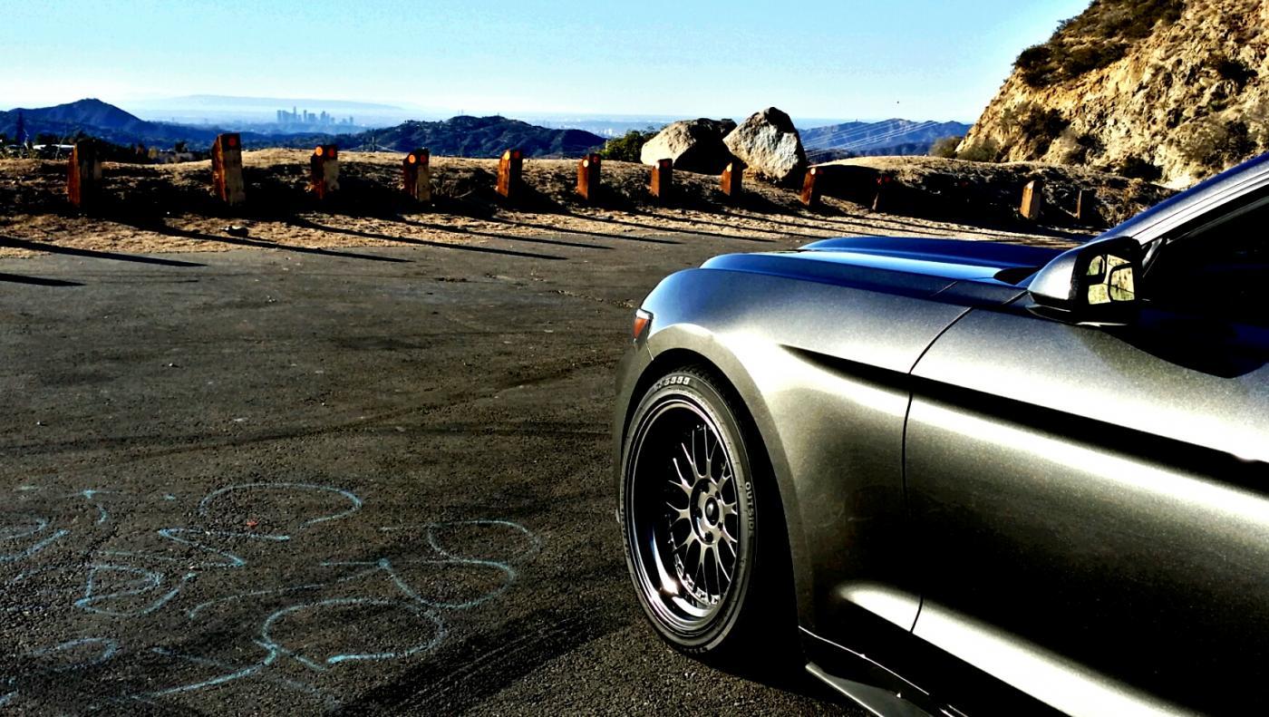

This is what i have. Xxr521 18x10 et25. Very affordable and very light. My last mustang also had these. I love them. Im running 285 square

Fordguys550, great looking ride with awesome wheels. I really enjoy reading about your mods. If I understand you correctly, your wheels weigh very close to your originals, 17's I believe. Can you please provide some details of the weights of the wheels as I have never seen those numbers posted. with and w/o tires if you have that data. Thank you!

Thanks! The wheels are about 22lbs without tires. :)

Very nice and the weight is minimal. Can't tell, these aren't poking at all are they? Also do you have a shot of these down along the length of the car?
