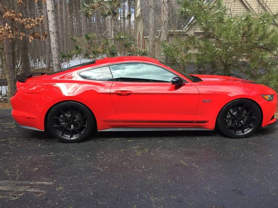

It is all about looks.
My aftermarket 20" wheels and tire weigh less than the OE ones.
