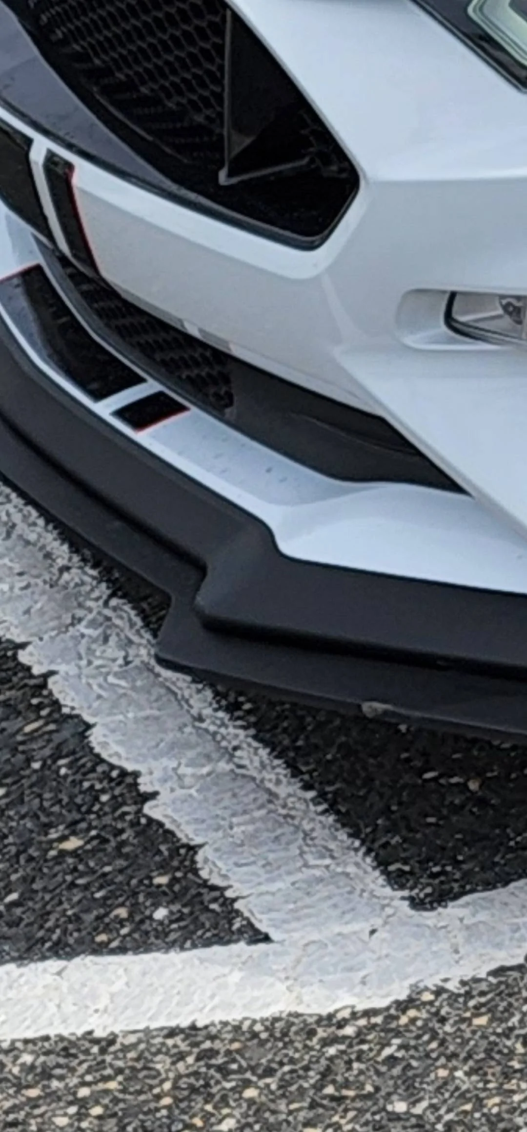

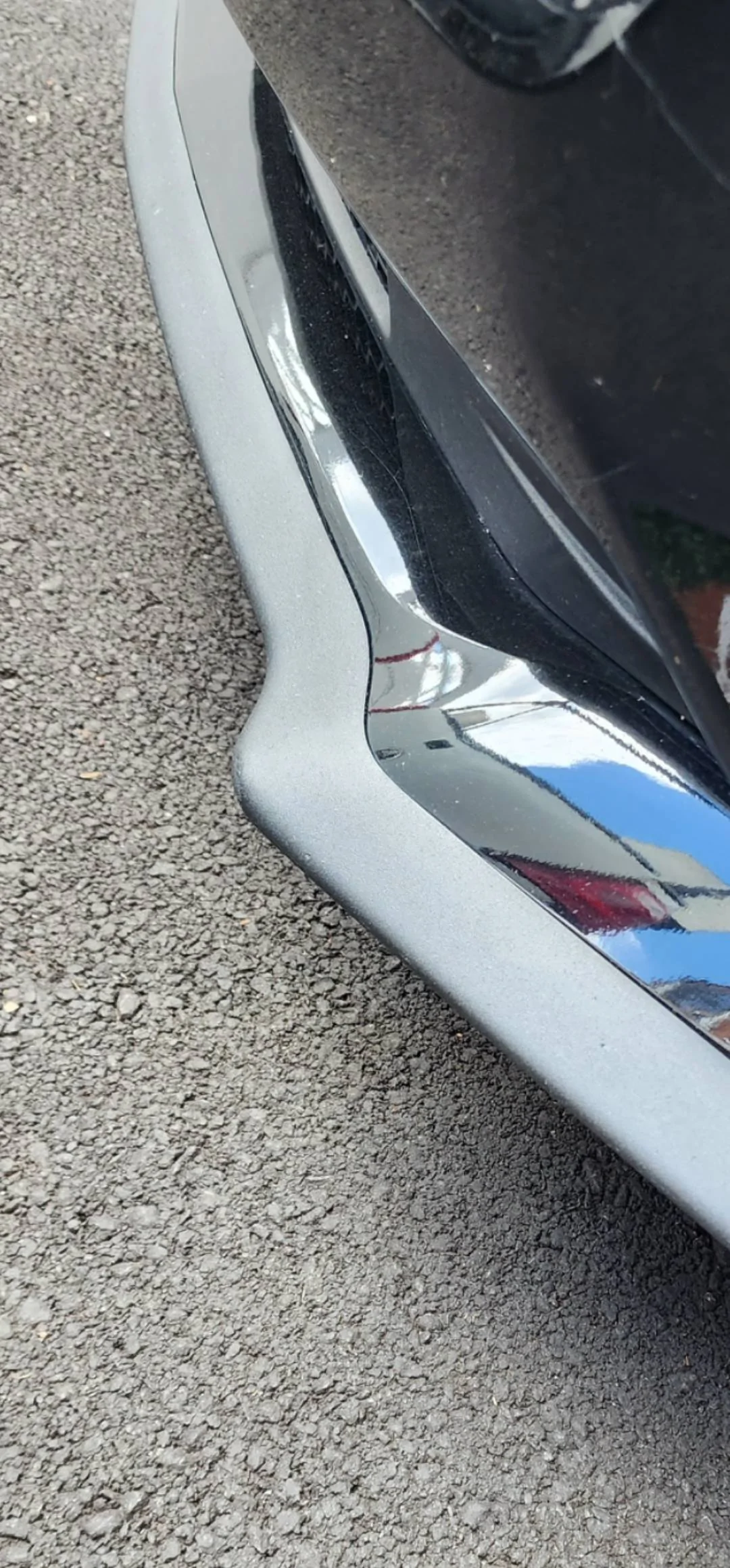

If you don't already have a PP1, the PP2 splitter won't fit. The lower bumper (the body matching color part) that rests up against the splitter is different. The white car is a PP1 with an aftermarket PP2 splitter. The black is regular GT. Close but slightly different.
