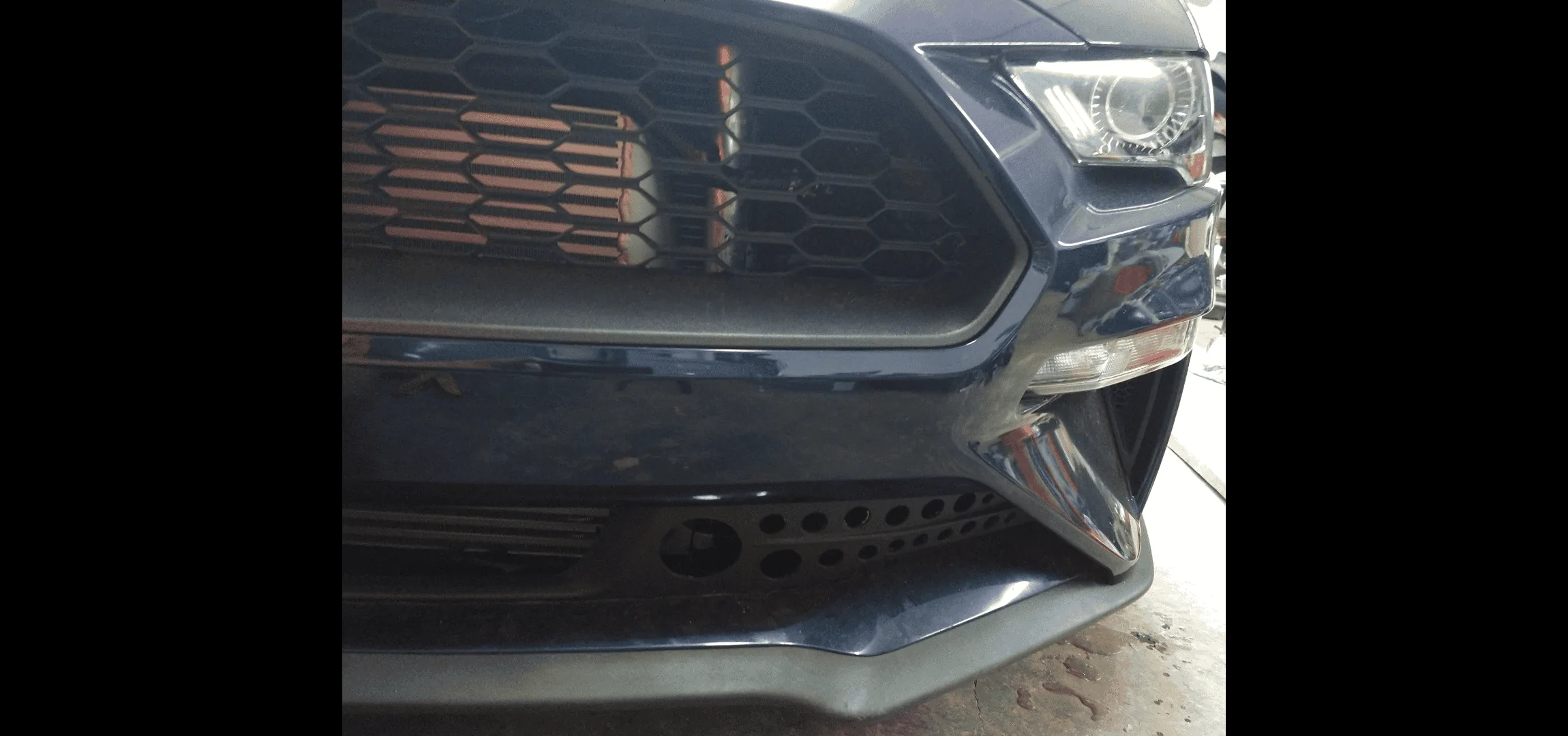

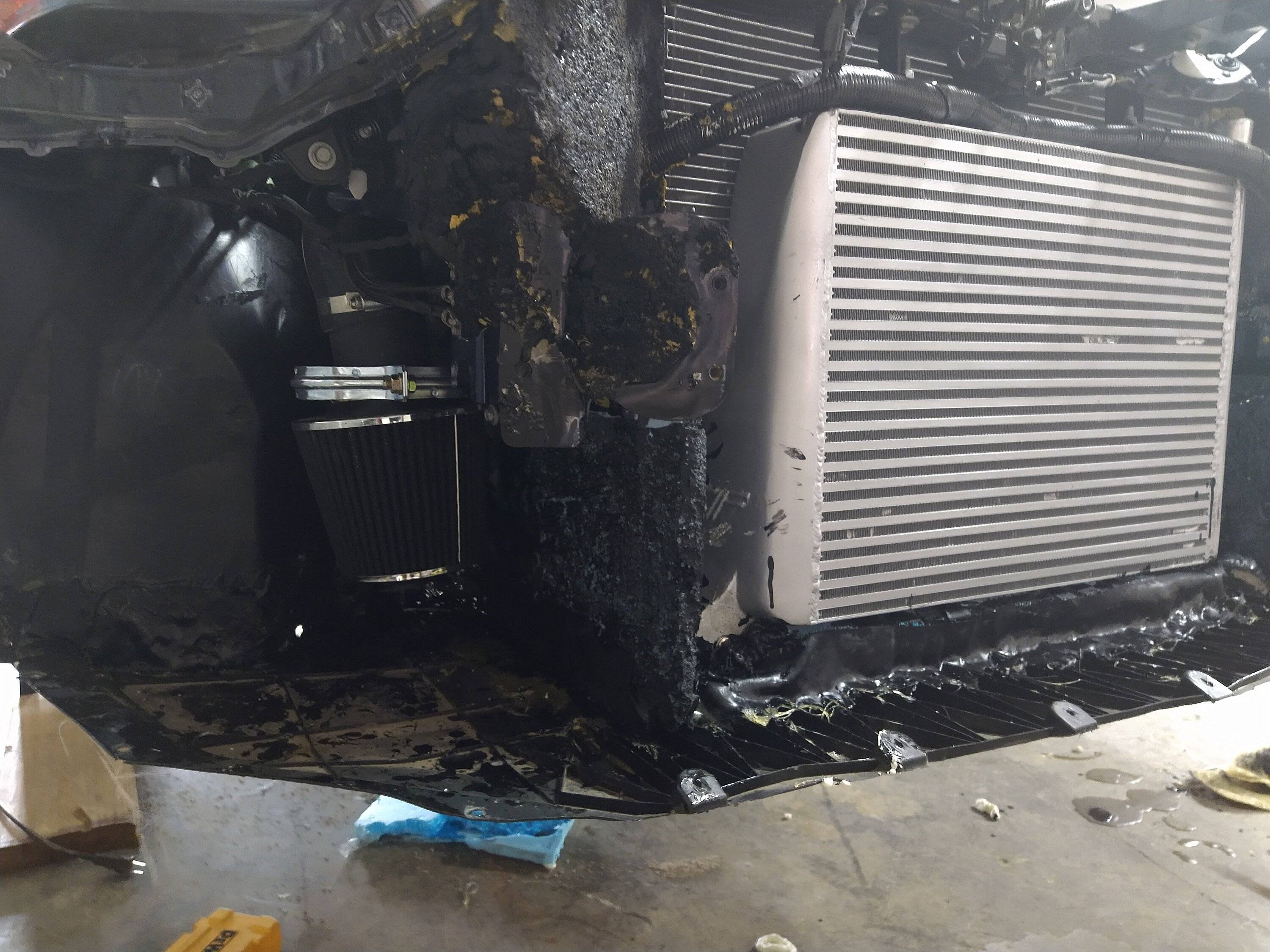

I run a non-oem air intake, primary because I want to use the area where the factory intake is located for cooling of my Intercooler, oil cooler and radiator. And it seems to work, all the temperatures I monitor are within spec at 1320 feet, where before I was heat soaking at 1000 feet and could feel my car slowing down. Now, I'm still accelerating as I pass though the traps.
I collect my intake air from the corners of my bottom grille.
