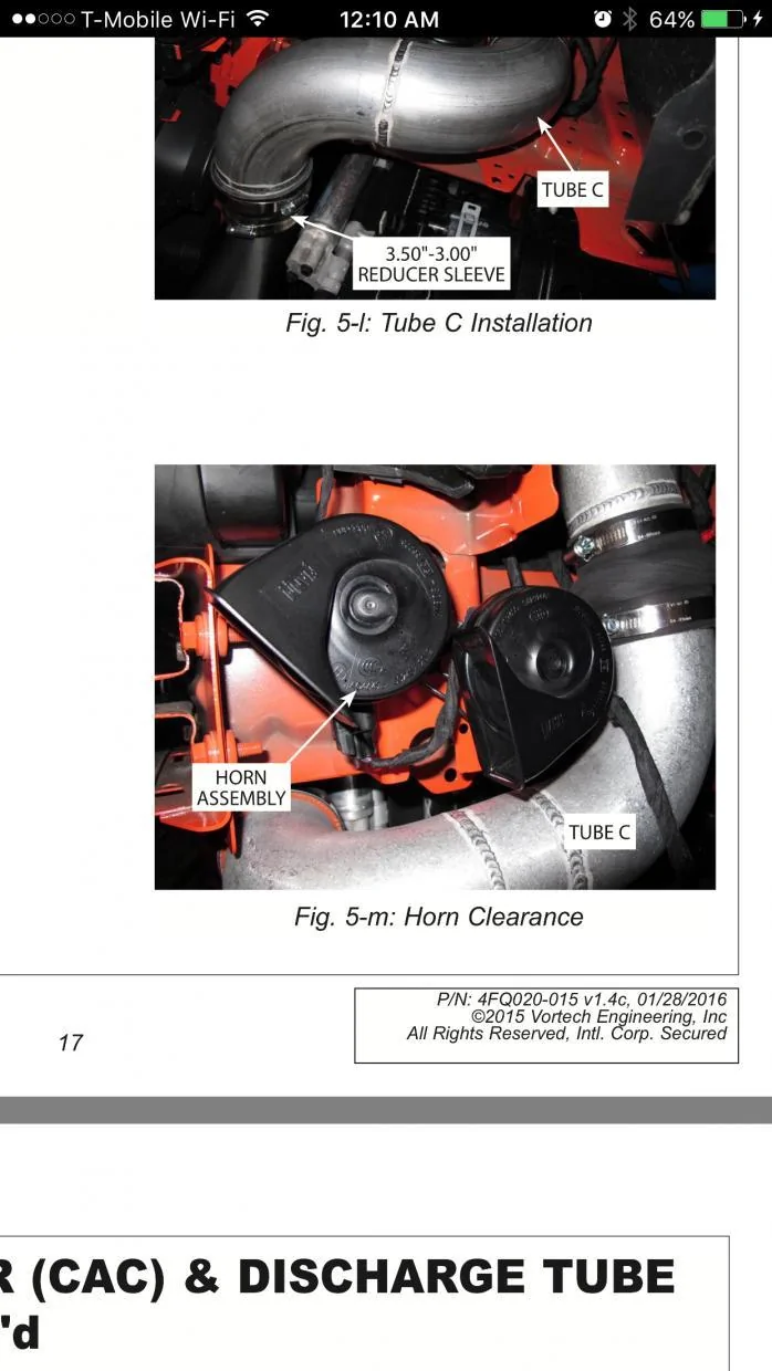

isedawishy
GTPPTT6REIGHTY
Jul 21, 2015
66
803
184
Fort Worth
2015 GT
The coupler that was in the instructions on the driver side was not the same i received in the kit, mine is Vortech though.
I ended up emailing Vortech and they attempted to send another, but sent the wrong size all together. Try emailing Paxton, maybe they can get it right.
Edit: added a pic from the manual. They show a bump style coupler, but I received a normal one that was probably 2" long.
