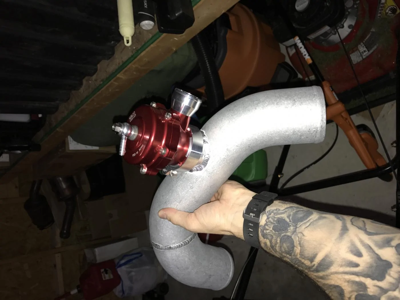

Thanks guys. I'm dealing with it for now until I get my other parts installed. I was looking at the Tial QR, and I plan on going with a smaller pulley (currently 3.8).

I have the Tial QR and it isn't loud at all while cruising like the Vortech Race Bypass one.
