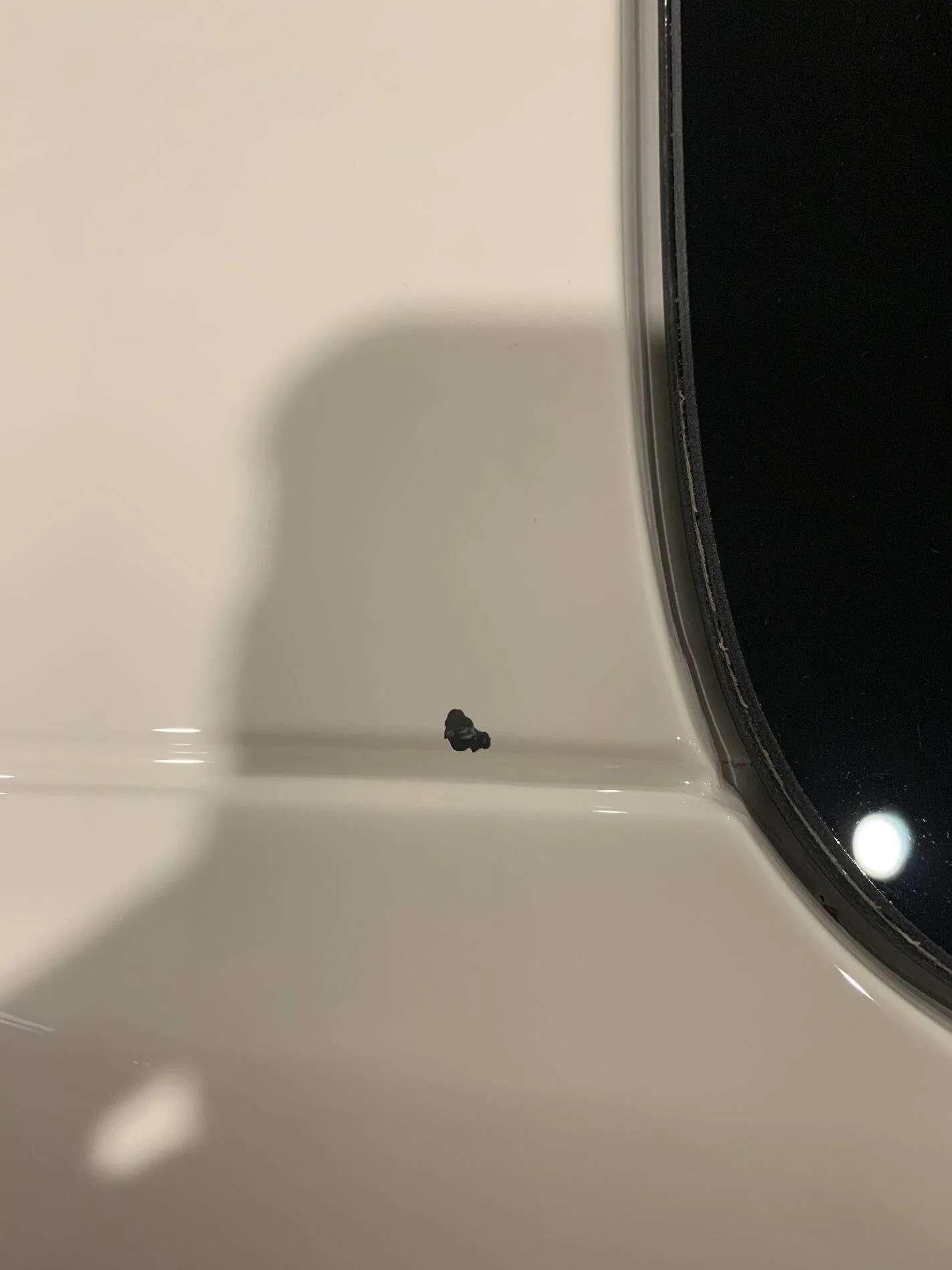

Sup,
I was driving my new GT350 home from the dealer and got a nice big rock chip on the top of my car... I’m looking into painting the whole roof black now as I wanted it as an option but it doesn’t come on the Heritage edition 350. Does anyone have any close up shots for the paint line on the OEM painted roof option? I have the paint code but want to make sure we get the line correct compared to OEM. I also don’t want to wrap, not a fan.
Thanks!

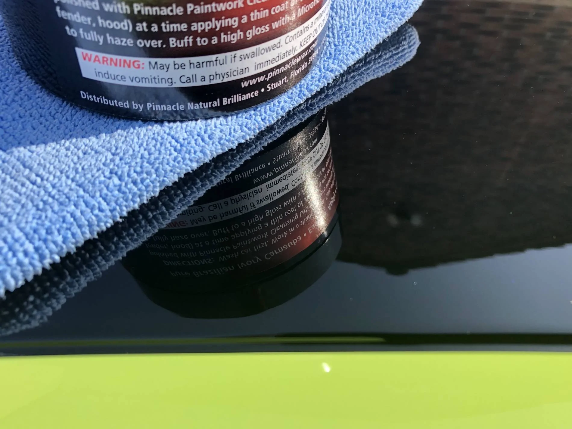

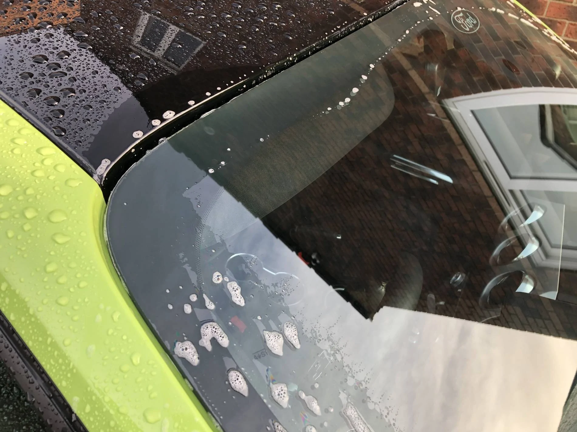

If no one comes forward I will snap a few pictures of mine in daylight for you tomorrow :like:
WD :like:
Edit : Found these in my album that may give you what you need :
The OE colour is shadow black that actually has a blue pearl in it :like:

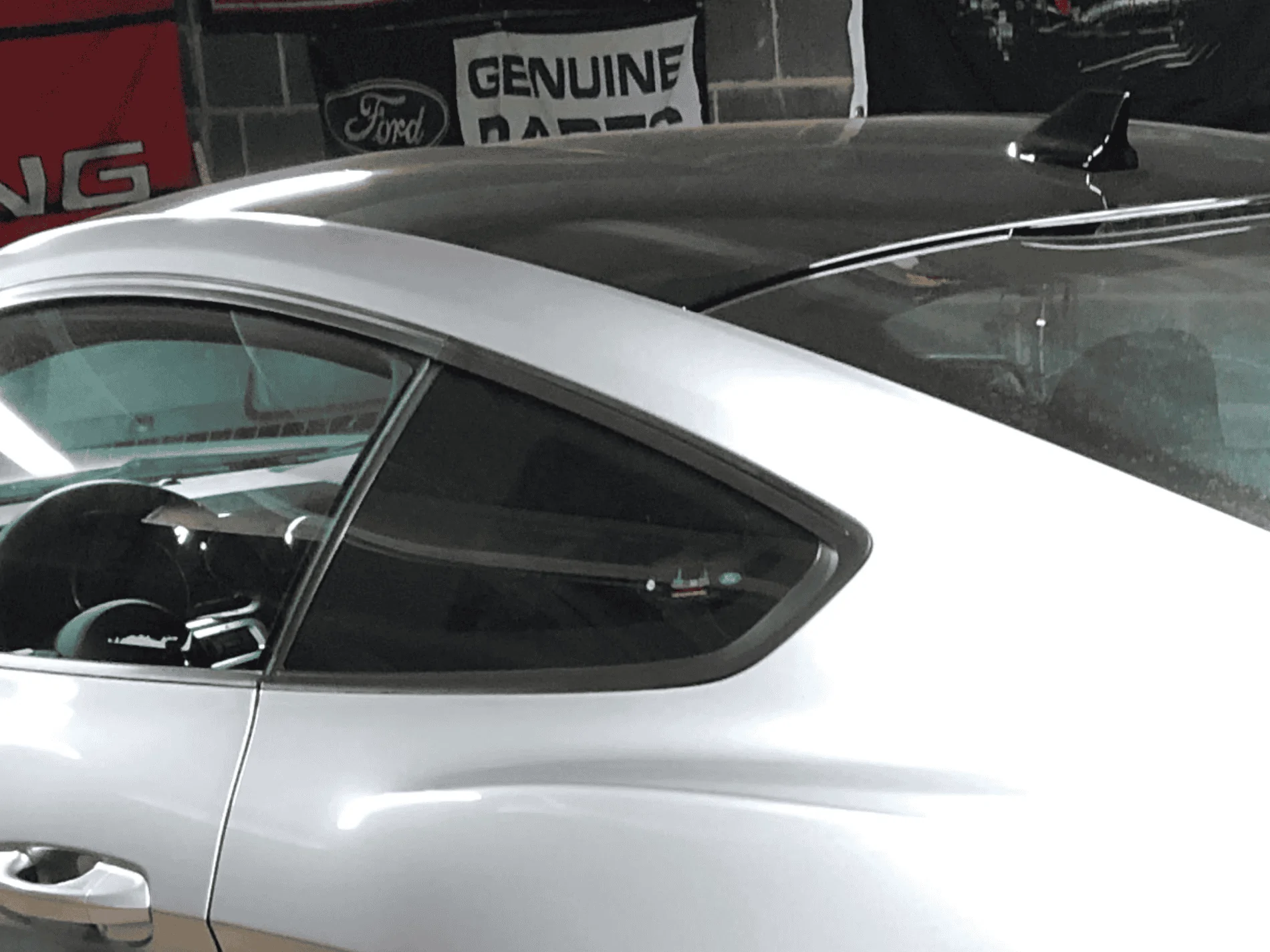

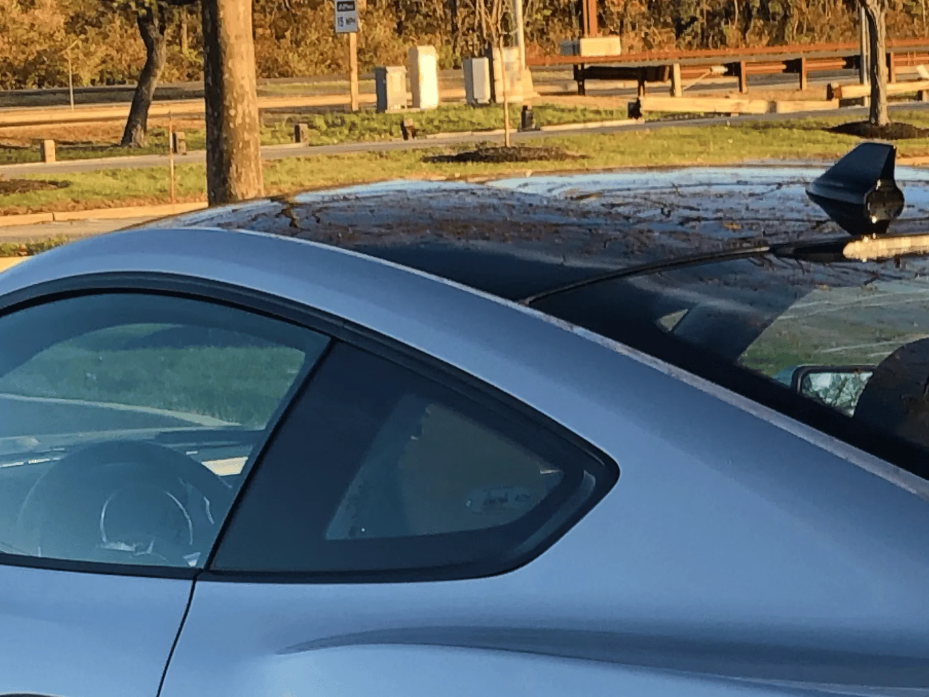

I can’t see or feel a paint line on mine, it’s down in the panel seams

Yeah the lines along the rain gutter are hidden, but if I go to the area where the line comes out of the rain gutter, down the corner and behind the front (or rear) screen, you can squeeze a finger in the gap and feel a line :like:
You can see the area I am referring to on my first photo :like:

Cobra Jet
Feb 12, 2015
771
17,615
20,077

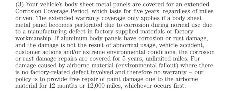

Courtesy of cheap Ford paint...
Man that sucks, I'd be livid...
But just so you know, there is a provision in the Owner's Manual for "environmental fallout" for paint issues for the first 12Mos or 12k miles (whichever comes first). Obviously being impacted by road debris is not "environmental fallout" but show your Dealer and see if they can get it covered under that provision. It's worth a try, what's the worse they do, say no?

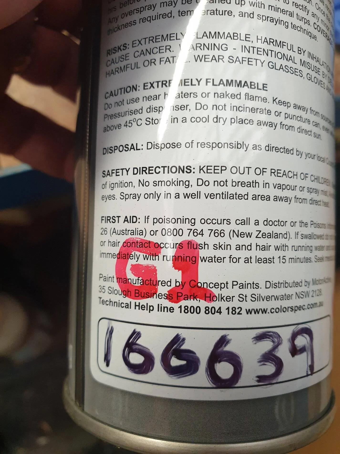

Yeah G1 is the code as per Motorcraft chart. This is also the code that was obtained from the computer when I got a spray can made up.
