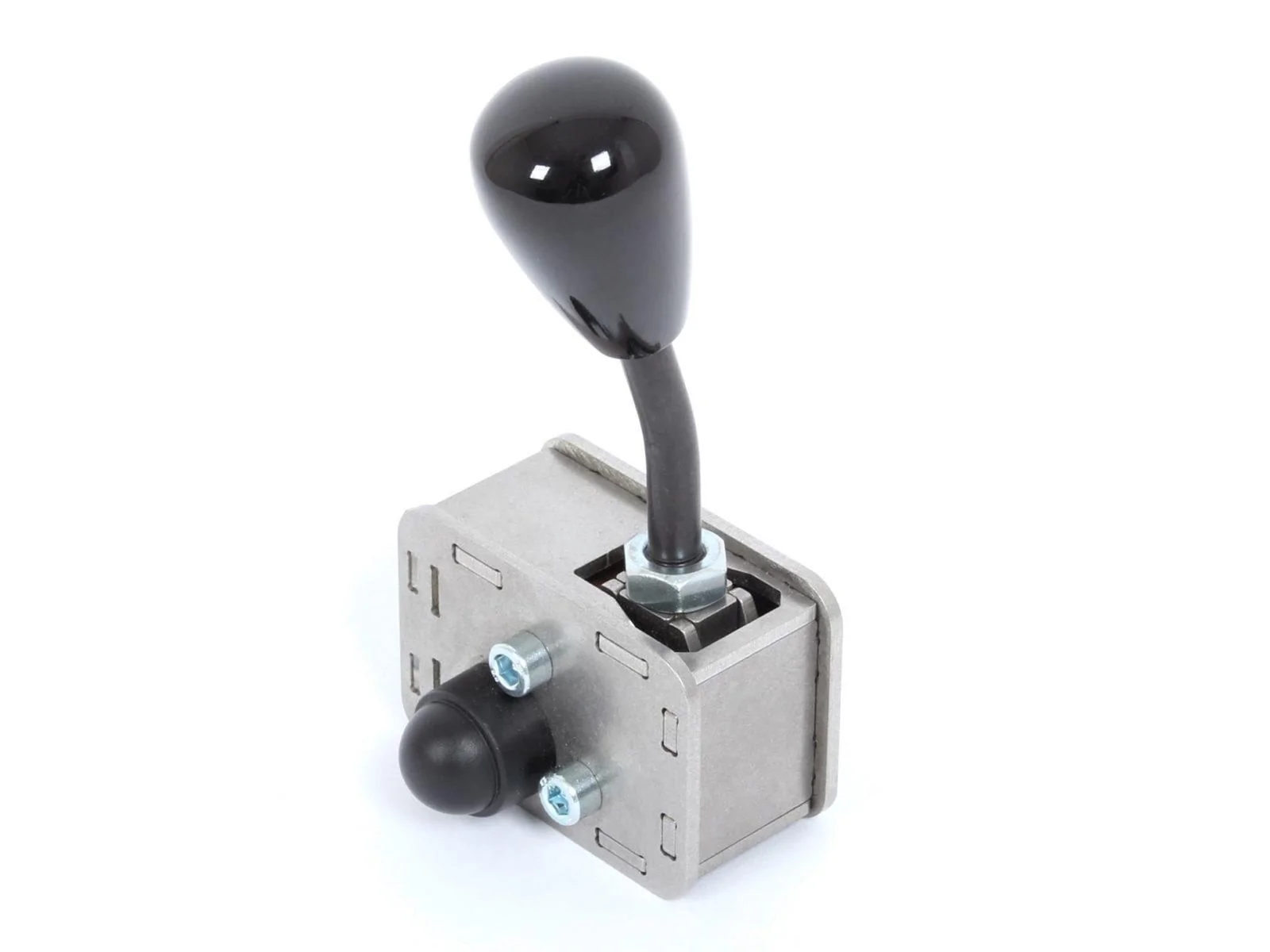

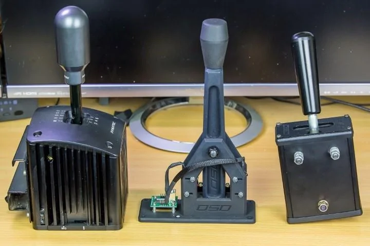

Anyone know of any other shifters available? I would prob be in on this mod if the shifter didn't look like it was taken from an arcade game. Love the idea and the work put in to make it work tho.
Once installed I personally don't feel like it looks like an arcade joystick. Part of the choice to use this one was that it could fit where I want it and it is super solid when mounted as it relies on the center console shell and has enough of a flat area in that spot to secure it properly.
I've only used the SRS of course, but can confirm it has a pretty firm resistance to it and you would not accidentally knock it by brushing up against it. The throw is pretty short and the switch is rated at 10,000,000 cycles which is likely higher than any switch used in the vehicle from the factory.
I also like that it's a bit short so it stays out of the way a little easier when taking a drink out of the cupholder or using the actual auto shifter, touch screen etc.

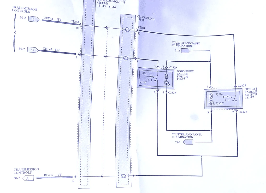

I owe all the thanks in the world to [MENTION=16528]Dspec_S550[/MENTION] for sending me the wiring diagrams and suggesting the SRS Sequential Shifter to install to accomplish this!
This mod allows you to use an actual shift knob in the way a sequential shifter setup works, with your right hand rather than on the wheel if you choose. See it in action below.

Still working on it, bought the wiring manual and have found the connections, but a hard time finding the shifter device. What was in the post is no longer available.

I will have to go back through the manual to find it there are 3 wires identified in the connector. The voltage would be whatever the system uses, I would not assume it to be 12 volts. You really need momentary dry contacts for the signal.
I will look as soon as I get a chance

Here is some wiring info for the paddle shifters. Shows the wiring, connector location and wiring identification in the connector. Hope this helps you.

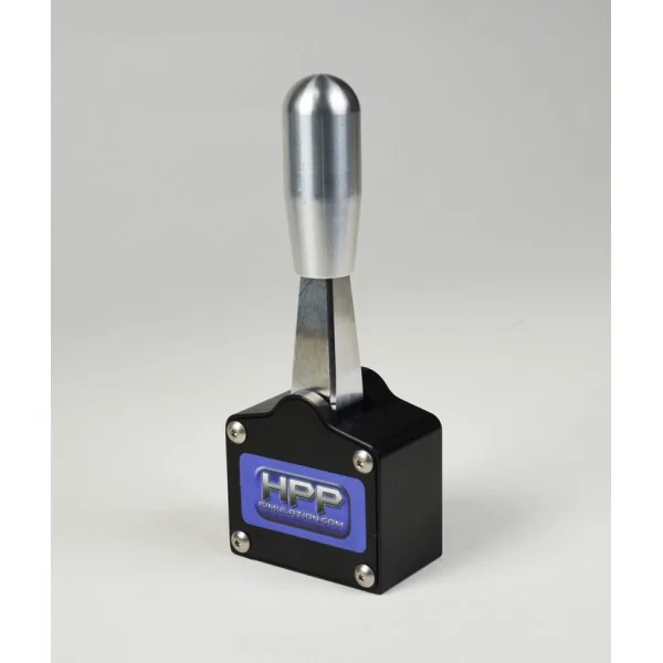

We removed the center console cover and installed the SRS using pieces (not all) of the optional mounting kit to spread out the surface area rather than 4 bolts only. We had to drill out 2 holes to allow the lock nuts at the top of the shifter to sit flush, for a flush mount.
The wiring (6ft included, perfect length) was easily run back down the console and up to the steering wheel where we tied into the paddle shifter wiring (the paddles still work, also).
The items I purchased are:
http://www.hppsimulation.com/home/33-srs-sequential-shifter.html
http://www.hppsimulation.com/home/34-srs-seq-shifter-mounting-kit.html
