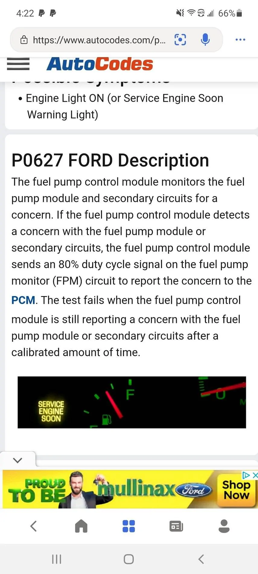

Any idea why I'm getting this code and can it effect performance? The car has a Fore Return style setup. Is this a tune issue?
I changed to bigger injectors and didn't have this code before but I did get a new tune with the bigger injectors. Wonder if he forgot to make a change?

This is the new tune for my 1700s. I reinstalled it to make sure it wasn't the issue. It almost seems like the code is stuck in the ecm. I delete it with the car running and it clears, I re check the code with my ngauge and it keeps showing up.
