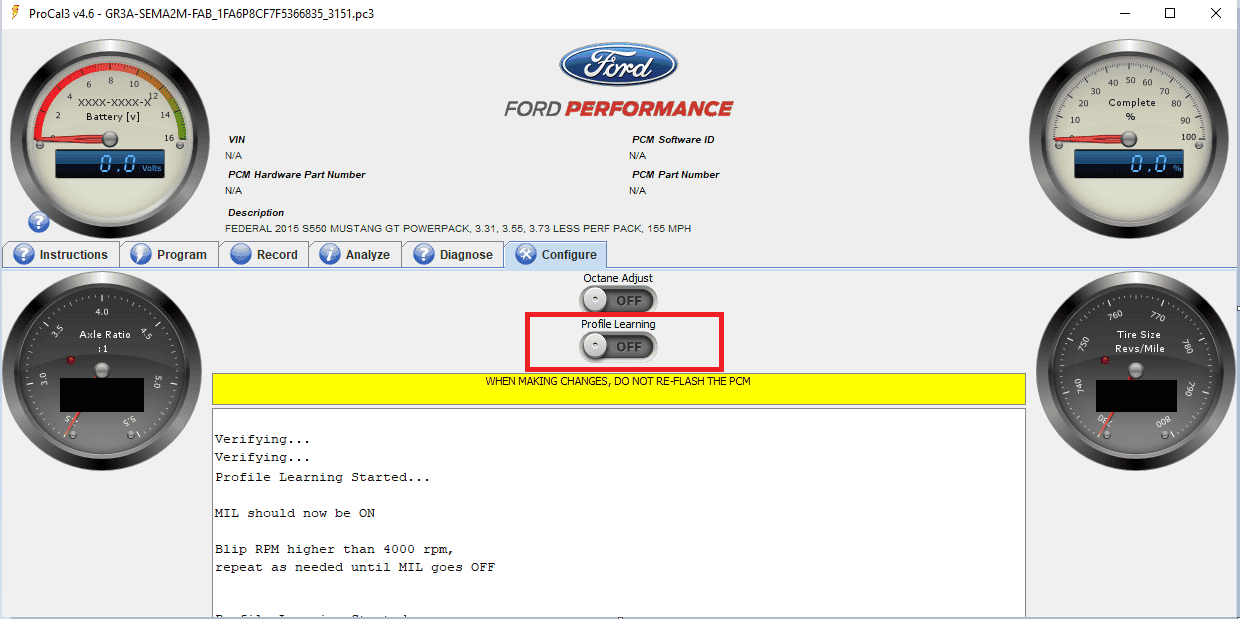

Trying to do some research and it seems with the procal connected and laptop on you just rev past 4k rpms and it's supposed to relearn and clear the CEL.
Also found these instructions, maybe one of them will work lol.

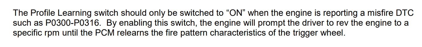

The ProCal can absolutely do the relearn.
Under Programming - go to Profile Relearn, hit enter. It will throw a CEL. Blip throttle a few times above 3k RPM until the CEL disappears. All done.

The Procal can absolutely do it. They call it 'profile relearn' and it's under the configuration tab of the software. The instructions say the below and it's on the last page. I'm also attaching a PDF of the instructions.

@J17GT thanks a lot! I made it, and cleared the P0315 code.
