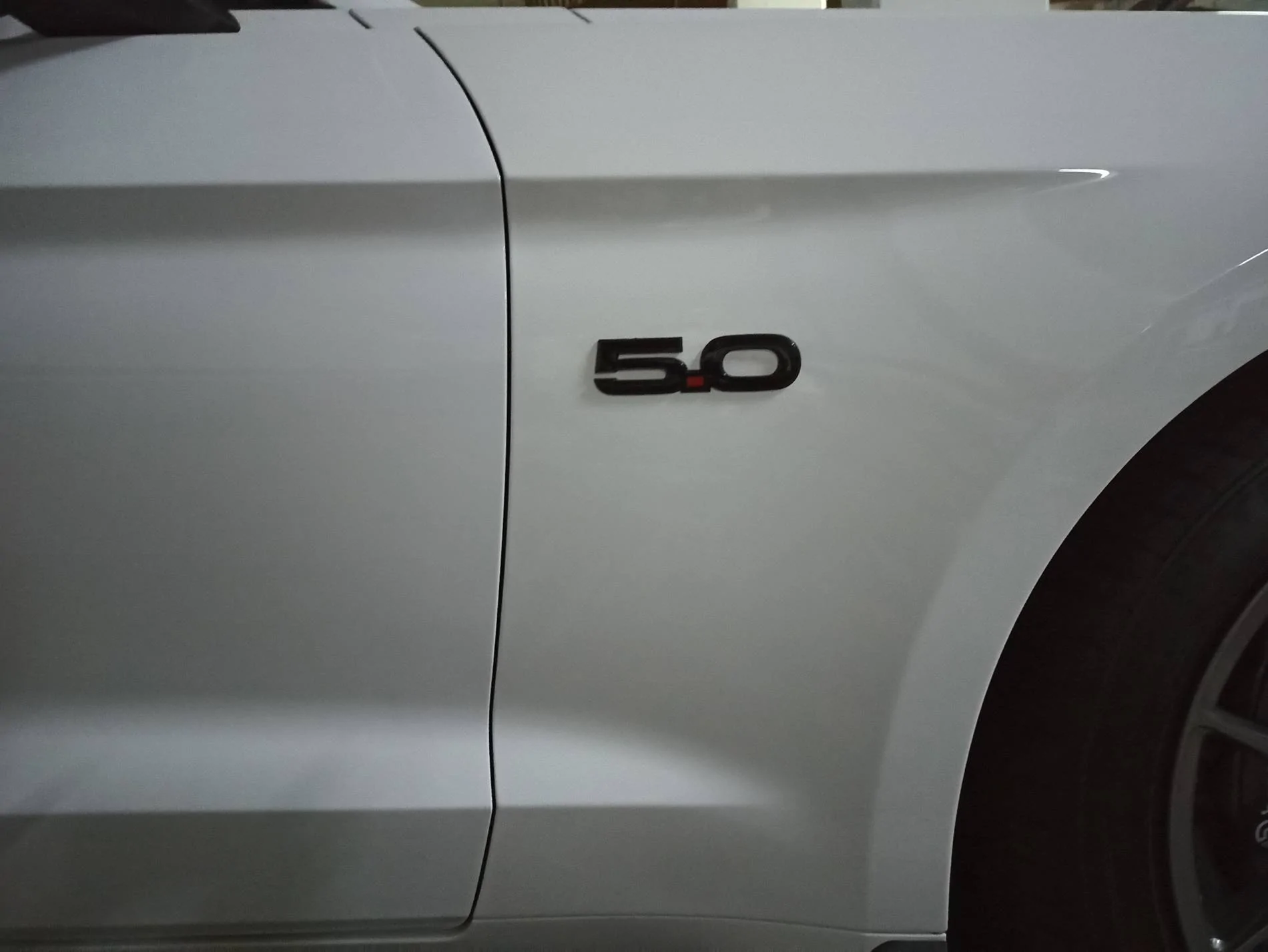

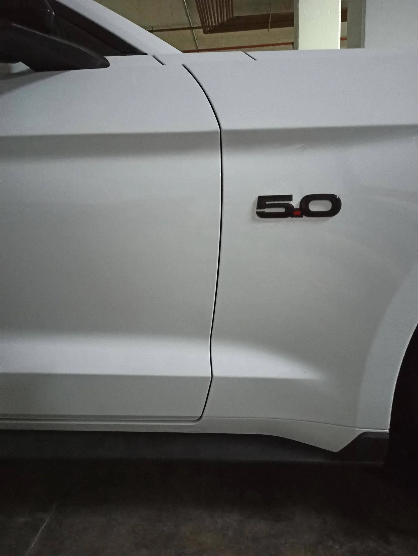

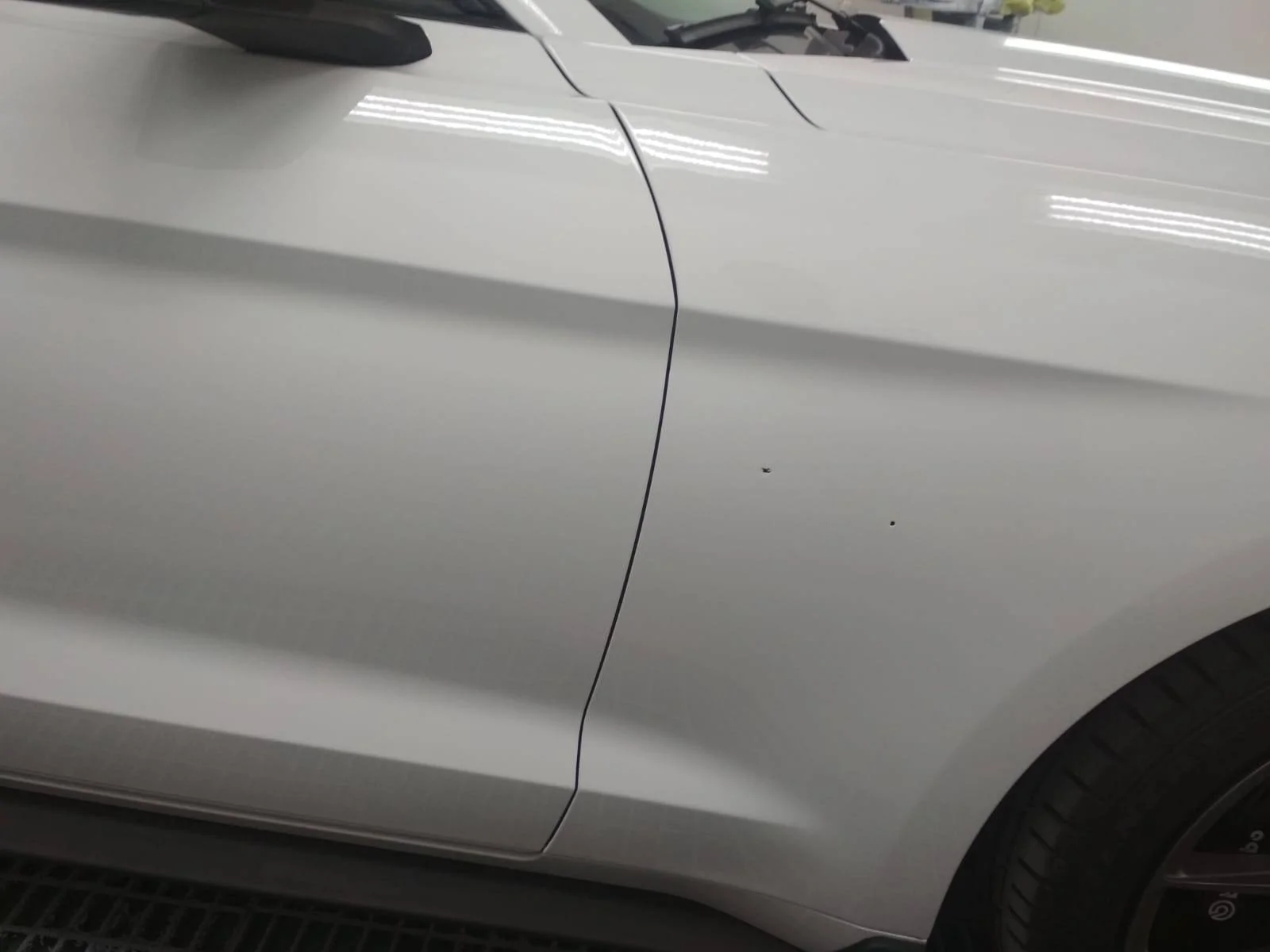

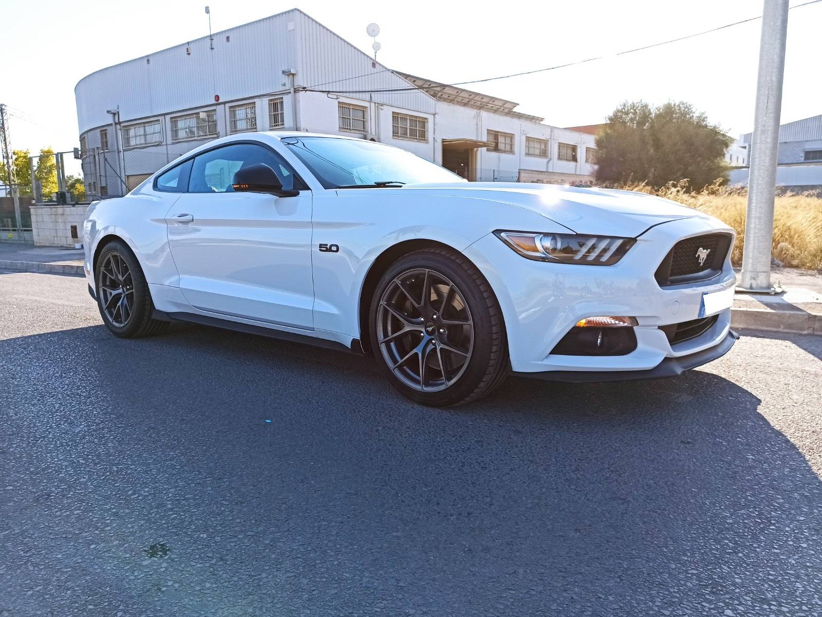

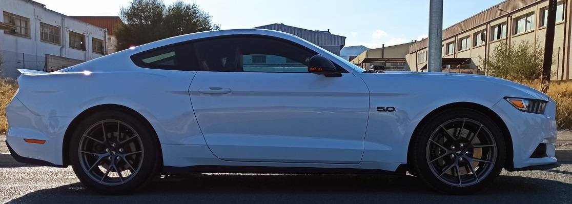

I´ve had to make paint the right front quarter panel of my mustang to a bodyshop. When I picked it up after the work, it seemed to be flawlesly.
But when I look with more detail with the fluorescent light of the garage, I can see that the paint does not match with the door. It´s like a bit more yellowish.
Told him this issue and he said to me to let the panel exposed in the sun light (in my case is not so easy, it´s a weekend warrior) and let it "cure" about a month. When I´m writing this and attach the pictures it has passed 2 weeks.
I have to say that the car was polished and treated with ceramic coating, with Gyeon. So this panel is not treated yet. I have to do it, but I don´t want to make it so early to get the paint cure.
So my questions are:
Do you think as time passes the paint will match better? Or that´s bullsh*t?
Do you think after 30 days if I apply Gyeon ceramic treatment the result will improve and match better without redo the painting?
Or do you think I have to visit the bodyshop again to redo the work? I´m not sure this is the best it can be done considering the colour, and my fear is if it will get worse in another attemp.
This is the worst look with electric light:
This is the look with flash light:
And this is with indirect sunlight best of all, cannot be detected.

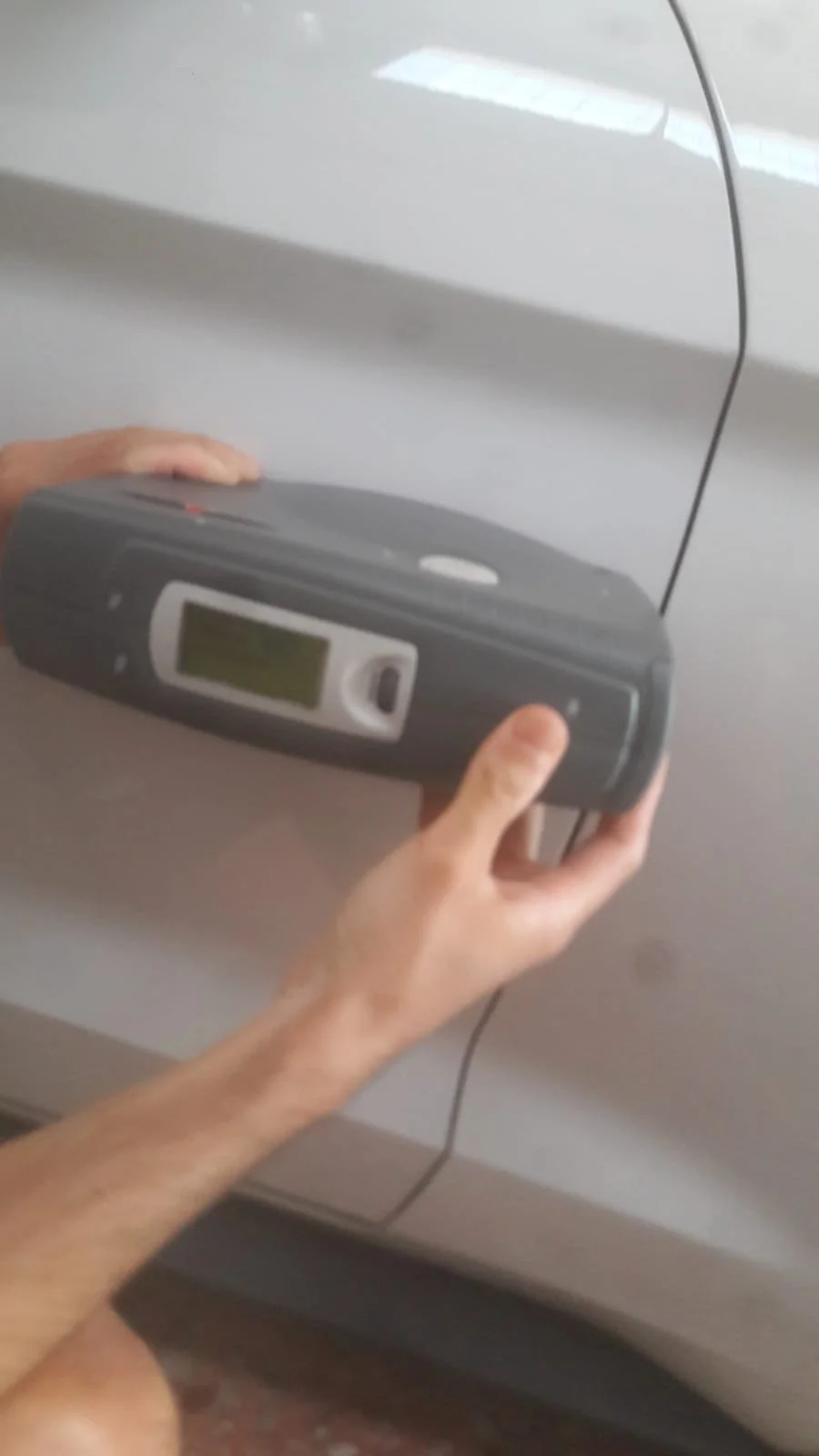

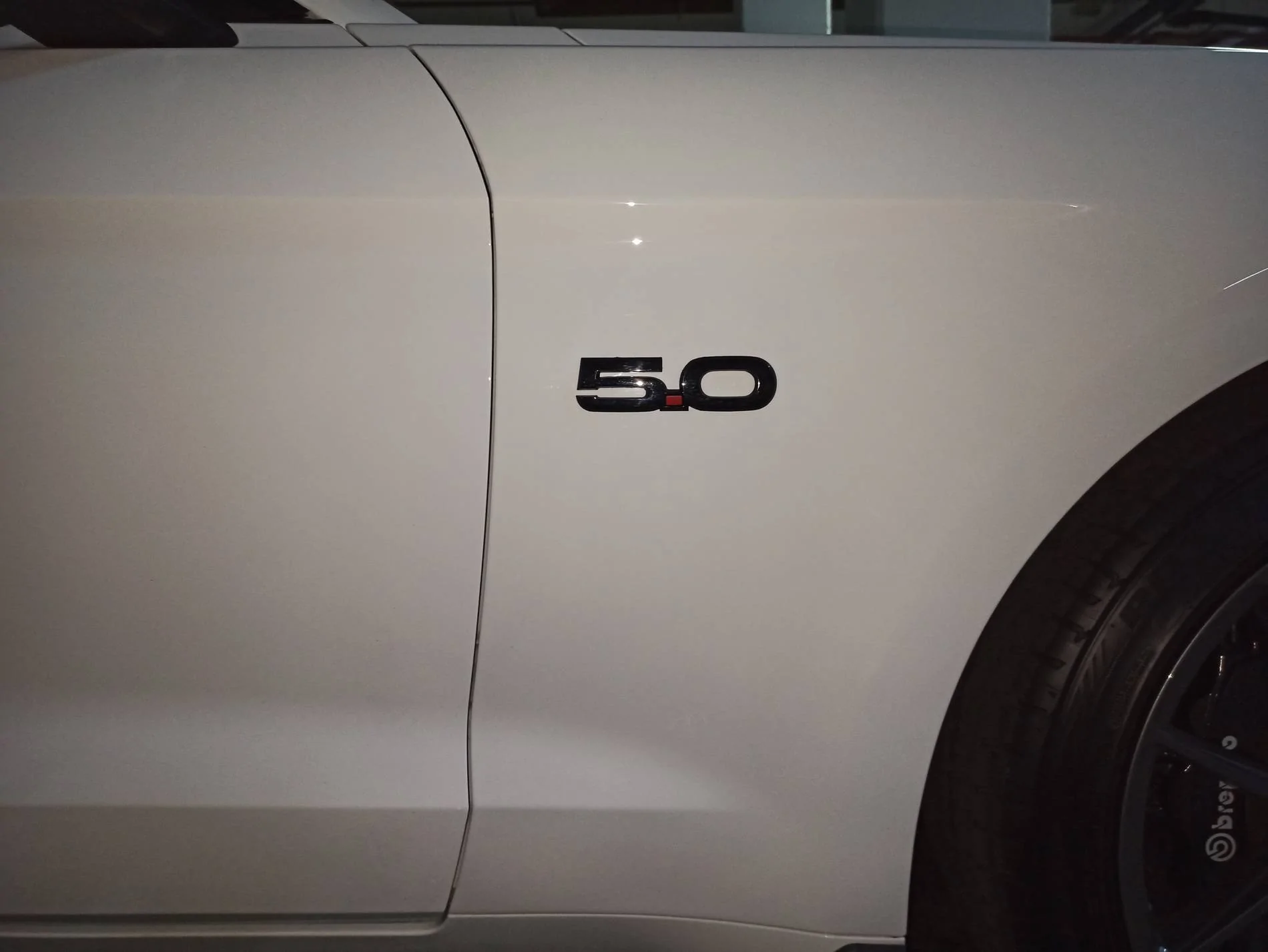

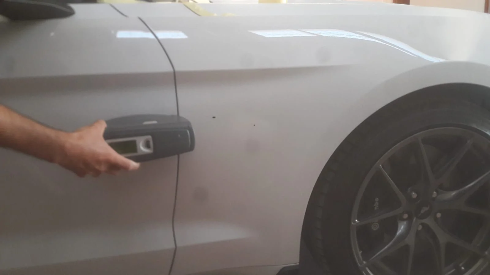

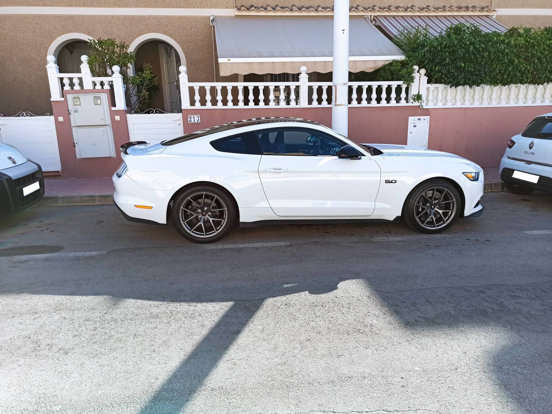

Well, after more than a month, I had an appointment with the body shop to repaint. This time, I left the car more time to make the plate tests they needed. R-M technichian came to the place to make a succesfull result. They analyzed the colour of the door, get the replica on the formula, and they found out that the resin of the bi- component paint was not in optimal conditions, maybe that can was in a not apropiated environment stored.
Well, after the resin replacement, I think this result is much better now. No blending applied to the door. I know it´s impossible to match a white colour from 2 different parts, but I cannot appreciate the difference.
I´ve used the same place and light to compare the difference. I think it´s now better.
Before:
Now:
Even in shadow I cannot apprecite difference.
