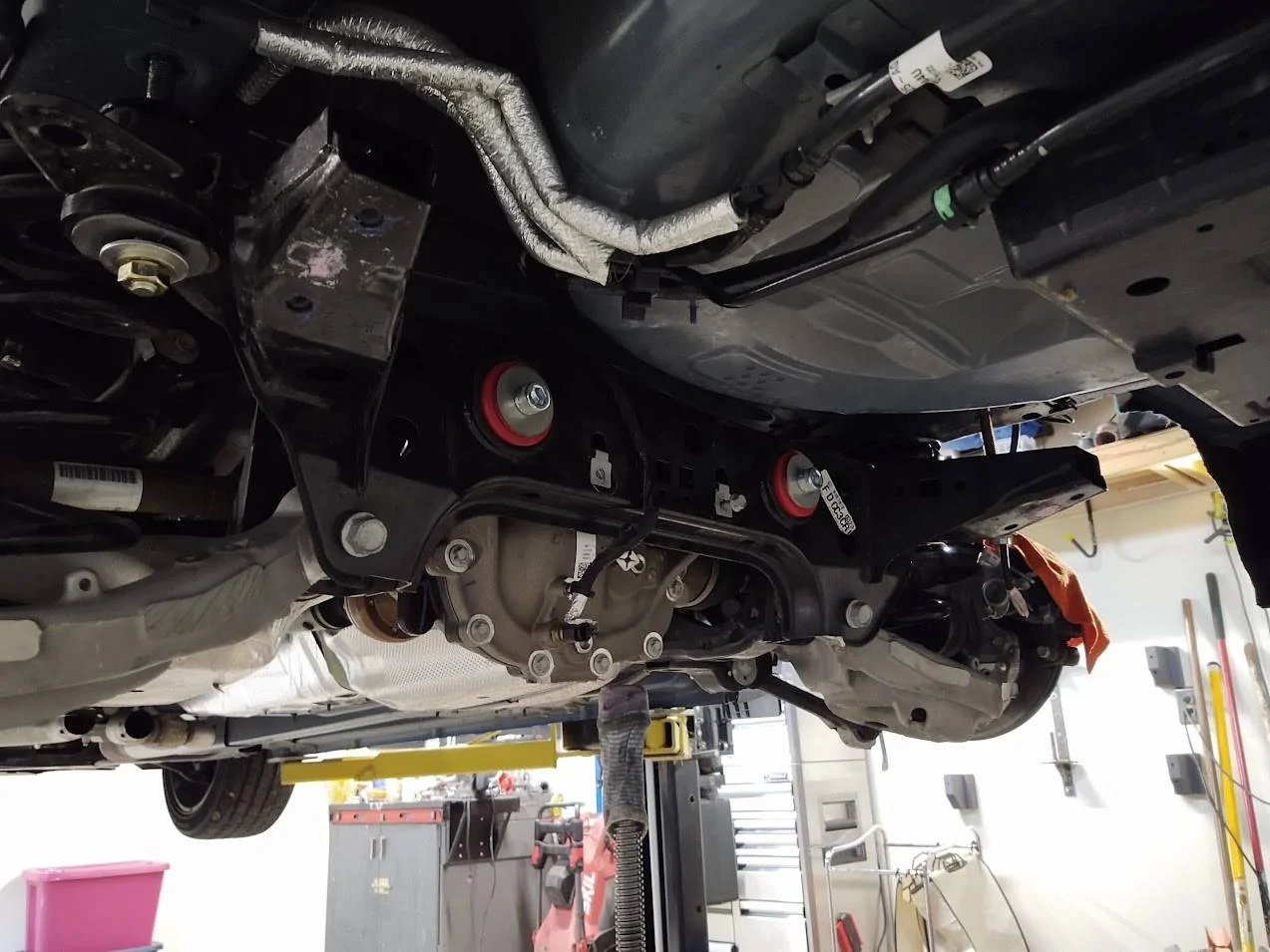

these mother flippers are some BIG bertha. i got tired of waiting on ford to fix the torn diff bushing so i'm installing half of this big bertha kit with these inserts. i may get some more NVH but these suckers ain't going anywhere. UPDATE: the only additional noise is when putting the car into gear since the diff is now very solidly mounted.
I did NOT do the front bushings as they were unnecessary to achieve my goals of merely limiting the diff rotation side to side.
was able to drill the threads out with the IRS in the car BTW.
I couldn't find that info anywhere so i thought i'd share.

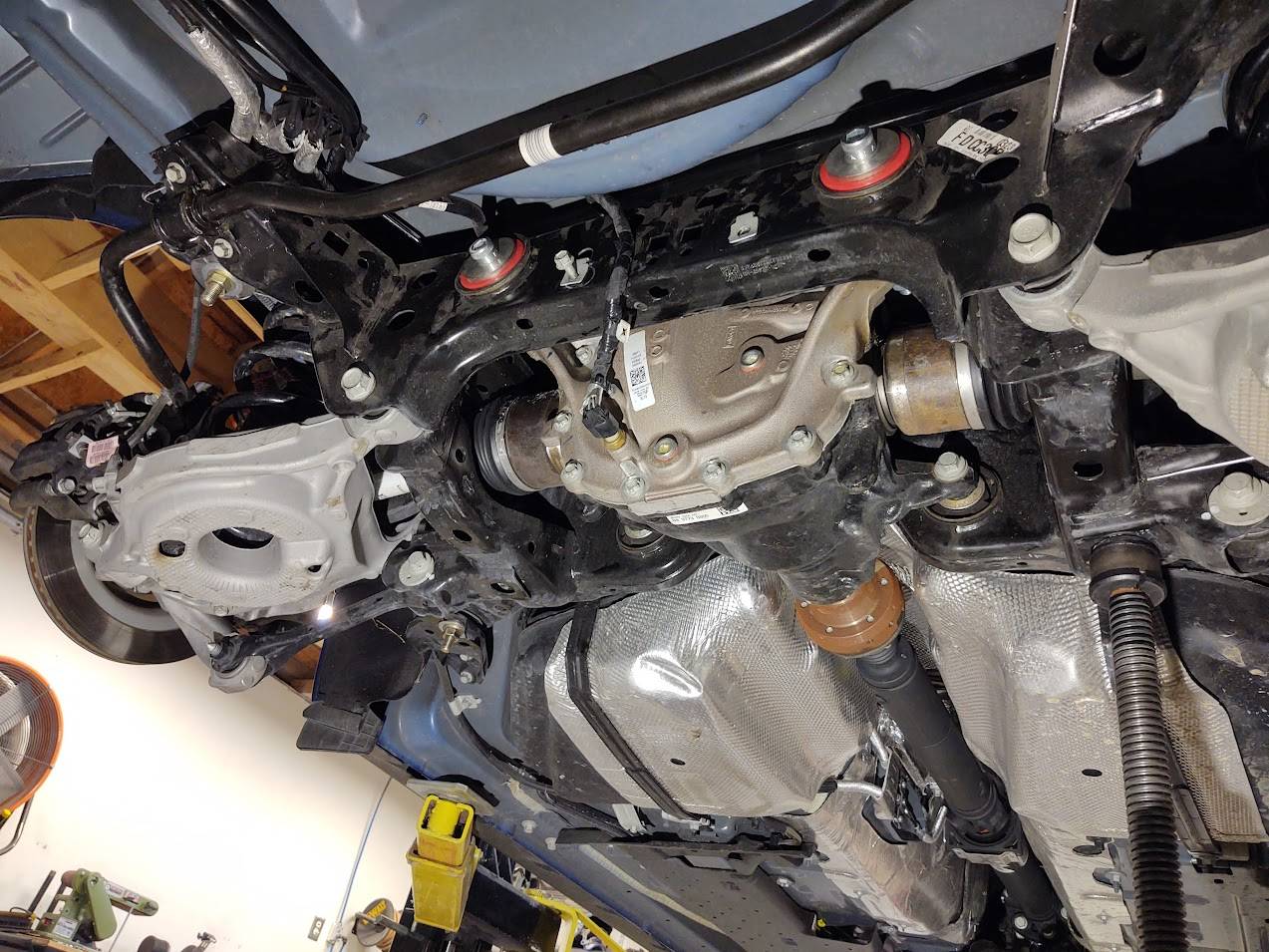

so you can install the back ones in the car for sure. it sucks but its doable. I'm not doing the fronts for 2 reasons.
1. the rear drivers side was the torn thing that needed to be helped out
2. the fronts carry the snout of the pumpkin which houses the pinion gear which is where a lot of nvh comes from.
I'm hoping that by fixing the rears the pumpkin will no longer twist laterally, thus preserving the rest of the bushings, but it can pivot vertically a little with the stock front bushings absorbing as much nvh as possible.

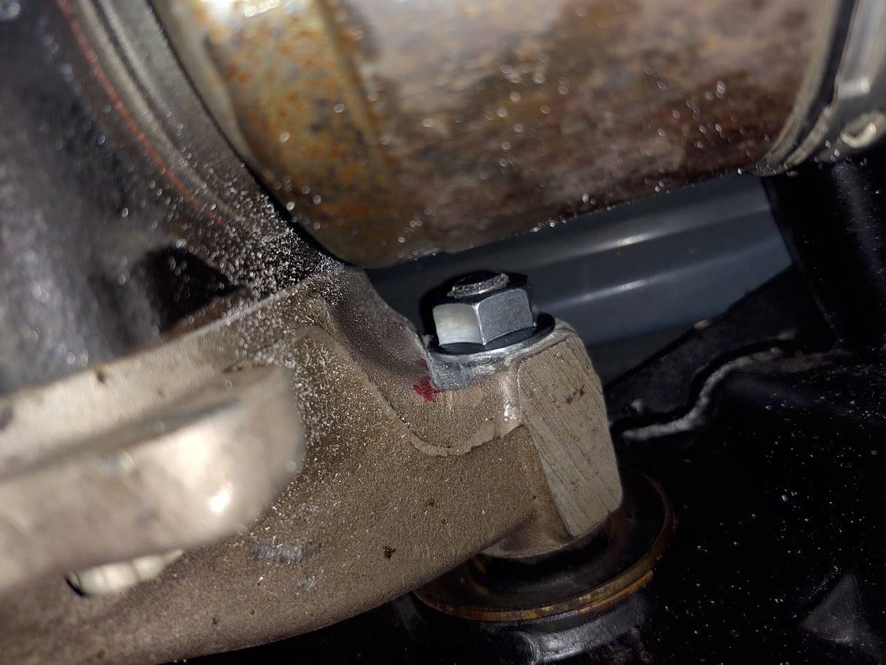

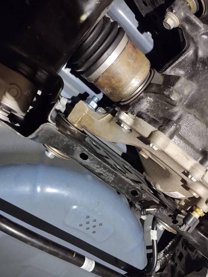

anyhow this is what they look like installed. I couldn't find any pics of how much you have to hog out to make the nuts fit so I thought i'd share.
also, i did only what is necessary so this is the minimum you'd need to remove from the front side of the diff cover ears.
driver's side before loctite and torquing down.
