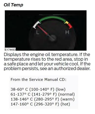

I went to MSR Houston last weekend for a track day and 15-20min into each session the oil temps (per the gauge in the cluster) were just shy of the yellow hash mark.
With ambient temps in the high 70s to low 80s I never thought the oil temps would rise so quickly. In my other turbo charged car oil temps barely rose above "normal" operating temp.
Is the oil cooling an issue on these cars?
