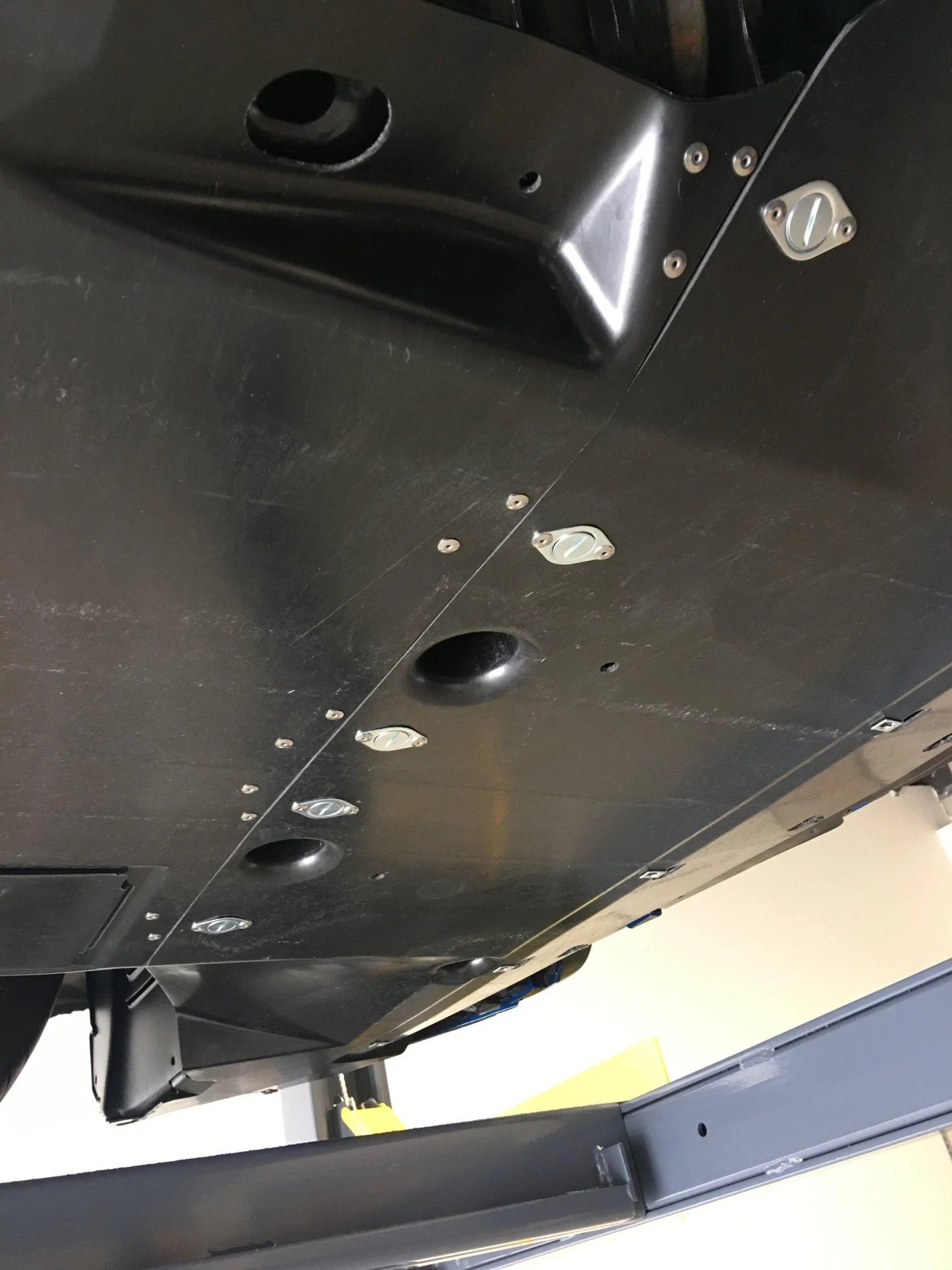

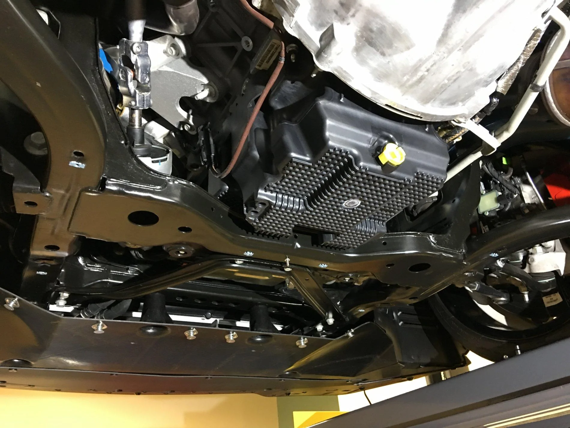

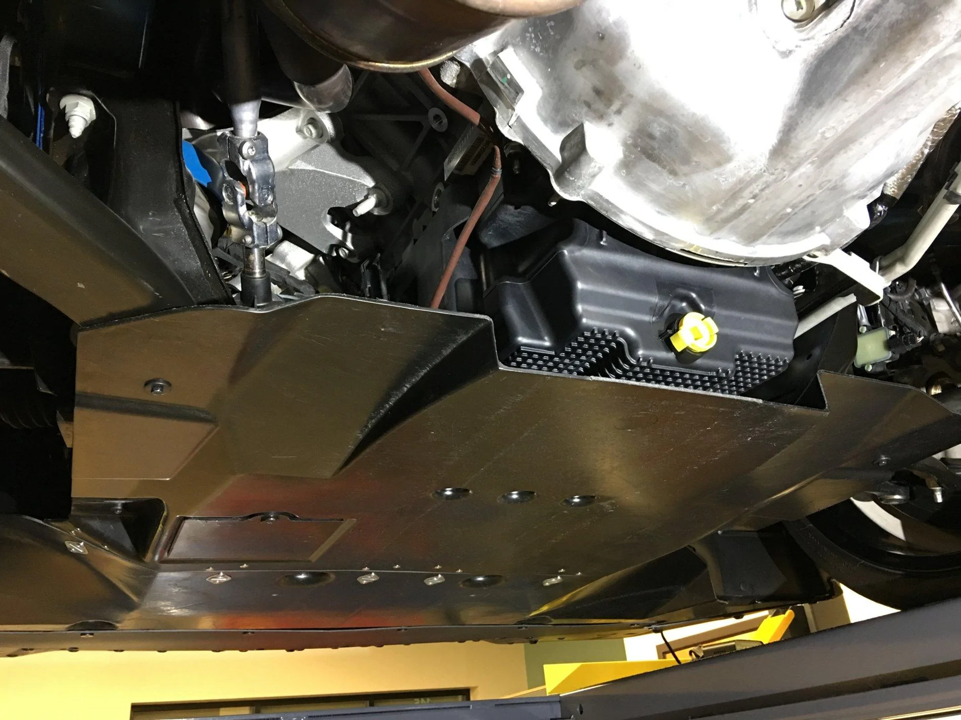

Installed this mod on my 2017 GT-350R. It splits the belly pan in 2 pcs, allows for complete oil filter access, oil pressure sending unit inspection in just a few minutes. Raced-car grade Dzus lock it back together, rock solid.
No more working through a tiny hatch just to change oil.
What do you guys think?

Thanks! I'd like to take full credit, but this was a kit from S&S Engineering.
I don't know how I put up with that stupid access hatch for so long. What a PITA to change the oil.. always a mess no matter how careful you are.

So was that just for the Dzus fittings, or did they retrofit and provide a new belly pan? I can't really tell exactly what was changed from your pictures (and TBH, I've never been under a GT350).

It's the Dzus, brackets, full hardware, Uni-Bit, drills, full instructions. You follow the guide where to cut the pan ( like butter) and install the hardware. Easy day.
