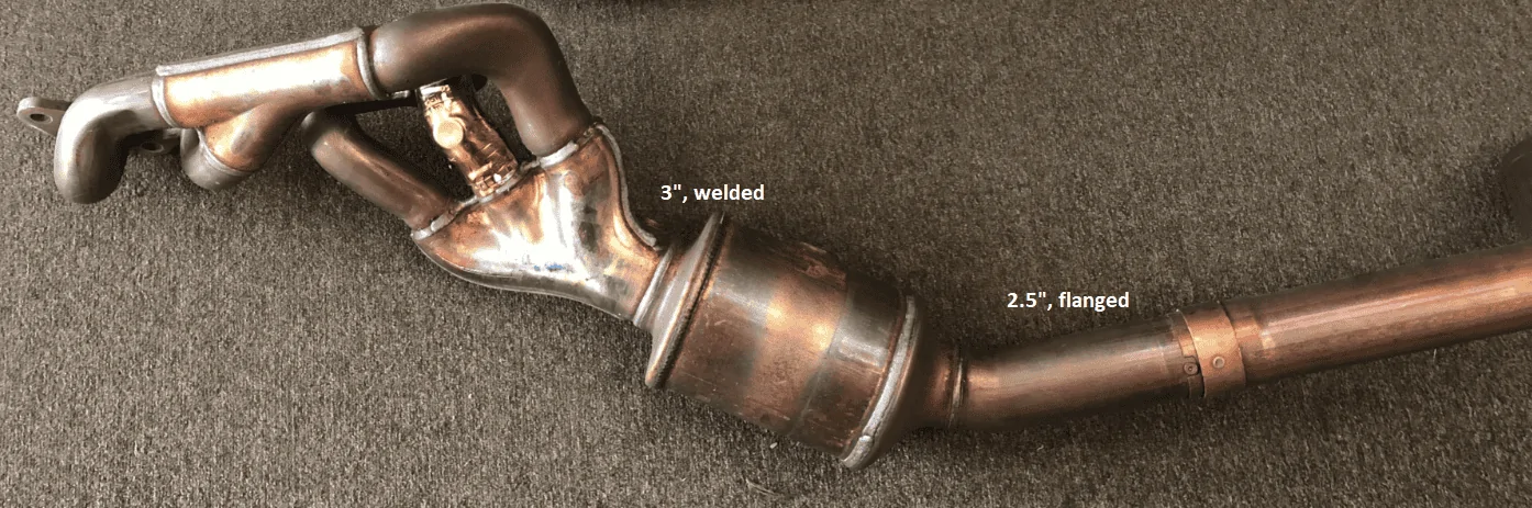

I'm planning some custom exhaust work in the next few weeks. Anyone know the flange size for the OEM header collector to cat size?

Driver's side manifold is welded to the cat, you'd have to cut it (ala MAK Cat Deletes) and weld a flange in. Based on the pictures below, I'd say a 3 inch Vibrant 2-Bolt Flange would be appropriate. Read the MAK instructions at the link below and it will give you more info as the cat inlet is not perfectly round and may need some hammering to round it out after cutting. The lower pipe after the cats is definitely 2.5" fyi. Necks down to a bit less than 2.25" at the resonator inlet and back up to 2.5" after the resonator on both sides. The passenger side is flanged between the manifold and cat and also at the resonator inlet so that side is removeable.
